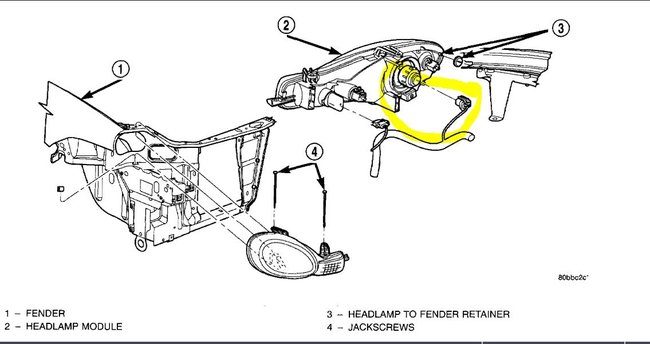

Low beam left headlight not working. Everything thing else works.
Monday, June 24th, 2019 AT 10:57 PM
13 Replies
  • 52,797 POSTS

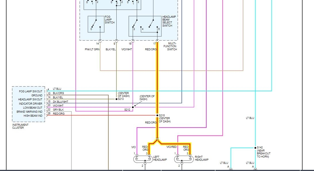

Good morning,
Did you test for power to the headlight with a voltmeter or test light?
Did you replace the headlight bulb?
https://www.2carpros.com/articles/how-to-replace-a-headlight-bulb
I attached a wiring diagram for you to view.
REMOVAL
1. Release hood latch and open hood.
2. Remove screws attaching headlamp module to upper crossmember.
3. Remove headlamp module from vehicle.
4. Disconnect wire connector from back of headlamp bulb.
5. Rotate retaining ring counterclockwise one quarter turn.
6. Remove retaining ring from headlamp module.
Headlamp Bulb
7. Remove bulb from headlamp module.
INSTALLATION
CAUTION: Do not touch the glass of halogen bulbs with fingers or other possibly oily surface, reduced bulb life will result.
1. Install bulb into headlamp module.
2. Install retaining ring to headlamp module.
3. Rotate retaining ring clockwise one quarter turn.
4. Connect wire connector to the back of headlamp bulb.
5. Place headlamp module in position.
6. Install screws attaching headlamp module to upper crossmember.
7. Close hood.

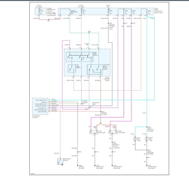

Hi! Glad I found you!
I just bought a 96 Neon and the guy told me the high beams were stuck on and that it needed a relay switch. I had to pull the fuze out to turn the lights off and put in to turn on as they are not working with the light (pully handle) switch inside.
Now, there are no headlights at all but the orange lights and dash lights work when the fuze is put in (if I leave it in it will drain the battery)
I have been told that I have power to all areas and that my headlights may be burnt out. Thats fine and I have bought new ones but why would the bright lights be stuck on and not be controllable from the inside switch? If you can help it would be GREATLY appreciated. Pls email answer!

Hi
Think you need a new headlight switch/multifunction must have stuck on possible contacts fused. Also need to know if car has Daylight running lights
Let me know
Thanks for donate
Wednesday, June 26th, 2019 AT 10:05 AM (Merged)
SARAH3383
Hi and Thank you for the response. No, I do not have daytime running lights. I have no low beams, its stuck on high beams only. I am having the bulbs replace right now to see if I can at least get high beams back with fuze in.

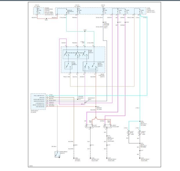

I have a 1995 Plymouth neon with 149,000 miles and I recently had a problem by my car not starting and there was a burning smell inside. We replaced my fuel filter and it runs, but now my headlights won't turn on. I replaced them in March and I put new fuses in the panel. My parking lights come on and my turn signals work, but my headlights won't come on. My owners manual is a piece of junk and it doesn't offer anything. I am by myself and can't pay a mechanic so I do all my work myself. PLEASE HELP! :X
JDL
  • 16,098 POSTS
Sorry for the late reply.
If that smell is electrical, I'd definitely have to check under your dash for any melted wiring, around the fuse box--headlamp switch--everywhere. That could start a fire.
Next check the wiring circuit from head lamp switch. You could check voltage and ground at the head lamp connector.
In the diagram, you can see the head lamp fuse, red wire carries voltage to headlamp switch, when switch is turned on, the green wire carries voltage to dimmer switch. I'd have to check those circuits. Go from there

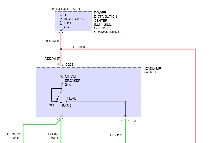

Electrical problem
2001 Dodge Neon 4 cyl Two Wheel Drive Automatic
panel lights and low beam lights not working
BLUELIGHTNIN6
  • 16,542 POSTS
Inspect fuses, if OK suspect faulty headlamp switch.
