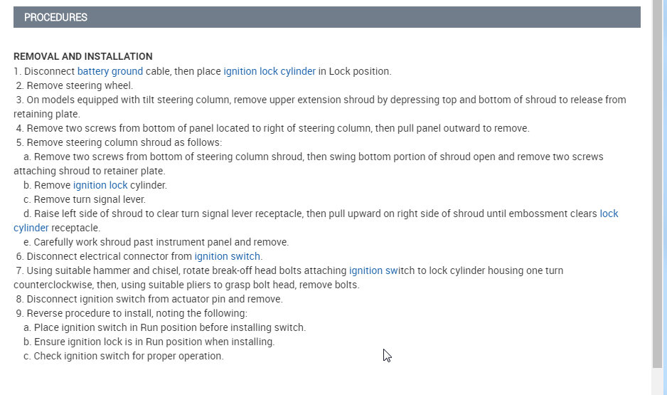

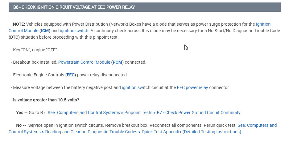

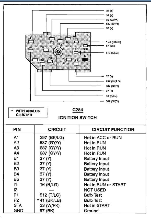

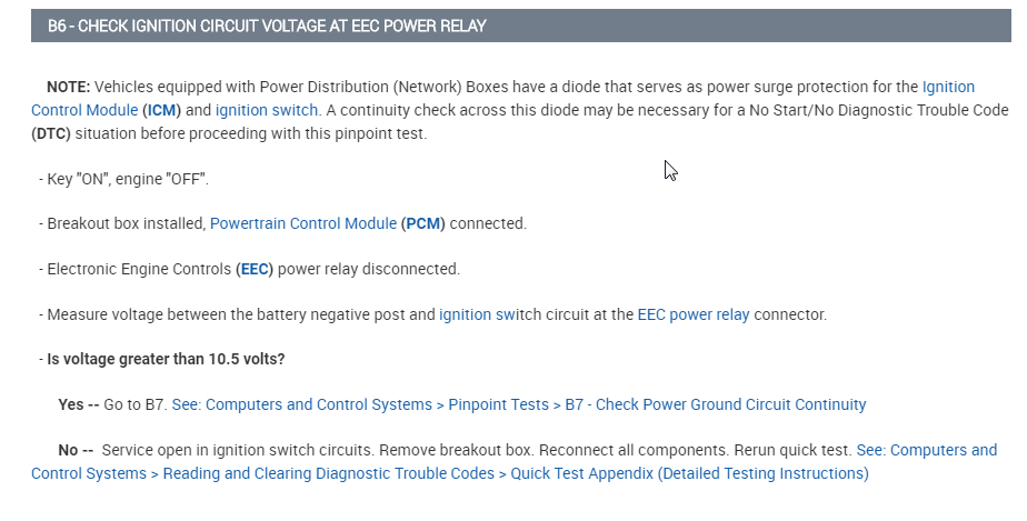

This sounds like an ignition switch issue. I attached the testing and other info needed. However, I would suggest looking to see if you have proper voltage when turning the key.
Let me know what you find and we can go from there. Thanks
