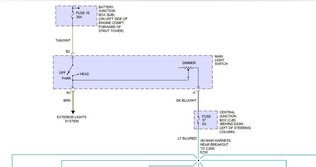

No lights on my dashboard behind the speedometer
PAULAANN
  • 2004 FORD MUSTANG
  • 120,000 MILES
When I bought the car it had no lights behind the speedometer. Tired of guessing speed at night. Sure there is a simple fix. That even a stupid girl can fix? I have been told that it is a blown fuse, but I do not own a book for it and don't know where they are located or what kind I need to buy to replace it.I would like to fix it myself without having to ask my Dad or any other male. Being they think a girl never should have bought this car. Thank you for any help you can give!

If the other instrument lamps work, I don't think it is a fuse? If none of your dash lites work, you can try rotating the dimmer? I'd probably have to remove the instrument cluster and take a look.
If you want to check fuse, anyway, check fuse 37--5 amp. The location of fuse box is in diagram.

Pull the instrument cluster out and check light out behind the instrument cluster and change it that should fix the problem
