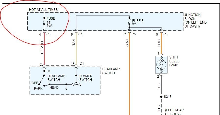

No working lights. none of my lights work on the dash or outside.

If all light are affected, there is only one common element with them, the headlight switch. The switch is powered via a fuse. Check that first. If it is good, I suspect the switch is bad.
The fuse is in the vehicle, left side of dash. It is fuse number 14, a 15 amp fuse.
Check that first and let me know what you find.
