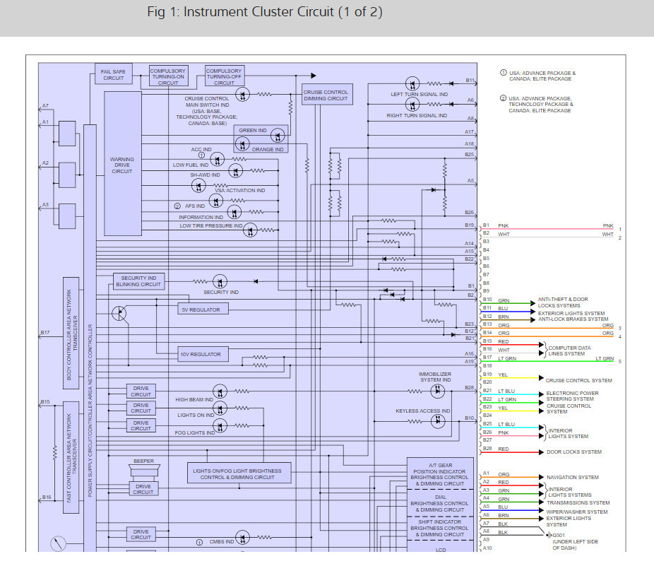

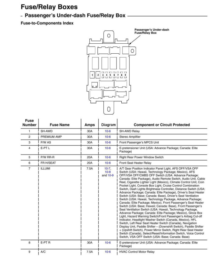

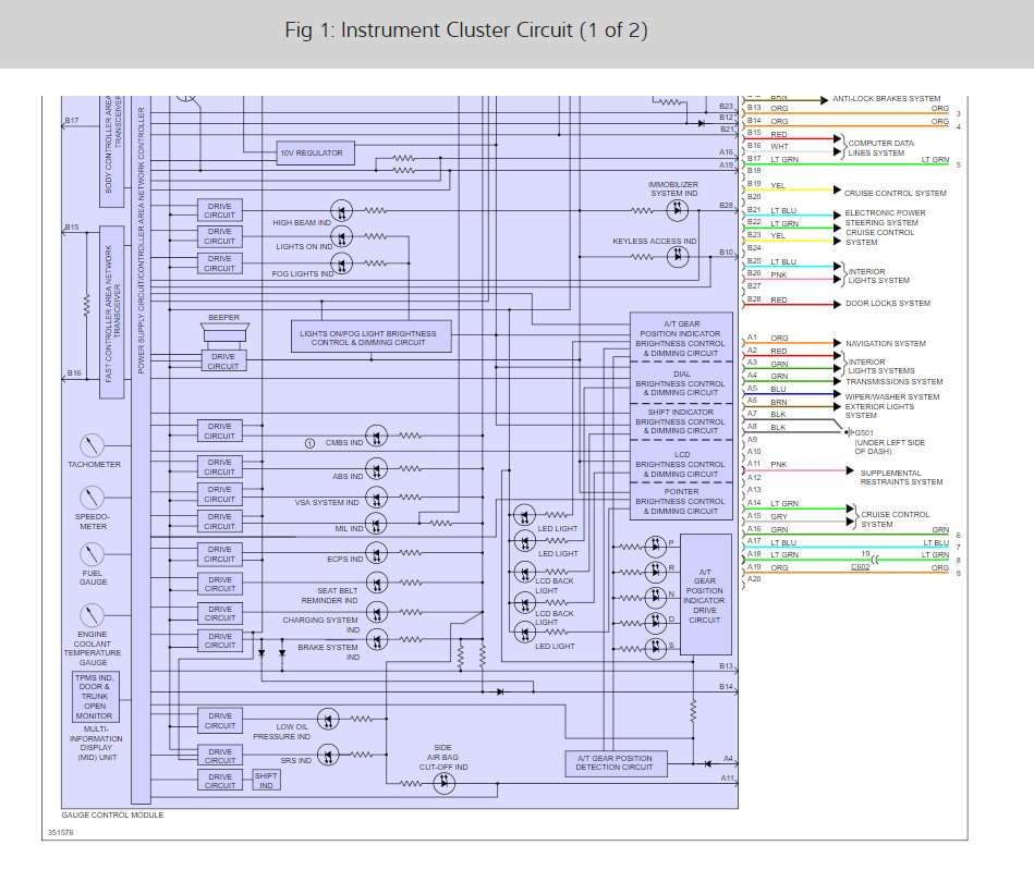

No light on the dashboard
Jan 22, 2019 at 9:39 PM
  • 54,832 POSTS

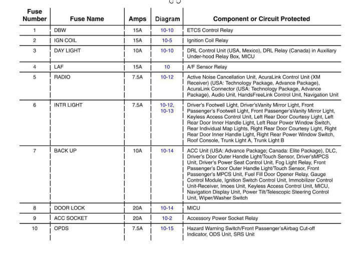

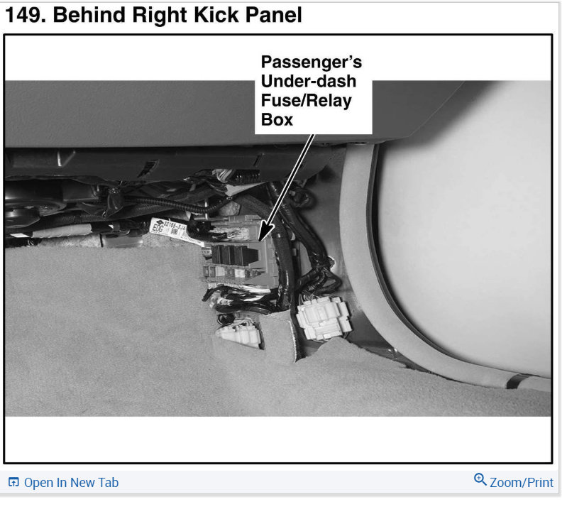

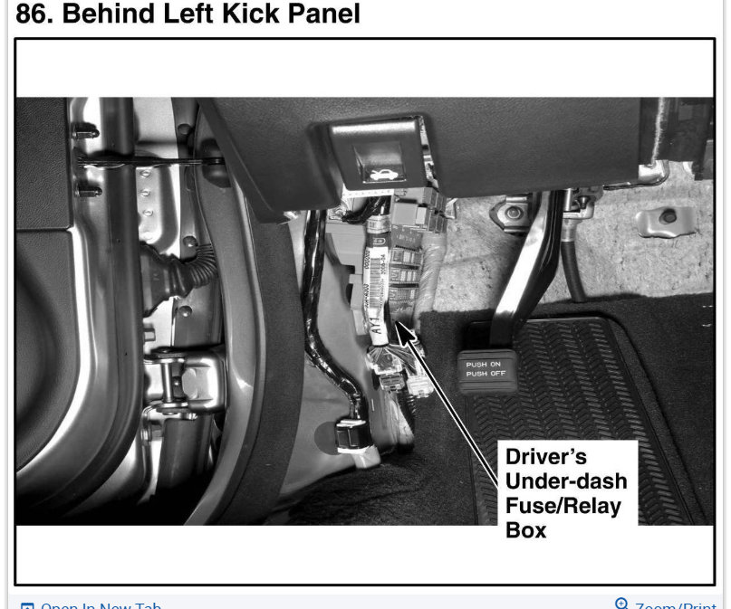

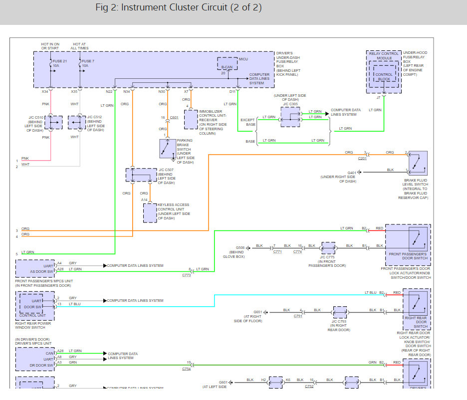

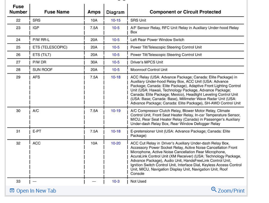

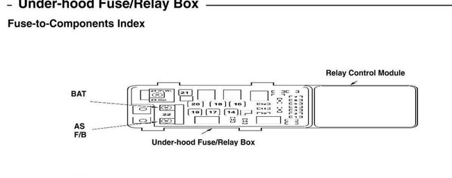

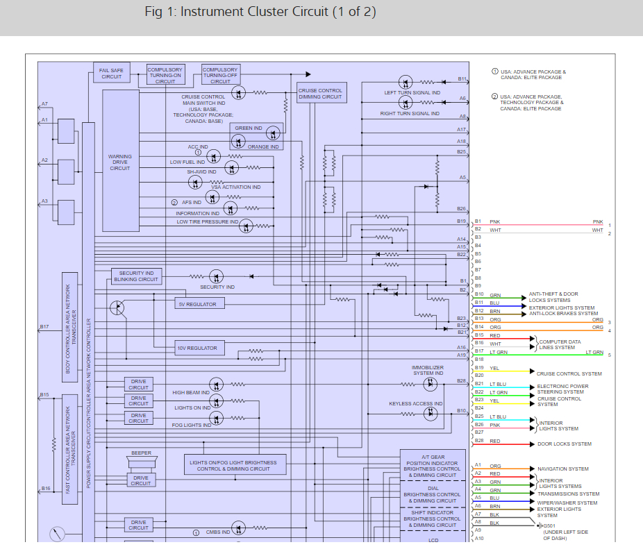

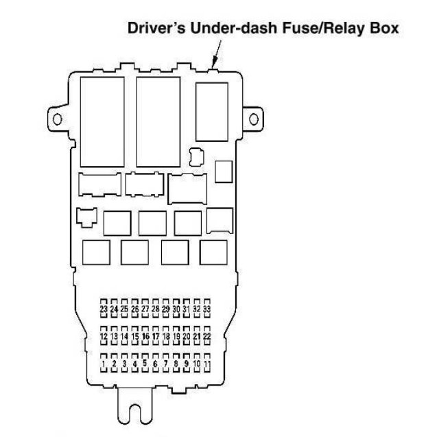

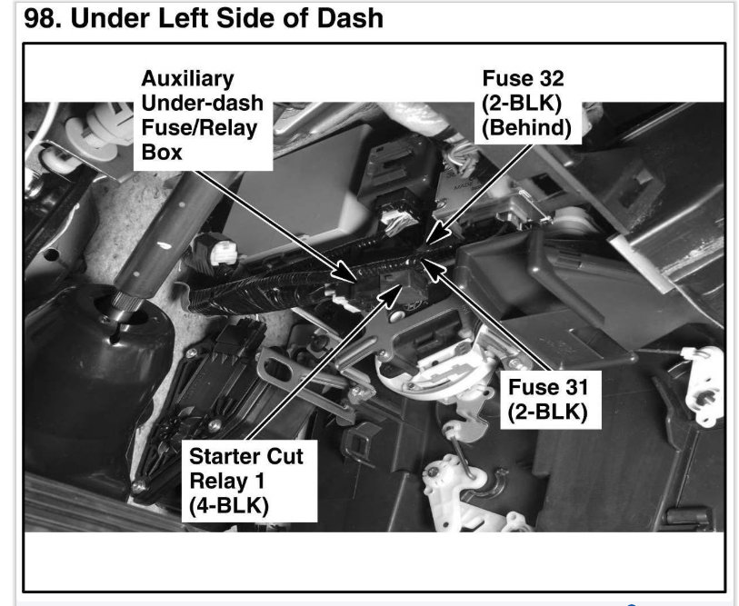

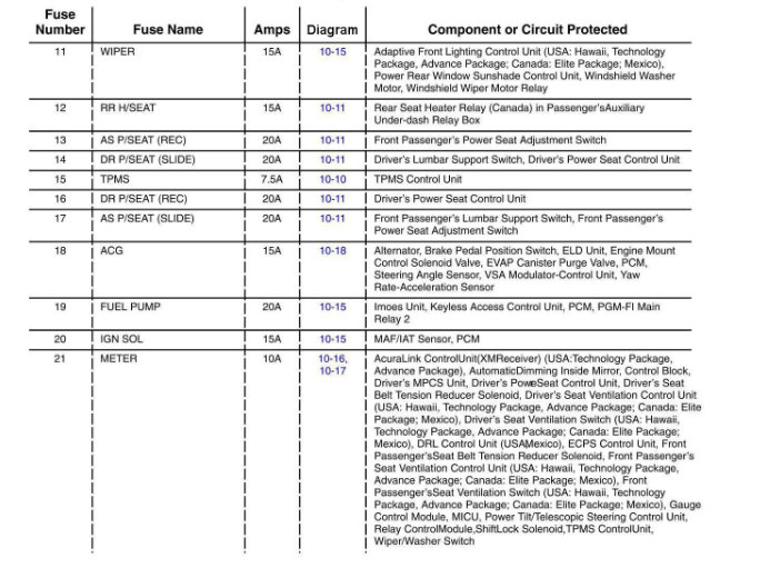

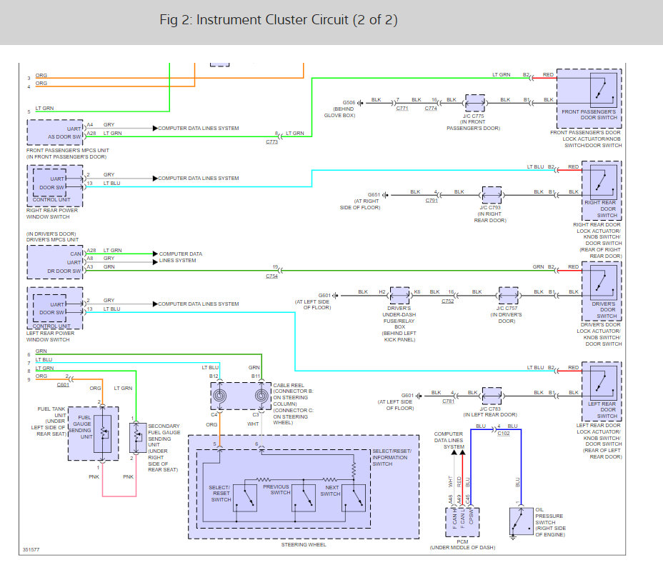

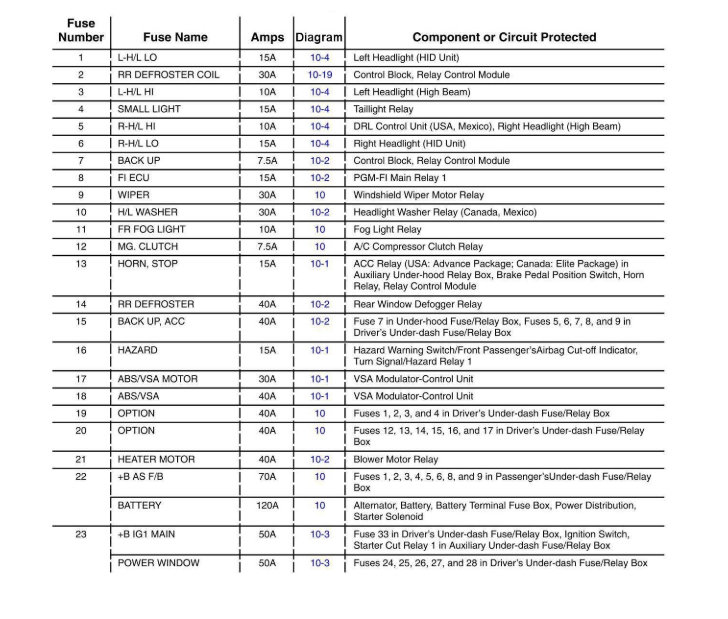

It sounds like you have a fuse out here is a guide that will help you check fuses # 7 and 21 and the fuse location as well with the cluster wiring diagrams so you can see how the system works.
Check out the diagrams (Below). Please let us know what you find. We are interested to see what it is.
