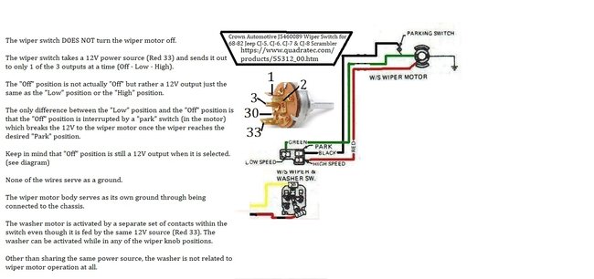

Lets start with the wipers.

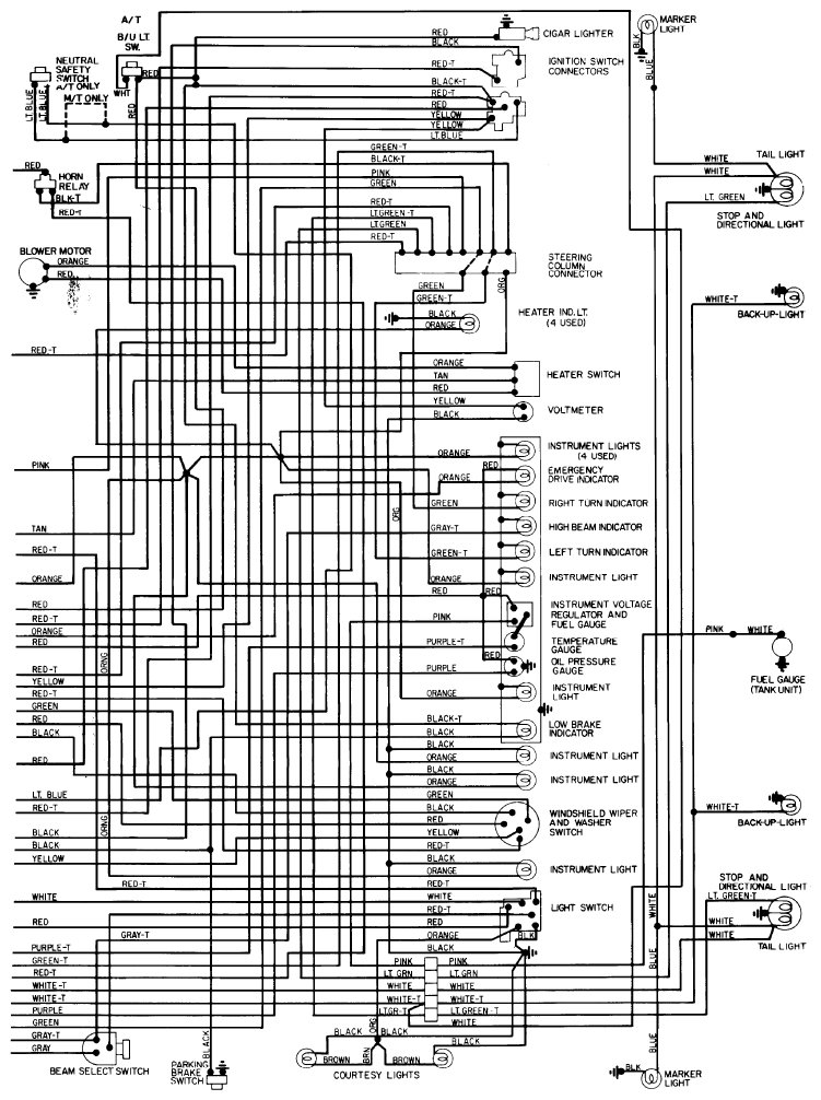

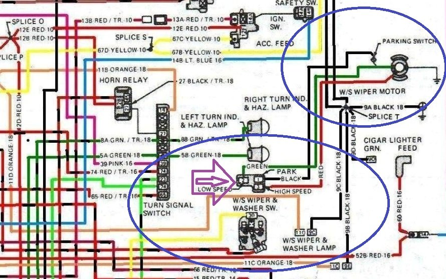

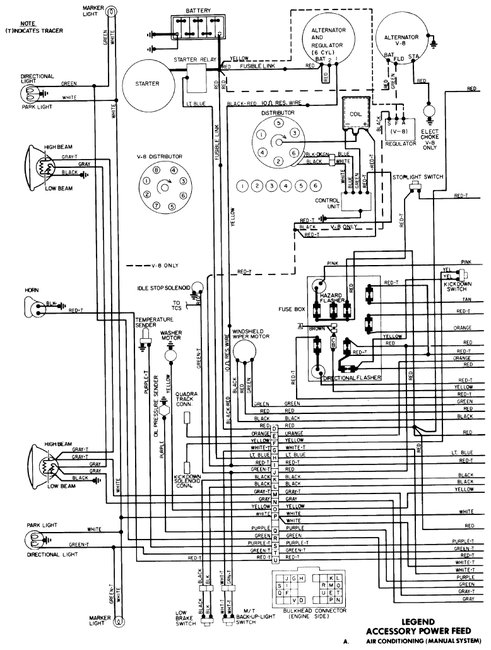

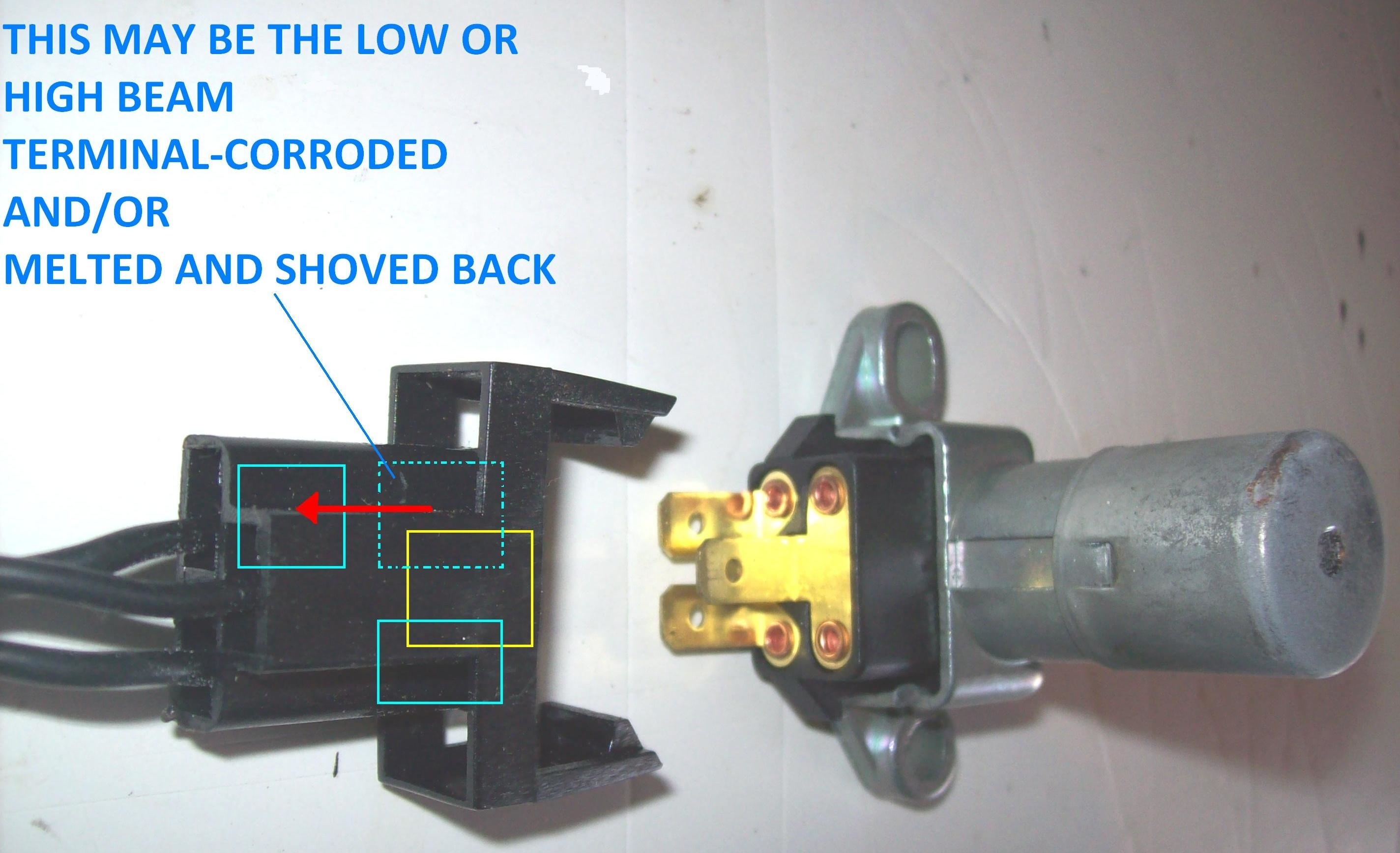

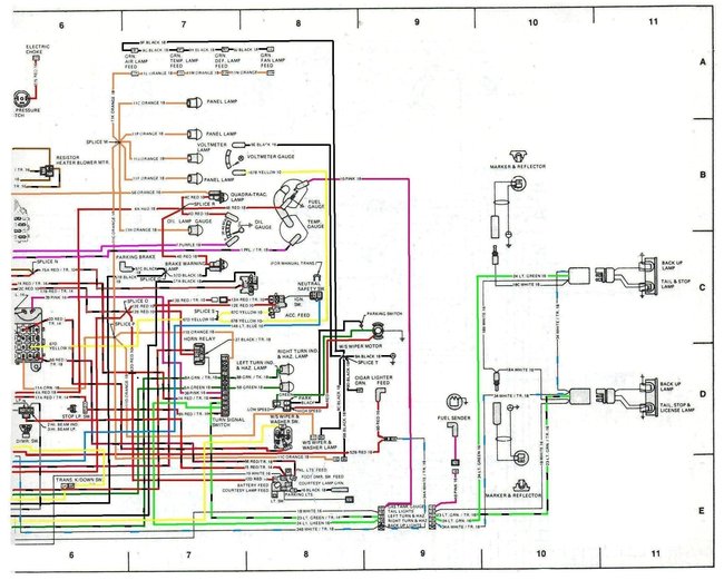

I colored this diagram out of a manual.
Any wire with black/other dashes along it is a wire with a tracer/stripe (the manual did not denote the color of the tracer - the dashes do help out anyway!
Picture 1 shows the switch, connector and the wiper motor.

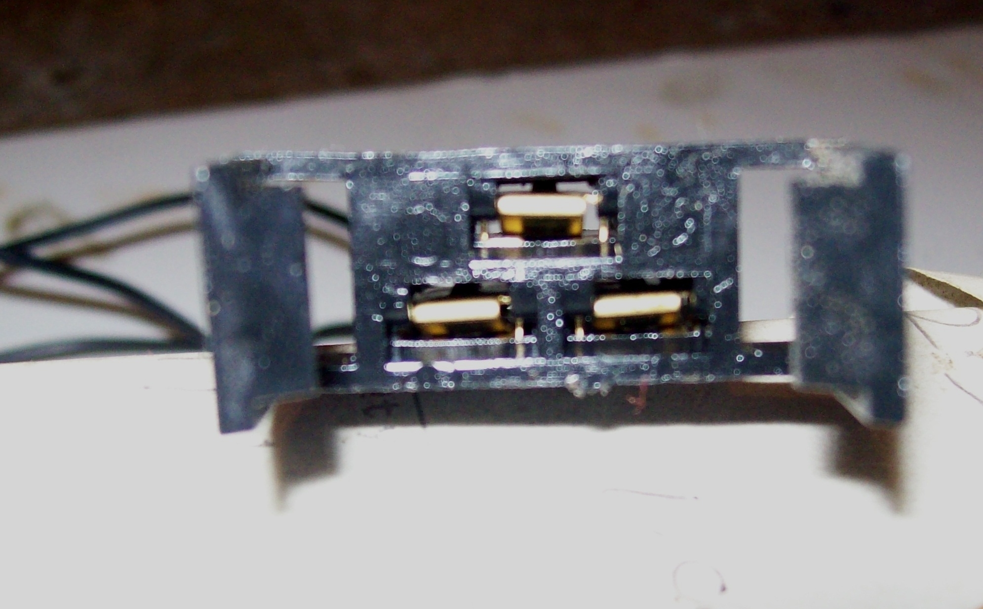

Concentrate on the connector (three females)
Picture 2 is of the dimmer switch and it's connector, 100% unrelated to your problem except for what can happen to the connector (this can happen to any connector!)
Picture 3 dimmer switch connector. (Sorry, I did not have a picture of one that is actually melted and pushed back).

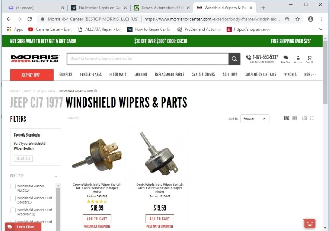

I cannot seem to source a switch that looks like the one you showed me in the diagram.

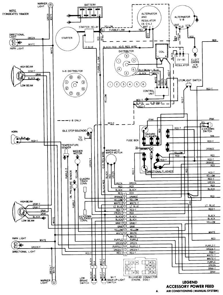

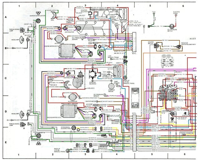

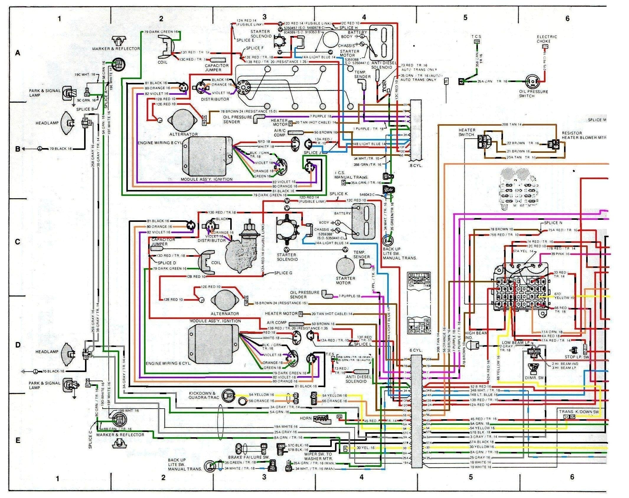

That diagram I've been using is for a 1979. (Scanned from a paper manual, then I colored each wire with MS Paint)
I even had the office store blow up both halves. I connected them where they overlapped and then they laminated it for me. If I recall right, about $25.00. You just can't beat a giant colored diagram!
I have a nice 1977 diagram from "Prodemand", I've been meaning to color it as I did with the 1979, I've not posted it yet, I hope it's not blurry.
Much of it is the same except the ignition system and the fuse box.
I'll send you the diagrams, as it looks like you know how to trace wires.
I upgraded my unreliable 1977 "Prestolite" ignition system to "Motorcraft" (which was adopted in 1979 by AMC)
Are you sure the orientation is not a mirror image of the switch?
Is one of these yours? (See picture)
The Medic
I don't know what I did, but the body of this post may be long and blank? (Hit a button or something?)
Pictures will be at the bottom
Left and right halves the 1979 first, then the 1977.

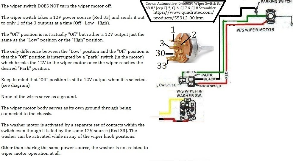

I want you to cease playing with the wipers until I can orchestrate you some really good diagrams and explanations.
I can explain this really good for you, as I think you have over-thunk the way it works. I'll try to work this all out for tomorrow if the wife will let me have my time and not Christmas honey-dos!

The switch I show in my diagram is the correct one.
Testing the switch is simple.
Connect your voltmeter (ohms continuity)
One lead to 33 the other to 30. You should get nothing, push the knob and you should have continuity. Washer circuit is good!
Leave the lead on 33 and move the other one to "1" (off). If the switch is in the off position you should have continuity. (Yes, "off" is powered)
Stay on 33 and move to "2" (low speed) with the other lead, move the switch to low speed, you should have continuity.
Last, stay on 33 and move the other lead to "3" (high speed), move the switch to high speed, you should have continuity.
When actually testing with 12 volt jumper to the wiper connector (not through the switch), remember "2" and "3" may randomly stop the wiper shaft anywhere in their travel. Powering "1" (off) afterwards should move the motor back to the park position and then stop.

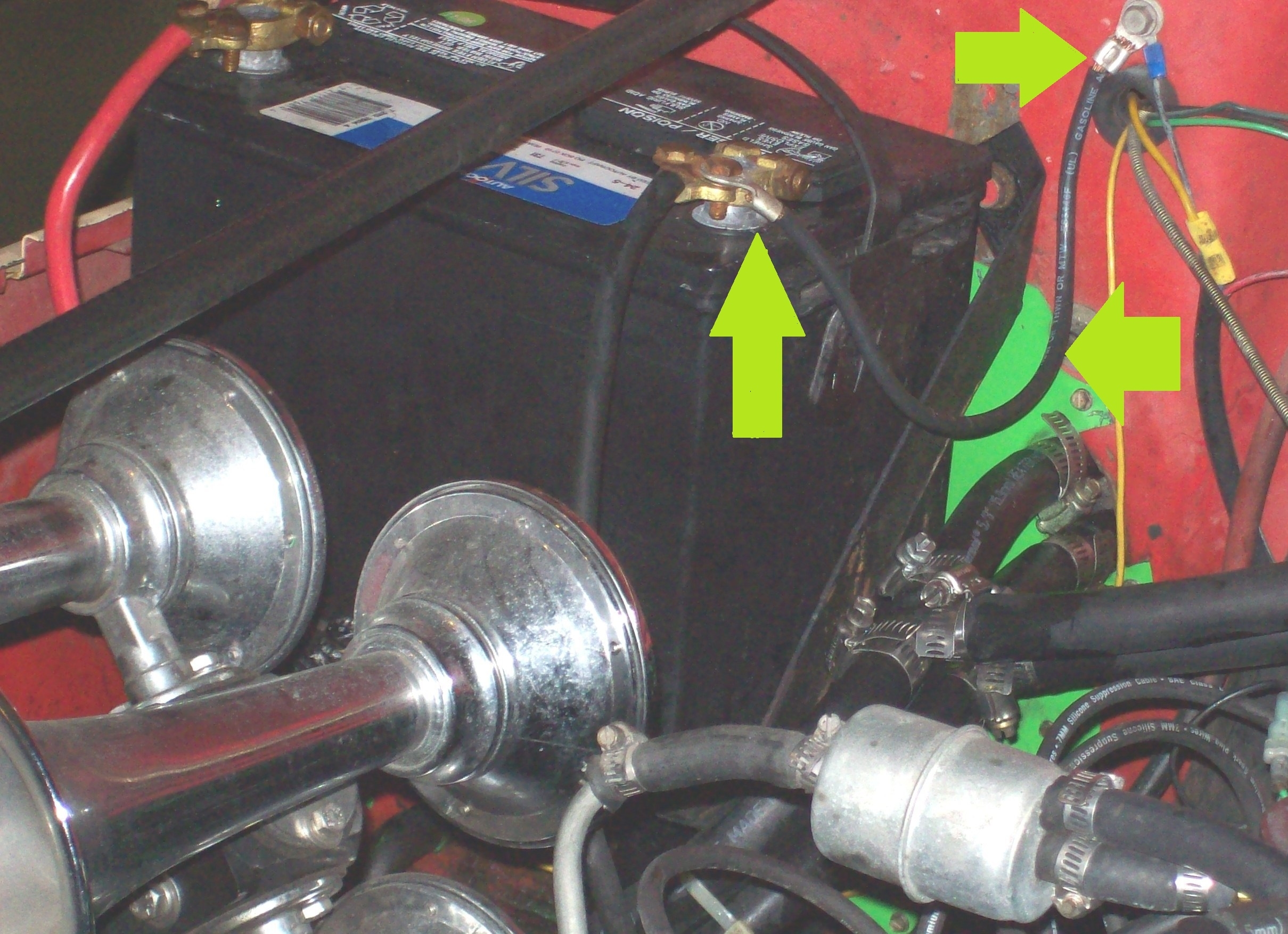

Let's back up a second.
The motor's output shaft is not in a bind?
You can run a temporary wire from the wiper motor to the negative side of the battery, insuring you have a great ground.
Do you have a body ground from the battery? See my picture.

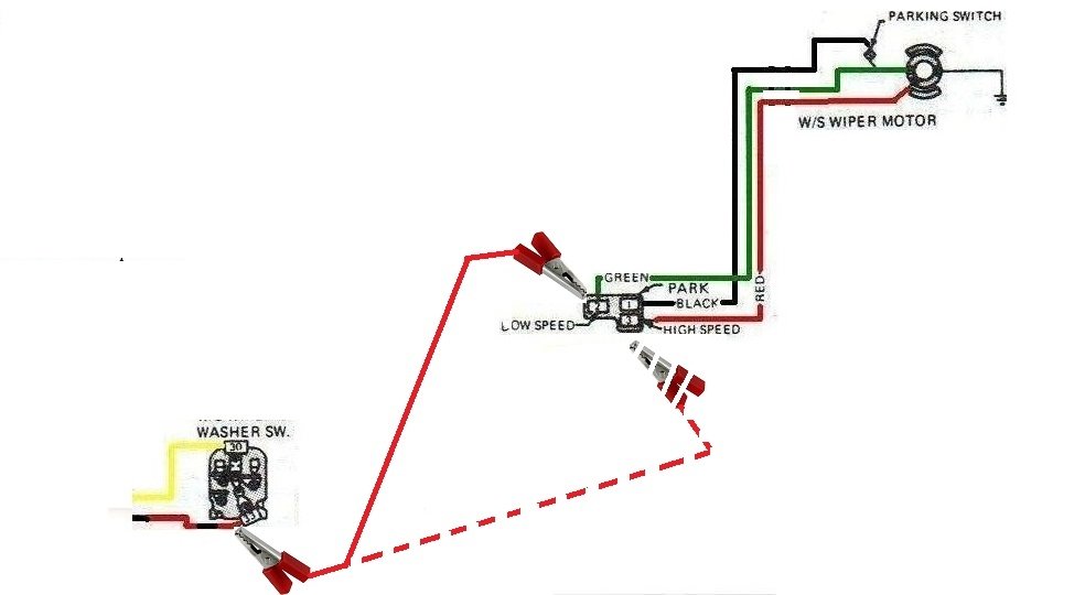

Bypass the switch as a test:
One at a time, jumper wire "Wire 33" to "2" on the connector. Then try the same for "Wire 33" to "3".
If results are not good, try "2" and "3" one at a time from the positive side of the battery.
Results?

So, great success! Grounded to battery and all works. Hooked a ground to a bolt on motor and then ran a ground to the interior frame. Hooked up the wiper arms voila swish swish locked up. Lol. I noticed the driver side arm locks up as it returns. The joint at the driver wiper pushes out and it locks the ability of the motor to return. I tightened the nut on the exterior of the frame and that seemed to hold it in better so it will continue to cycle back and forth, but I fear this will wear the windshield frame metal until it breaks. Not sure how to reinforce it.

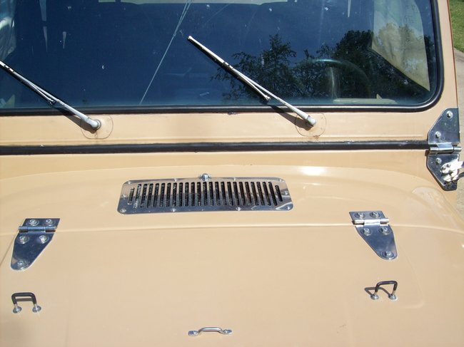

With your wiper linkages,
You need to take out the rods and the swivels (axles), Bend everything back to their original positions.
When I got my last/ present 1977 CJ-5 back in 1991, had the same issue, maybe even worse. The passenger side "hump" was torn halfway out due to the binding and popping of the swivel/ axle.
At the time I had no fundage to replace windshield frame.
I made a really cheap repair, and still have it today!
(One day I'll replace it with a fiberglass, non-rusting frame!)
So what I did was found a busted up windshield frame at a self serve auto salvage yard. With some nice cold soft drinks before I even went in there, and just a little whining when I got back to the office/shed. They gave me the useless frame.
It's been so long, I think this was a pre-1975 frame (still worked as I wanted it to).
I rough cut the "hump" section out for both sides, then I done some shaping. I installed them on top of the ones on my Jeep with a dose of silicone and some rivets and we were operational once again! Kind of looks "different" but it's now double thick. Been there now for 27 years.
They're not too awful noticeable, are they?
See my pictures below.
