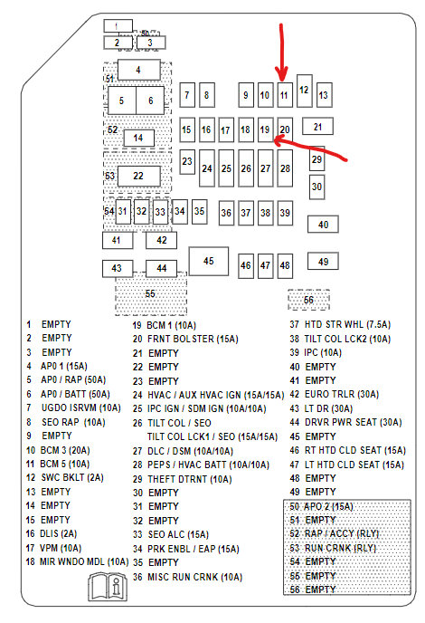

I have had my used vehicle listed above LTZ model for two years and never once do the dome lights come on when the door is opened.
I don't see anything on the dash to turn on or suppress the dome lights.
All of the bulbs where a person can press a switch front and back and 3rd row come on with a push of the button in the ceiling.
I am unclear how the domes are controlled and what to check... can it be a simple fuse or something more?
Dec 18, 2023 at 4:10 AM
  • 55,395 POSTS

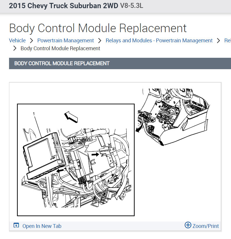

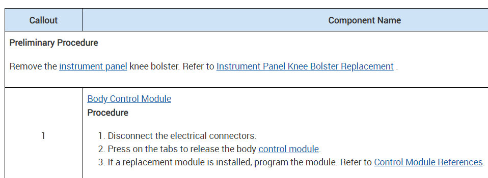

The interior and dome lights are controlled by the BCM (body control module), on some models there is an interior light control switch on the center console so I would check for that. We need to check the BCM1 and BCM5 fuses which are located on the interior left side fuse panel.
Here is a guide to help and the fuse locations as well:
If the fuses are good chances are the BCM is out and needs replacement, you can get a preprogrammed unit by searching Google or Ebay. To be sure you should do a CAN scan which will have a code for failure. You can get a CAN scanner (Controller Area Network) which will work on most cars from Amazon.
https://youtu.be/u-4syLc-ifQ
Check out the images (below). Please upload pictures or videos of the problem so we can see what's going on.
