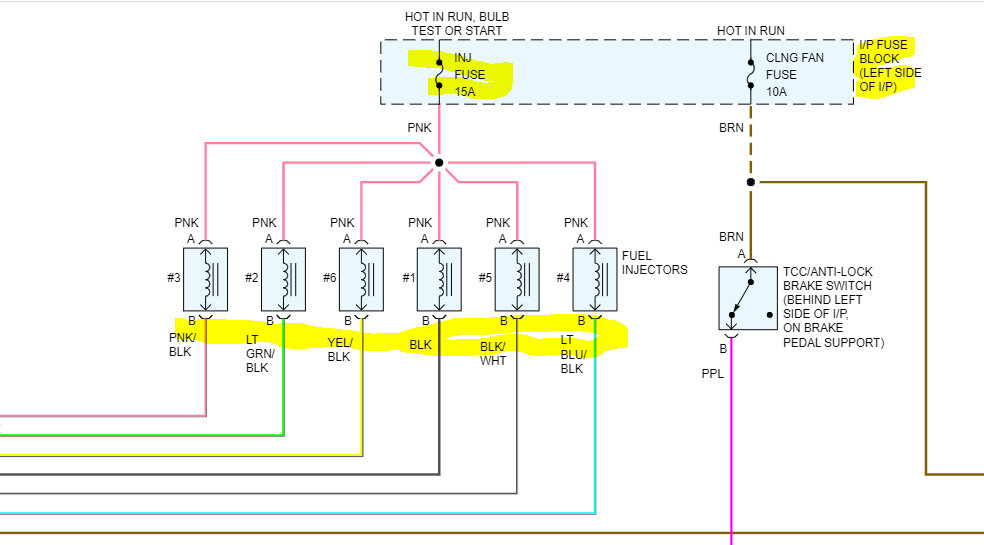

Each injector should have two wires. One of the wires at each injector should be pink in color. That is the power wire and I suspect the one you checked.
The second wire at each injector is a different color. That wire provides a ground path via the PCM to complete the circuit and inject fuel.
So, here is what I need you to do. Since we know there is power, we have to check for the ground path. The wire opposite to the pink one at each injector is where we need to check. (See pic below for wire color).
Take a test lamp and connect the alligator clip to the battery positive. Touch the test lamp to the ground path wire on the connector to the injector. Have a helper crank the engine. The test light should strobe on and off.
Try this and let me know the results.
Take care.,
See pic below.

Yes, I've tried that and there is no injector pulse. I connected my test light to the positive terminal and the control wire at injector and there is no pulse. I tried starting the car with starting fluid and it did start which tells me it's got spark but it isn't getting the injection pulse. Thank you so much for your help. I will follow along whatever steps you suggest.

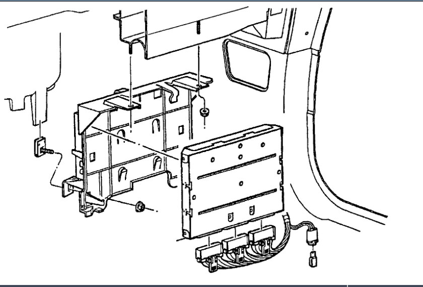

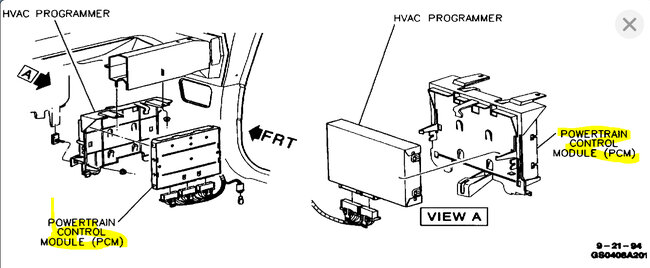

If you don't get a pulse at any of the injectors, we need to check at the PCM. The PCM is under the dash on the right side. See pic 1 and 2.

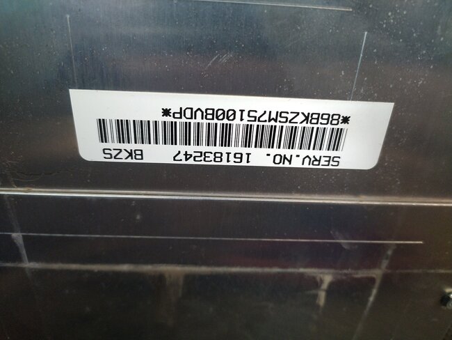

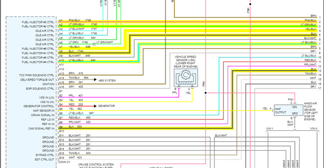

Pic 3 shows the connectors at the PCM. You need to locate the wires indicated in connector A. You can back probe the connector but be careful not to damage the wiring. Or you can remove the connector and check right at the PCM connector pins for a ground.
If there isn't one, chances are the PCM has failed.

Okay, so you want me to do the same test here, correct? I'm checking for an ignition pulse going out from the PCM? So, I will hook my test light to positive of battery and check for ground pulse at connector A noted in the diagram. Also, I notice the cam signal input is highlighted, should I also be checking for an input from that wire? And would it be the same test? Looking for a ground signal in to the PCM? I just want to make sure I'm thorough here.
May 17, 2023 at 2:17 AM
  • 110,248 POSTS
I highlighted the cam sensor by accident. Sorry about that. However, yes to the injector wires indicated. You are checking for a ground path, so do the same thing as before, positive on the battery and the test light to the wire to check for ground. Remember, the engine needs to be cranked to get the signal.
Before you go crazy testing, disconnect the battery, remove connector A at the PCM, and inspect the connector pins for corrosion, damage, or if any are pushed in.

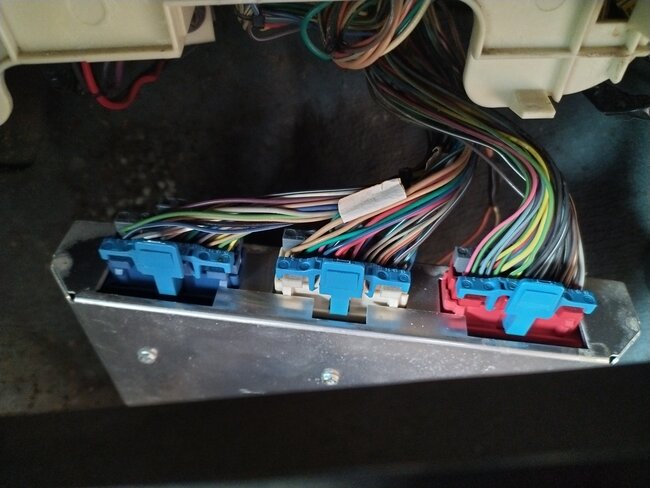

Okay, I've accessed the PCM module. I tested for injector pulse and nothing. The unit itself is grounded if I touch my test light from positive to the PCM frame itself. When the key is off, I receive ground from the injector pulse output, when I turn the key to the on position, I get no ground indicating that the PCM is live I think, I'm not sure. But when I crank the engine there is no injector pulse coming from the PCM. Is there anything else I should check here? What about power and ground going to the PCM? I have a friend that suggested resetting the PCM by detaching the battery and placing a 1ohm resistor between the positive and negative terminal with the battery removed for about 15 minutes. I'm trying that right now to see if it does anything. My other question would be are these PCMs interchangeable? Like if I find one at the junk yard can I just simply swap it out or does it need programming etc?

I don't see anything broken or out of place visually.
