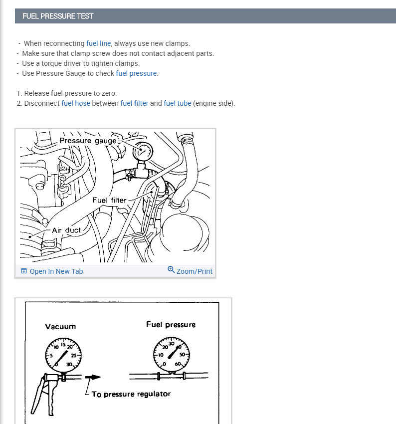

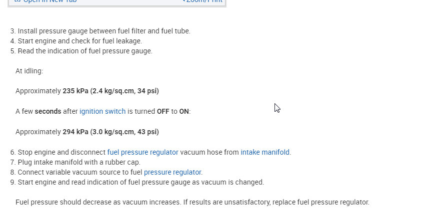

How did you confirm you have good fuel pressure at the rail? Did you actually check the pressure? If so, what was the PSI? I attached the process on how to test the pressure from the manual. Let's start with this and confirm the fuel pressure is good.

The fuel pressure was checked using a gauge at the outlet of the fuel filter. it was 55-60 psi.

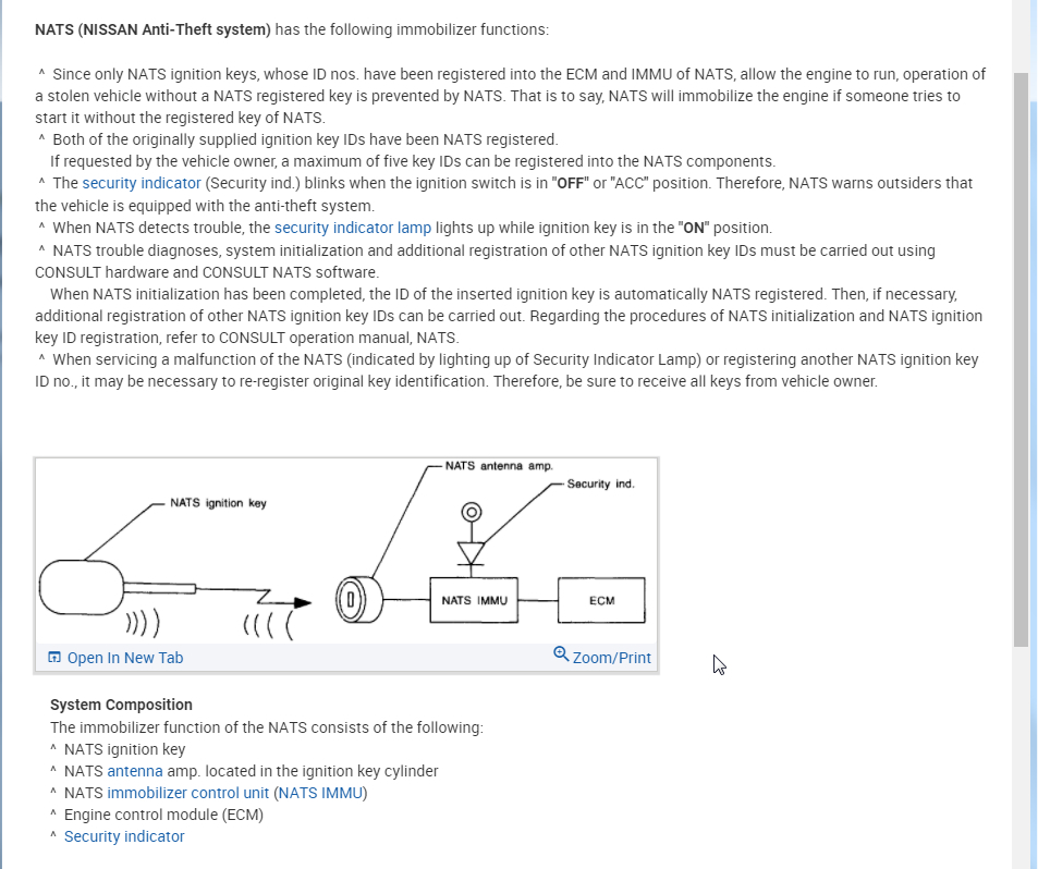

Awesome. Noid light is all I needed to hear. Shows you understand how it is operating.
The security system was the next step so thanks for being on the same page as me.
Does the theft light stay on when you turn the key on or crank the engine? Is it flashing? The only reason I am hesitant about this is because you said it hesitated the day before it would not start. This would not be a security issue. This would be a fuel issue.
However, if the PCM is not firing the injectors then clearly it is due to something shutting it down. Let me know about the theft light and then we can go from there.

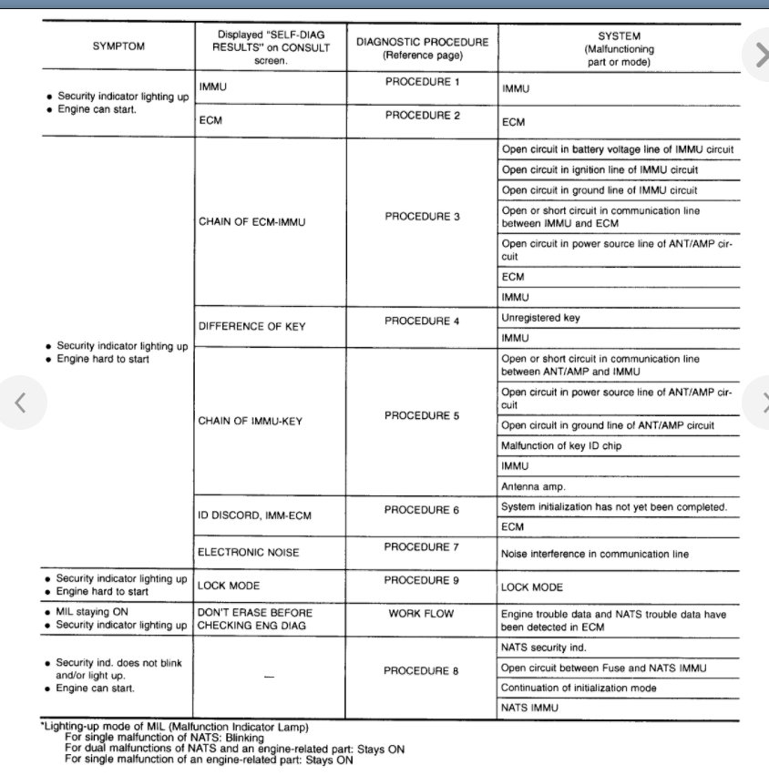

Okay. I think we are getting closer. You are correct that you don't have a more modern key that is considered a transponder but you do have a key that is registered to the ECM. I attached the info about this and you will see that when the light stays on it is detecting an issue most likely with the key.
I would suggest we just get another key and program it to the vehicle just to see what happens as I suspect that is the issue.
