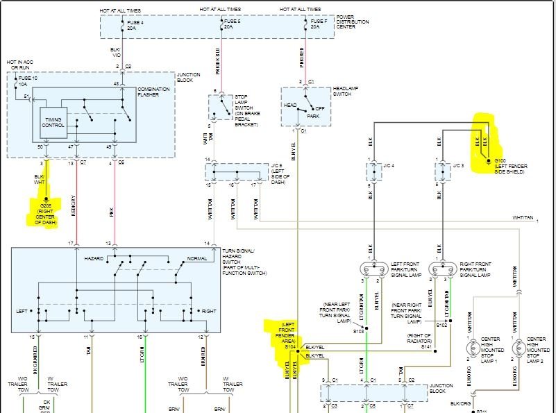

Hey guys, so I have the truck listed above 2500.
My dash lights and taillights are out , illumination fuse is getting no power, fuse is fine and even swapped the fuse and still no power. tested the box and where the fuse connects to and it's getting no power to my test light. any suggestions?
Sep 12, 2020 at 4:15 PM
4DRTOM
  • 467 POSTS

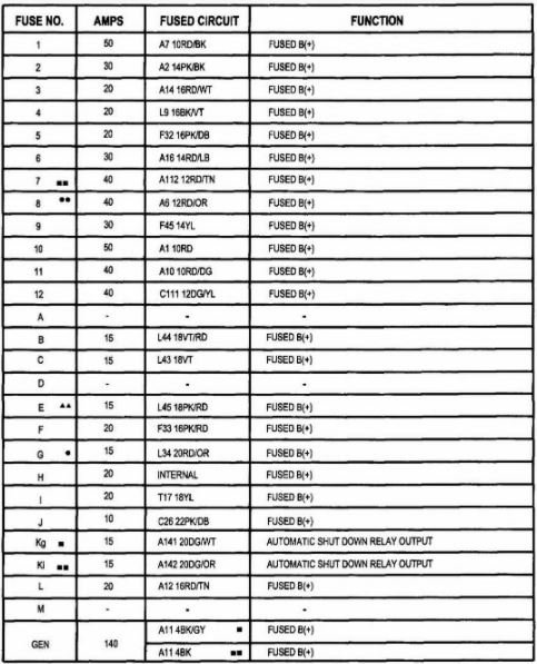

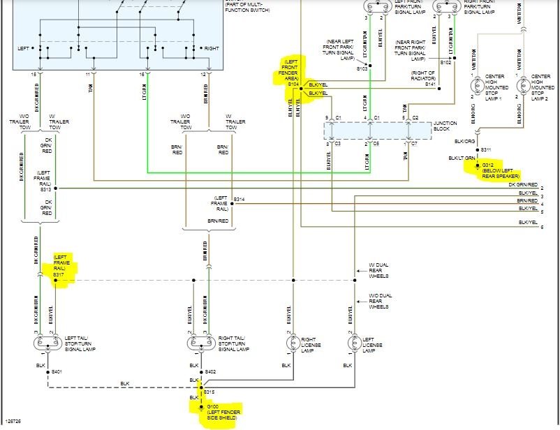

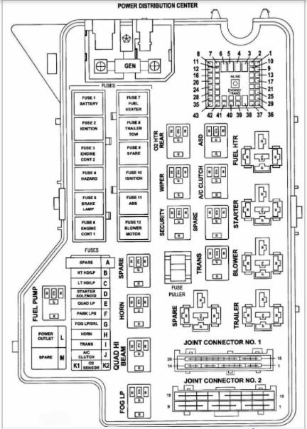

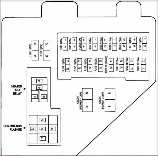

I would be checking the grounds out at the wheel, they get weather that makes them become weak. No power into a circuit we need a bit more info, so you do have the other lights working headlights, brakes lights, parking lights, front parking lights or are you just missing the dash and rear parking lights? Double check all the fuses making sure you have a good ground with your test light. Here are diagrams to use to see what the fuses are and I have highlighted the grounds and connections to verify in your testing.
Let me know,
Tom
See this article on the subject as well:
https://www.2carpros.com/articles/no-tail-lights-exterior-running-lights-tail-lights-out
