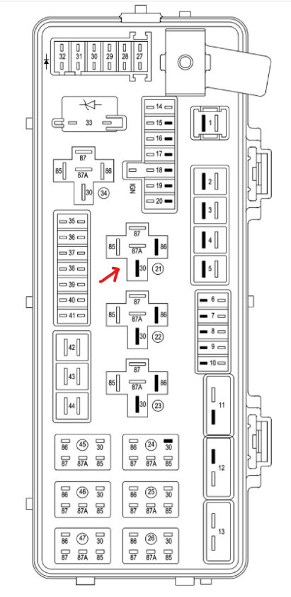

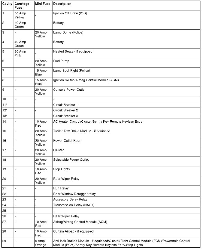

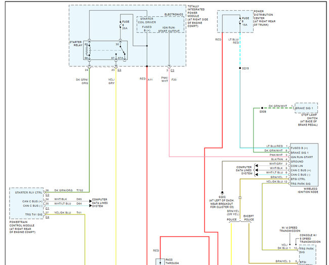

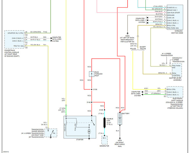

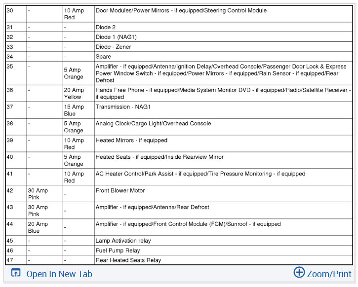

Dash won’t turn on with key on run position. Please I would like to know the ignition relay location, also will like to have the modules block diagram. Diagram for the key switch. I have no communication with all modules.
Does this model have a gateway?
Mar 13, 2025 at 6:14 AM
  • 55,732 POSTS
Hi Andrin,
I would check the battery first. Do the headlights come on? This car has gateways built into the can-bus system. I would check all fuses with the system on.
If the fuse is okay the TIPM might be out, you might want to do a CAN scan.
https://youtu.be/u-4syLc-ifQ
Check out the images (below). Let us know how it goes.
