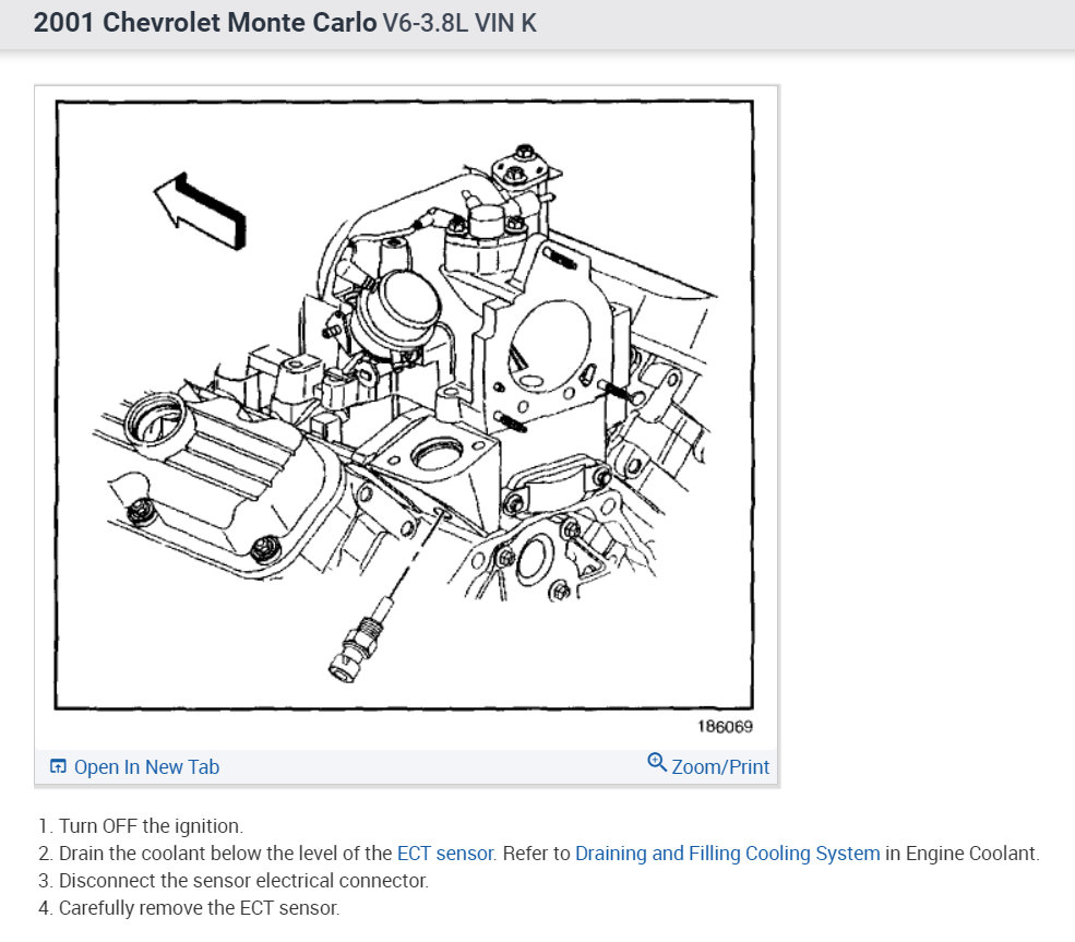

Engine shuts off after it has warmed up and will not restart
140,000 MILES • 3.8L • 6 CYL • 2WD • AUTOMATIC
JENNY JERRY
My car starts and runs great, but after it gets warmed up it shuts off and will not start back up until it cools down.
Apr 10, 2022 at 6:36 AM
  • 55,732 POSTS

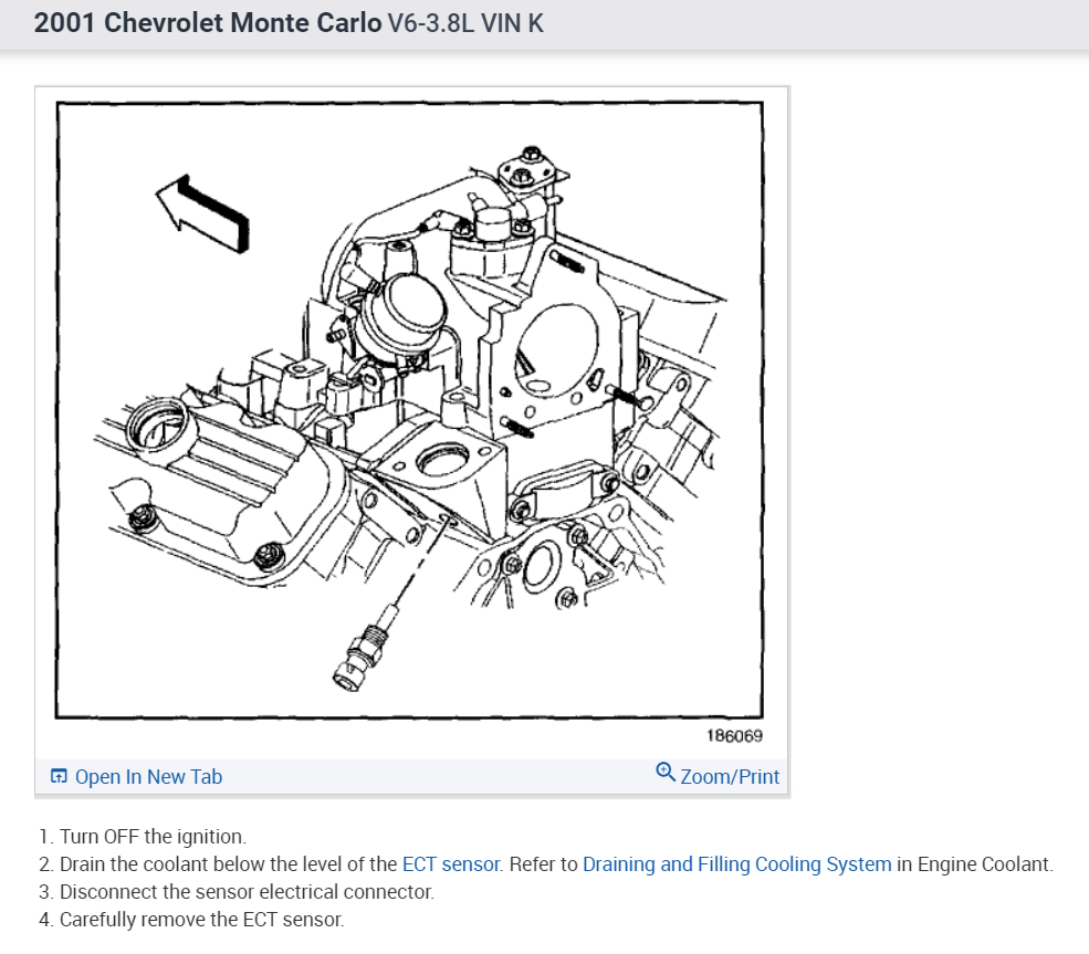

I have seen this happen when the engine coolant temperature sensor shorts out when hot, is the check engine light on? If so, this guide will help us get the codes:

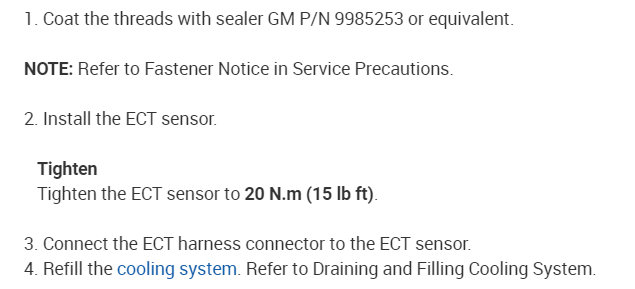

Here is a guide to help walk you through the coolant sensor replacement with specific instructions to help you do the job on your car in the diagrams below:
https://www.2carpros.com/articles/coolant-temperature-sensor-cts-replacement
