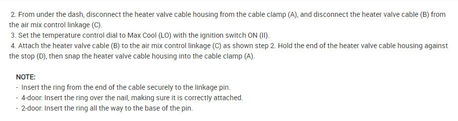

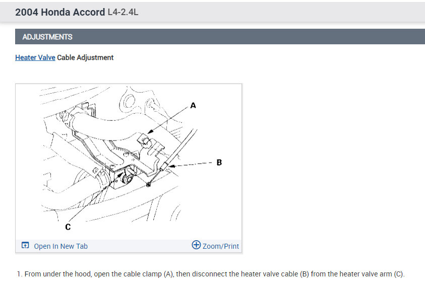

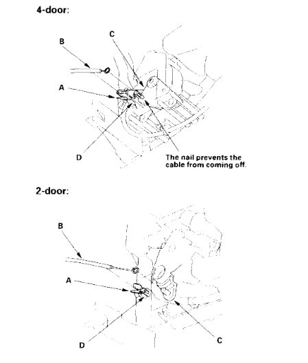

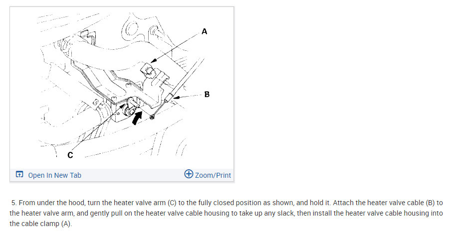

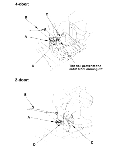

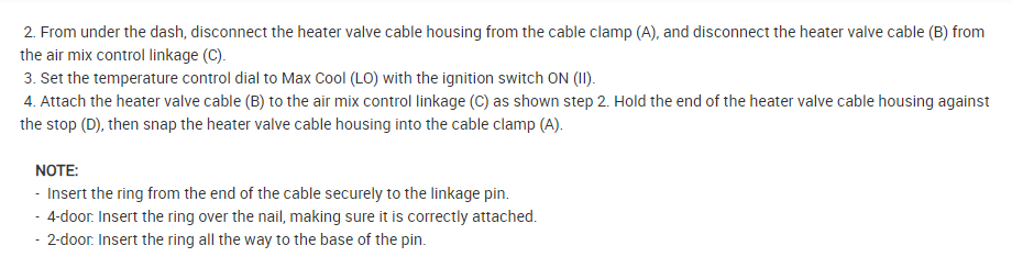

Also, the air temperature entering the cab is controlled by the air mix door. Have you checked for proper operation of the air mix door actuator? Additionally, on some of these vehicles, they used an air mix cable rather than an electric actuator and those vehicles also have a heater control valve.
If you look below, I attached directions for adjusting it. See if these things are located on your vehicle and let me know.
