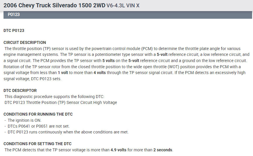

My truck started running rough after a big rain , I had it scanned for check engine light the code that popped up was p0123 which was throttle position sensor high voltage. I changed the TPS and IAC , also changed my air filter and and cleaned the throttle body. still I can't go over 50 MPH unless down hill. I have no take off or passing acceleration. what could be the issue?

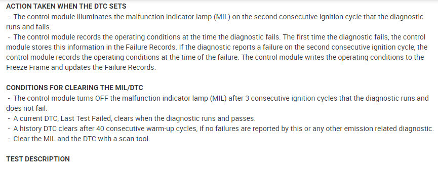

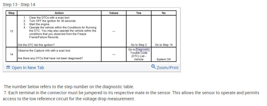

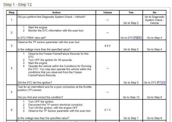

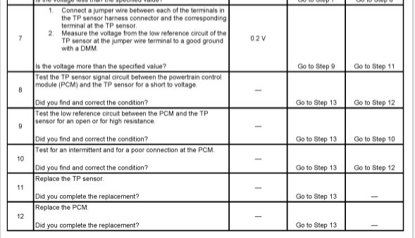

Here is the information you requested. Here is a tutorial showing how to test electrical wiring:
I've attached below picture diagnostic steps for the code P0123 relating to the throttle position sensor. This is like a flowchart for diagnosing this code in its entirety. Let us know what you find and we'll go from there. Hope this helps and thanks for using 2CarPros.
