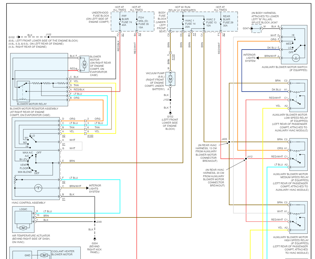

No heater/AC blower power?
2010 GMC SAVANA
77,000 MILES • 6 CYL • 2WD • AUTOMATIC
OUTDOORSWITHBOB
I changed the following:
Control panel
fuses
resisters
modules
controls light up
blower fan will not turn on
I forgot to mention:
I have power in the red wire going to the module but no power coming out on the red wire going to the heater motor.

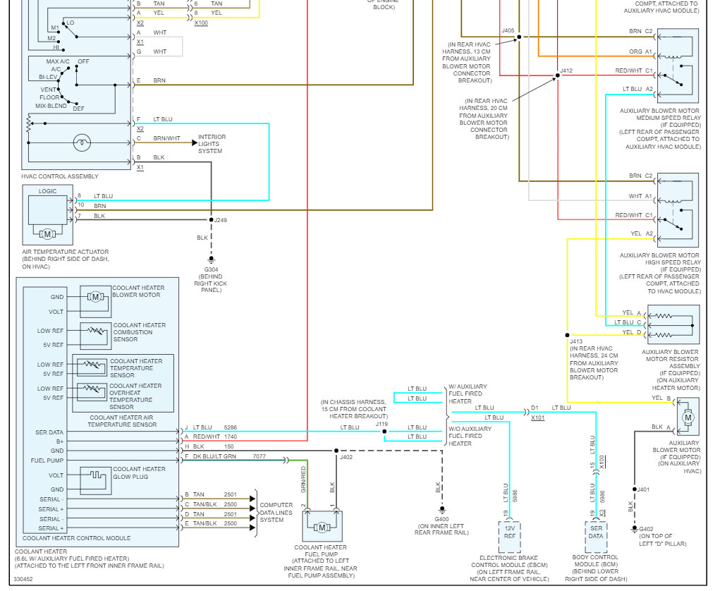

I would check the ground # G102. here is a guide to help and the blower motor wiring diagrams so you can see how the system works, this guide may help as well. It shows how to check the ground.
https://www.2carpros.com/articles/blower-fan-motor-works-on-high-speed-only
and
Check out the images (below). Please let us know how it goes.
