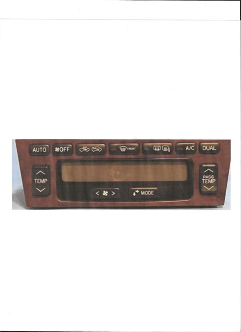

Hello Joe, thanks for the response yes i have automatic climate control, yes i have dual climate control, no i haven't moved the air mix actuator by hand because there is an air duct that has a section that comes apart (in half) and i can see part off the flap
moving to horizontal and going back to vertical position every time the mix actuator motor and arm move when i press the temperature control button here is a pic of my control panel.

If you have a dual zone system, is it both sides that are affected? Also, I am assuming it is only temp that is affected and not the airflow direction, correct?

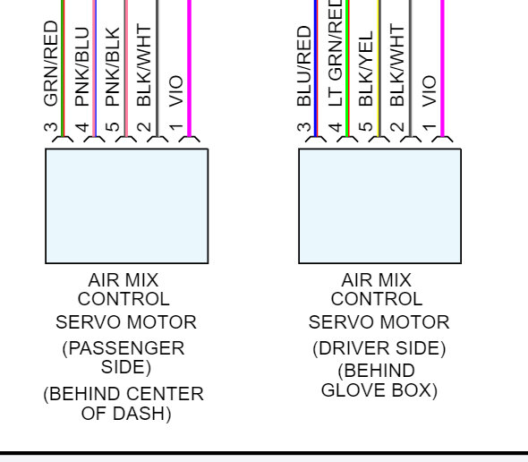

If you look below, it shows two actuators at different locations. This is why I need confirmation that neither side is working to produce heat and that neither the passenger's side nor the driver's side actuators are moving upon request.
See pic below.

yes, a dual zone system, yes air flow direction is good, the only thing is affected is no heat on right or left side.

Unless both actuators failed at the same time, one side should be different than the other. I would recommend flushing the heater core to see if there is flow through it. The idea that the hoses are both 130F (at operating temp) leads me to think there isn't any circulation. The coolant, at operating temperature, should be approximately 200F. As a result, one hose should be closer to that temperature and the other slightly lower.
Let me know if that is something you are comfortable doing or if you have questions.
