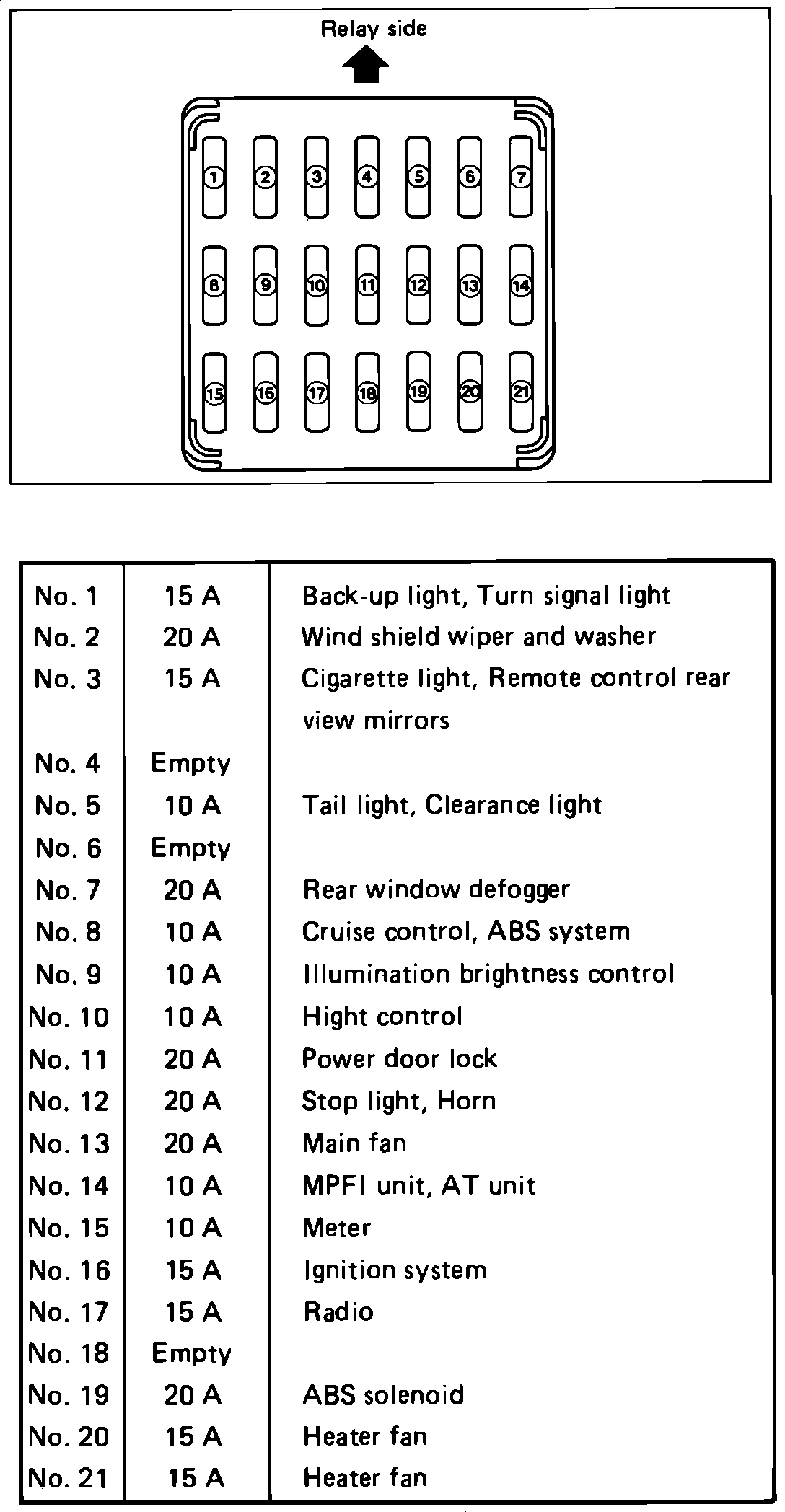

Fan is not kicking on at all not even on high. So I am thinking it is not the resistor. Is there anything else I should check before pulling out the glove box and replacing motor?
Nov 8, 2018 at 12:11 PM
  • 110,194 POSTS

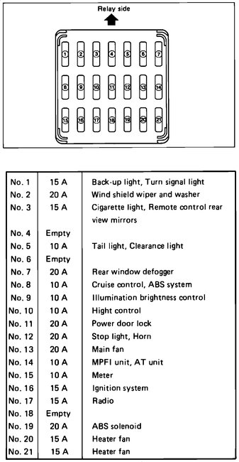

Before you remove the motor, check fuses. Check both fuse 20 and 21 in the passenger compartment fuse box. I attached a list of what each fuse is for as well as the layout of the fuse panel.

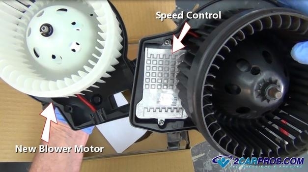

Mr.Joe. Thanks again for your time. I pulled the blower motor, once removed applied power, no movement. Tapped motor housing a few times with screwdriver motor tried to turn. Got new motor, of course they gave me wrong part. lol. Housing bracket did not line up. Plugged it in anyway. It was working like a champ. FYI, looks like for a 1994 Subaru Legacy wagon, you cannot buy the complete assembled unit. Have to buy motor, and fan separately.
Peace~
Nov 11, 2018 at 10:11 PM
  • 110,194 POSTS
Welcome back:

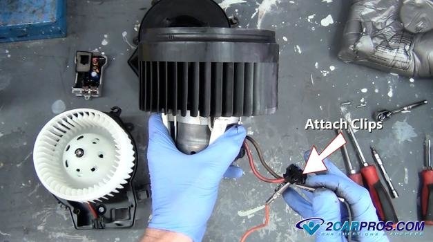

Honestly, often times, the motor is separate from the fan itself. You should be able to remove the fan itself from the motor and reinstall it on the new motor. I attached two pictures for you to see. Look closely at the center of the fan. You can see on this motor there is a clip that holds the fan blade on the motor. It can be removed. See if your design is similar.

Hey man. Motor should be here tomorrow. Took old motor apart. Pulled the clip cut wires at brushes, shrink tubed connections at clip.. gonna but splice new motor wires.
