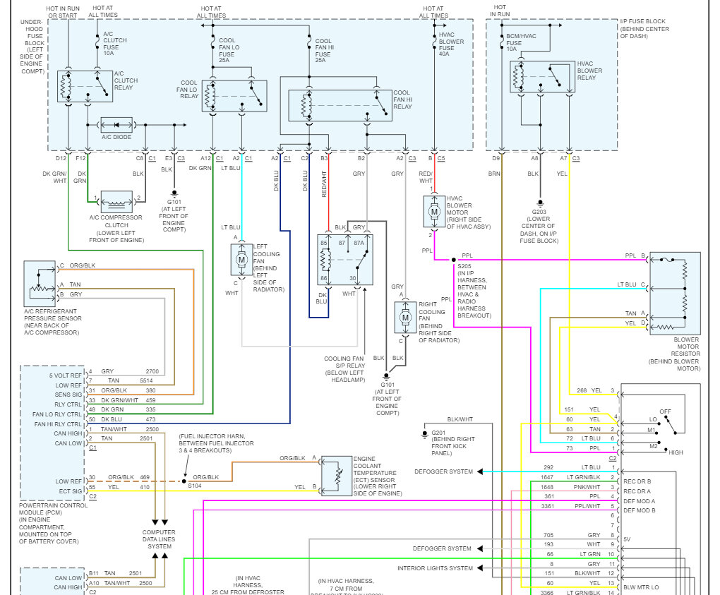

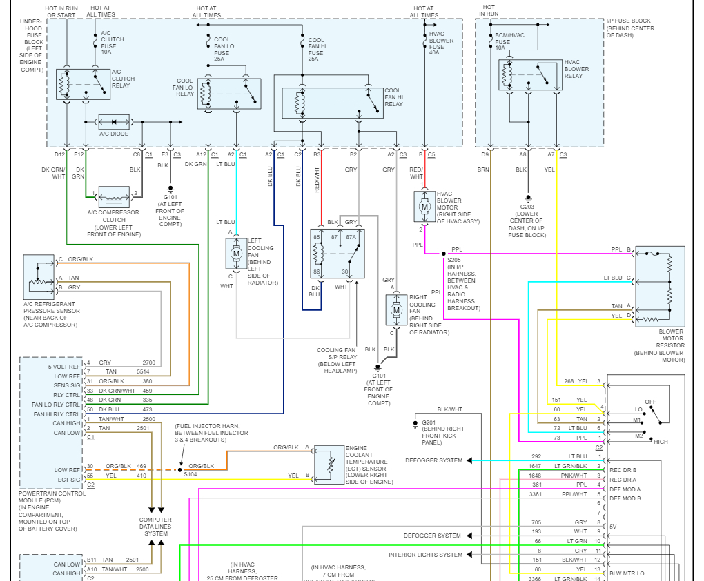

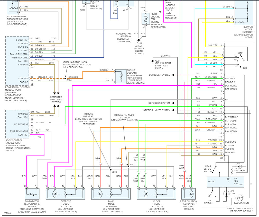

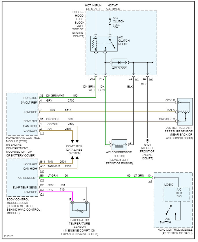

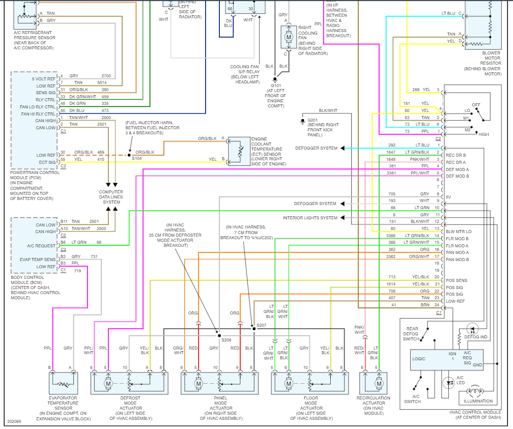

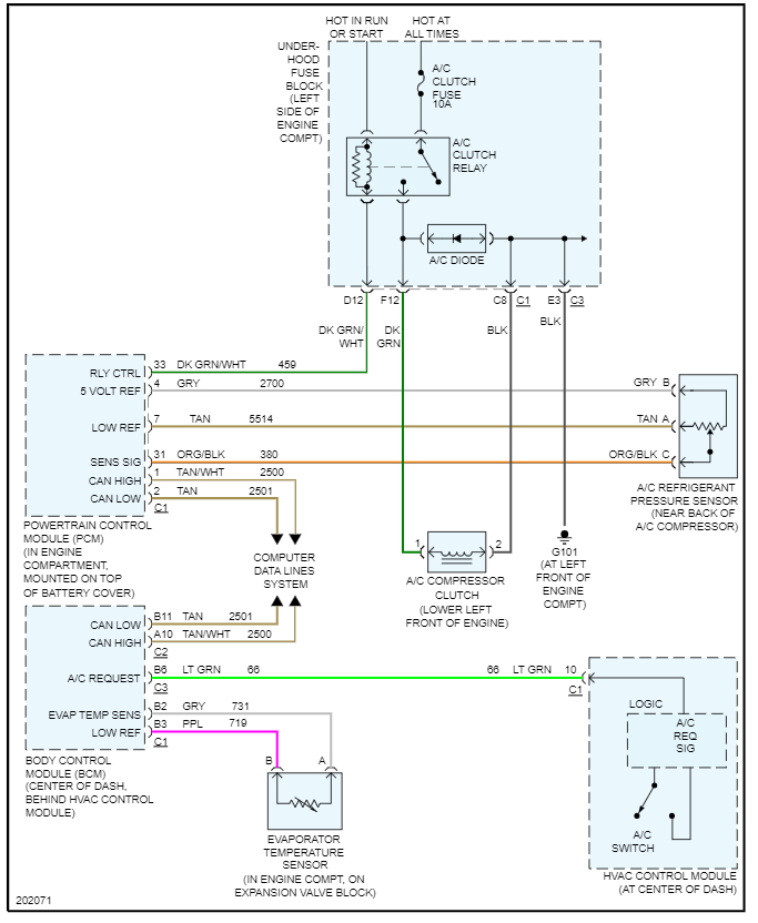

Here is the A/C system and compressor wiring diagrams so you can see how the system works. I would double check the fuses mentioned in the wiring diagrams for power when the system is on to be sure.
