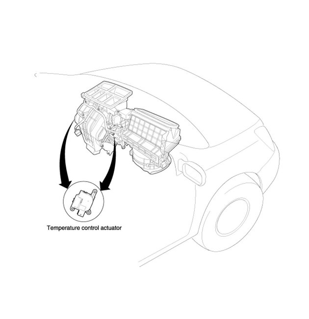

Remove the lower trim panel on the drivers side. Look up onto the - passenger - side of the HVAC box and the actuator is screwed on with three screws above the air duct. The drivers side unit will be the first one you see the passenger control is on the opposite side but in the same general location on the box.
Looks like the part is a dealer item, not surprising with Kia.
Just finding the correct information can be difficult as Kia and Hyundai switched to paid service manual information in 2014, but they do not have really good information to begin with. There are some items they give full data on then others where you get virtually nothing, HVAC falls into the second category.
Just as a point changing the heater core, They show a book time of four hours, but as for instructions as to what to remove to get to it, there is nothing.

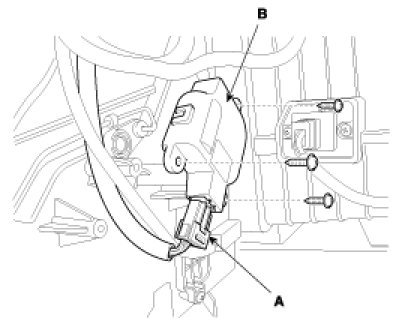

These are the factory instructions for removing the passenger side actuator on both years.
Disconnect the negative (-) battery terminal.
Remove the driver's crush pad lower panel.
Disconnect the temperature control actuator connector (A) after removing the air duct.
Loosen the mounting screw and then remove the temperature control actuator (B).
