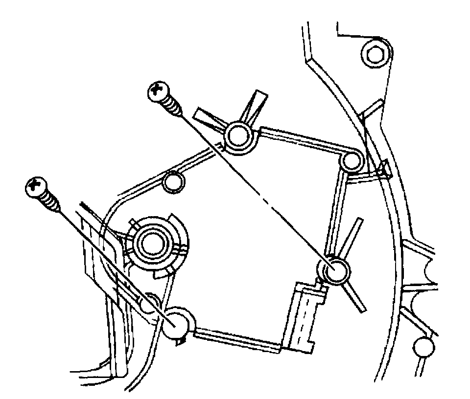

the heat works fine on my driver's side it just seems like maybe the blender to the passenger side is broken. please give me some answers it is turning winter in Montana.

Samantha, there are actuators called blend air door actuators. These actuators open and close doors in the HVAC system based on the temperature you want in the vehicle. Since the right side isn't properly working, my first suspect is that the actuator has failed.
Here is a link that explains in general how one works, symptoms, and how one is replaced. Take a look through it.
Here are directions specific to your vehicle for replacing the actuator. The attached pics correlate with the directions.
Here is the confusing part for me. First, since heat only comes from one side and not the other, I first assumed you have a dual climate system. However, according to my manual, that isn't an option. So, please let me know if you do or do not have dual climate control.

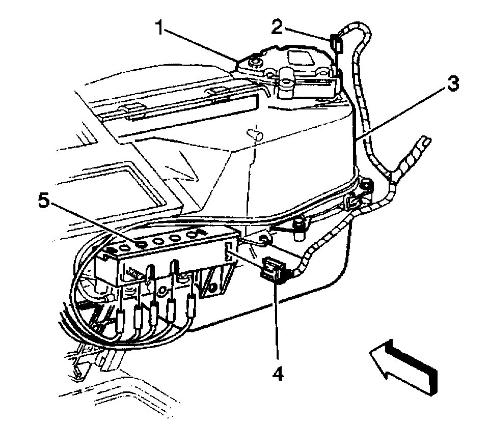

The air temperature actuator is located on the top right hand side of the heater/vent module.
pic 1
1. Remove the instrument panel carrier.
2. Disconnect the electrical connector (2).

3. Remove the air temperature actuator retaining screws.
4. Remove the air temperature actuator from the heater/vent module.
