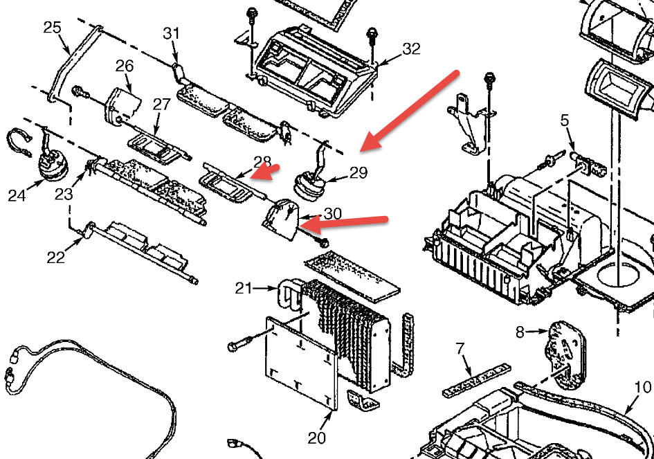

No heat on driver side, Air is blowing (.it is a dual system) cold
2001 CADILLAC CATERA
35,000 MILES • 3.0L • V6 • RWD • AUTOMATIC
LICAPETRILA

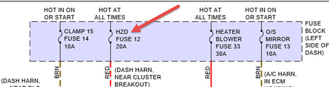

No el.power coms to driver side circulating pump-to passager side does and the pump works.
I do not know were the fuse or relay for it is located, I do not have a el diagram.

check for a vacuum leak then pull fuse with key on for 60 seconds it may reset actuator then if still not working have it scanned for codes.
