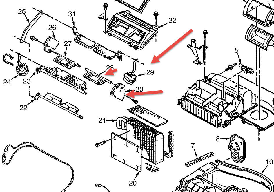

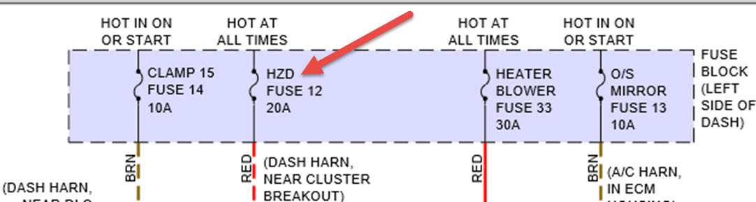

No el. Power coms to driver side circulating pump-to passager side does and the pump works.
I do not know were the fuse or relay for it is located, I do not have a el diagram.

Check for a vacuum leak then pull fuse with key on for 60 seconds it may reset actuator then if still not working have it scanned for codes.
