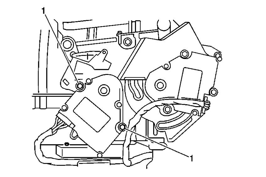

Selecting heat, passenger side got heat but none on driver side.
Oct 31, 2018 at 10:55 AM
CARL WAGNER
No heat at driver side but heat on passenger side.
Oct 31, 2018 at 11:09 AM
Good afternoon.
The is a blend door actuator on the left side for heat and cold. It is under the dash above the fuel pedal.
Procedure and picture below.
1. Remove the left side sound insulator.
2. Remove the left air temperature actuator retaining screws (1).
3. Remove the electrical connector from the left air temperature actuator.
4. Remove the left air temperature actuator.
