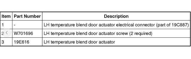

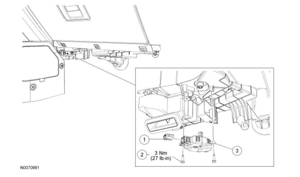

As far as the drivers side, there is a blend door actuator. Can you hear the door move when you change from cold to heat?
Removal and Installation
NOTE: The LH temperature blend door actuator is present on dual-zone Electronic Automatic Temperature Control (EATC) vehicles to control the LH temperature blend door only. Vehicles equipped with Electronic Manual Temperature Control (EMTC) are not equipped with this actuator. For EMTC vehicles, refer to Temperature Blend Door Actuator - RH See: Air Door Actuator / Motor, HVAC > Removal and Replacement > Temperature Blend Door Actuator - RH.
1. Disconnect the LH temperature blend door actuator electrical connector.
2. Remove the 2 LH temperature blend door actuator screws.
- To install, tighten to 3 Nm (27 lb-in).
3. Remove the LH temperature blend door actuator.
4. To install, reverse the removal procedure.

Remove it and see if you can turn the door manually and see if you can get heat.
If you can, then yes, it is the actuator. If no, then most likely an issue with door in the case.
