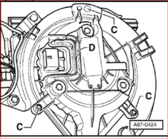

It does not blow out anything through the vents. I have changed out the blower motor, relay fuse, put in a new thermostat, changed out the coolant, checked all fuses and still nothing. My climate control turns on but I can push all the buttons I want to turning up heat or down to defrost but no air, no nothing. However, my rear defrost works. I cannot seem to figure out what the problem is.

It sounds like you are having a problem with the blower motor module/resistor. I've attached a picture of its location on the side of the hvac box on the right hand side.Here is a tutorial for you to view for the blower motor replacement.
https://www.2carpros.com/articles/blower-fan-motor-works-on-high-speed-only
Hope this helps and thanks for using 2CarPros.
