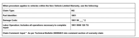

Hello - LeahB Wow, thanks for the outstanding update/information. We don't always get the info we ask for so detailed. Okay, just a few things based off of what you have said. First, there is a Technical Service Bulletin (TSB) out on a similar thing. I have attached that for your review. It actually states: "Customer concern of no heat or noticeable drop in heat output in passenger compartment from HVAC system when engine at idle" This is due to the plastic plug as shown. I put the TSB at the end of this. Next - on the pic below there are two hoses between numbers 1, 2, 13. At idle, is the hose between 1 and 13 the one that is hot and 1 and 2 the one that is cool?
https://images.2carpros.com/forum/automotive_pictures/248015_125787940_1.jpg

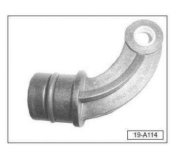

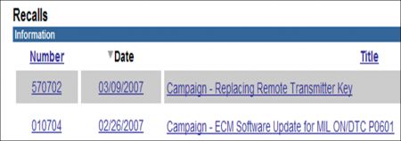

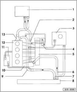

I would first check the plug that the TSB talks about. Even try and replace and see what you have. Next - I would back flush the heater core. If that doesn't work then you may have to replace the core. I am hoping it is just the plug from the TSB and worst case, a back flush if not the plug. You don't have a lot of miles - that is about 6,000 a year...not much driving. Looks like you may have some recalls on your vehicle. The dealer may fix these for free. Please contact the dealer service department, give them the VIN number of your car and have them check on these to see if they apply to you. I have attached those at the end. Last, for Auto Zone etc...sometimes your car can throw a code, the light flash and go out. You might consider that when talking to them in the future. 19 07 01 March 26, 2007 2009949/3 Supersedes Technical Service Bulletin Group 19 number 05-03 dated Apr. 8, 2005 due to revision of a part number.
https://images.2carpros.com/forum/automotive_pictures/248015_1_100.jpg
Vehicle Information Coolant Leak or No Heat in Passenger Compartment From HVAC Condition Coolant Leak or No Heat in Passenger Compartment From HVAC System Technical Background

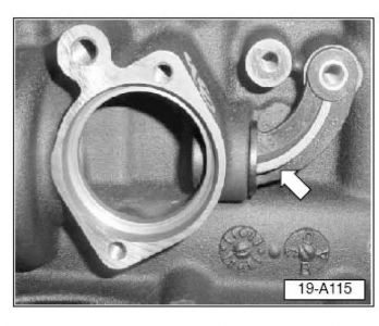

Customer concern of loss of coolant, but no leak in cooling system can be found. ^ Customer concern of no heat or noticeable drop in heat output in passenger compartment from HVAC system when engine at idle. Both concerns may be caused by a coolant leak from plastic plug.
https://images.2carpros.com/forum/automotive_pictures/248015_3_48.jpg
Plug is installed in engine cylinder block near connection for thermostat housing (arrow). Improved Coolant Plug. Service Other than loss of coolant, a leaking plug can cause air to enter into the cooling system and reduce the effectiveness of the passenger compartment heating system. ^ Cooling system MUST be tested for leaks with engine cold (below 32 °F / 0 °C) (see ElsaWeb Repair Manual, Engine Mechanical, 19 Engine Cooling, " Cooling system, checking for leaks "). Tip: The leak from this plug usually occurs only when the engine is cold (below 32 °F / 0 °C). If cooling system is tested for leaks with engine warm or hot: ^ Leaks from this plug may not be detected. Tip: Coolant leak from this plug can be sometimes misdiagnosed as a leaking coolant thermostat housing. Always carefully inspect suspected areas to detect the actual source of the leak. ^ Carefully inspect area where plug is located. If the plug is found to be leaking: ^ Remove and replace the plug. Required Parts and Tools ^ Remove sound insulation below engine. ^ Drain coolant (see ElsaWeb Repair Manual, Engine Mechanical, 19 Engine Cooling, " Cooling system, draining and filling"). ^ Remove upper engine cover. ^ Unfasten coolant reservoir and move to aside. Electrical connector of coolant level sensor must be unplugged. It is not necessary to remove coolant hoses from coolant reservoir. ^ Remove oil dipstick bracket bolts (2x). ^ Carefully remove upper dipstick tube (orange plastic) Ensure that the O-ring on lower steel tube is not lost when tube is removed). ^ Remove bolt from plastic plug. ^ Remove plastic plug from engine block . ^ Install a new plastic plug and secure with bolt to engine block. Fastener torque = 23 Nm. ^ Reassemble dipstick tube and coolant reservoir. ^ Use the VAS 6096/1 to refill and bleed the cooling system (see ElsaWeb Repair Manual, Engine Mechanical, 19 Engine Cooling, "Cooling system, draining and filling" for details and approved coolant antifreeze). When refilling engine with coolant: ^ Always ensure that any trapped air is bled out of cooling system (including heater core). ^ Recheck for leaks on cooling system (see ElsaWeb Repair Manual, Engine Mechanical, 19 Engine Cooling, " Cooling system, checking for leaks"). ^ Reinstall sound insulation below engine. ^ Reinstall upper engine cover.

Warranty Required Parts and Tools Plug - Part No: 06B 103 033 A Tip: Part numbers listed in this bulletin are for reference only. Always check with your Parts Dept. for the latest parts information.

I'm having the same issues as stated above. No heat in idle and some heat during hi RPMs. Im not sure if the plug has been changed in this car.
Hose between 13 and 1 is hot. Hose between 1 and 2 is not.

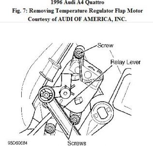

it flows out real fast with the garden hose?
https://images.2carpros.com/forum/automotive_pictures/139033_no_16.jpg
this temp door motor works perfect, from cold to hot? i will keep looking and see what else i can find.

Well at least we crossed the heater core off of the list.... I will take the arm off and try opening and closing manually... to be sure.. we are geting closer

Just to be sure is the arm I am looking for located near the middle of the console under dash?
