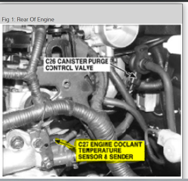

why no have meter for engine temperature on dashboard?
May 18, 2019 at 4:46 AM
SCGRANTURISMO
  • 4,897 POSTS
Check your Engine Coolant Temperature Sending Unit. I have included its location in the diagrams down below for you. It's easy to change out. Just unplug the electrical connector, inspecting it for broken are frayed wires, unscrew the sender from the block/cylinder head and reinstall the new one and reconnect the electrical connector. That's it. Please let us know what you are able to find out.
