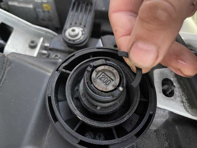

I also checked the cap on the coolant expansion tank and found this, do you think it would affect anything?
Jan 3, 2025 at 2:04 AM
  • 55,609 POSTS
Yes, it could make the engine overheat. are both heater hoses hot when the engine is warm? If not, I would look at the heater core being clogged or the heater control valve. Also, these cars have a water pump just for the heater.

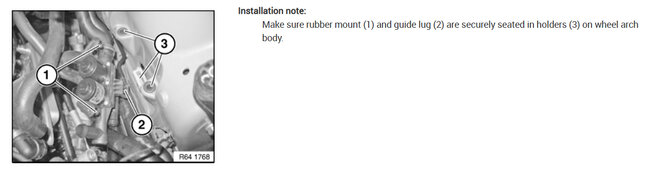

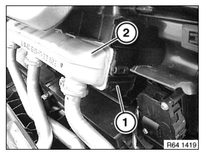

There are 3 hoses going into the firewall, all 3 I think come from the heater control valve, how would I know which ones to feed water to see if it comes back out from another hose?
Jan 3, 2025 at 4:09 AM
  • 55,609 POSTS
It looks like all three go to the heater core. So, all of them should be hot. Check out the images (below). Let us know how it goes.
Jan 4, 2025 at 3:04 AM

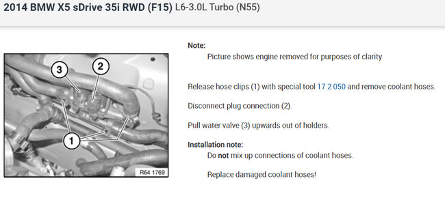

BHAMDOC1973
  • 2,007 POSTS

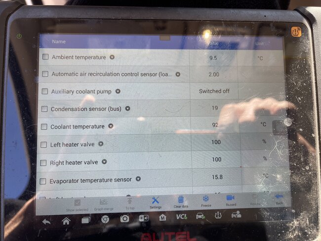

I swapped the valve control and got some heat after waiting few minutes, ill check it more after i get this vac hose swapped which broke while replacing the control valve.
Jan 6, 2025 at 3:07 AM
  • 55,609 POSTS
Okay, it sounds like you may have fixed it. time will tell.
