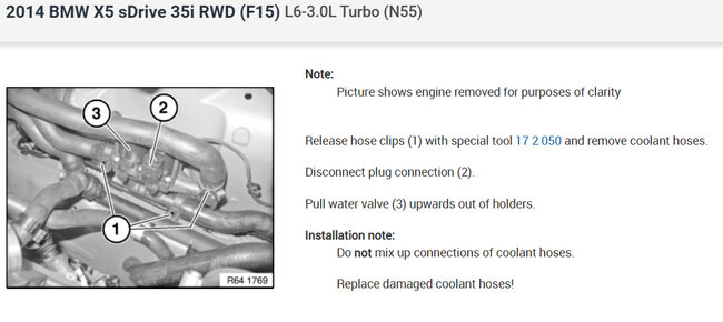

If when the other engine went out if they used head gasket sealer it could of clogged up the heater core so I would remove the heater hoses and try a flush, also, these car had a problem with the heater control valve for the heating system so I would check that at it as well, here is the location and a video to help go over failure issues as well.

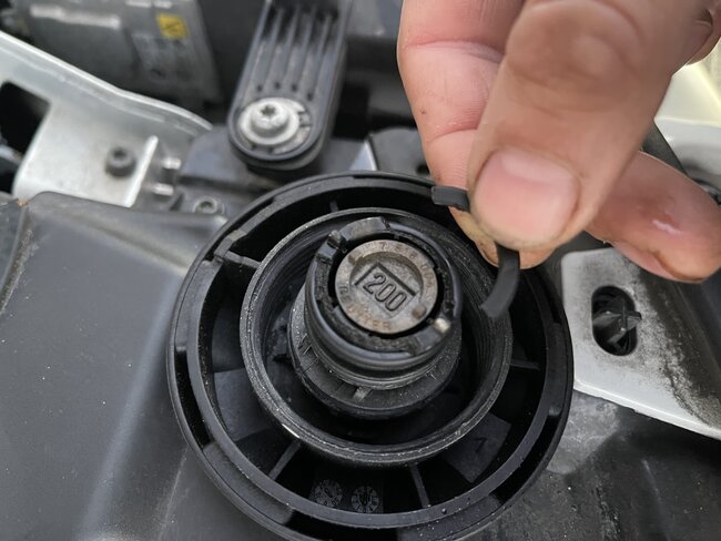

I also checked the cap on the coolant expansion tank and found this, do you think it would affect anything?
Jan 3, 2025 at 2:04 AM
  • 55,433 POSTS
Yes, it could make the engine overheat. are both heater hoses hot when the engine is warm? If not, I would look at the heater core being clogged or the heater control valve. Also, these cars have a water pump just for the heater.

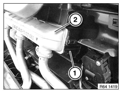

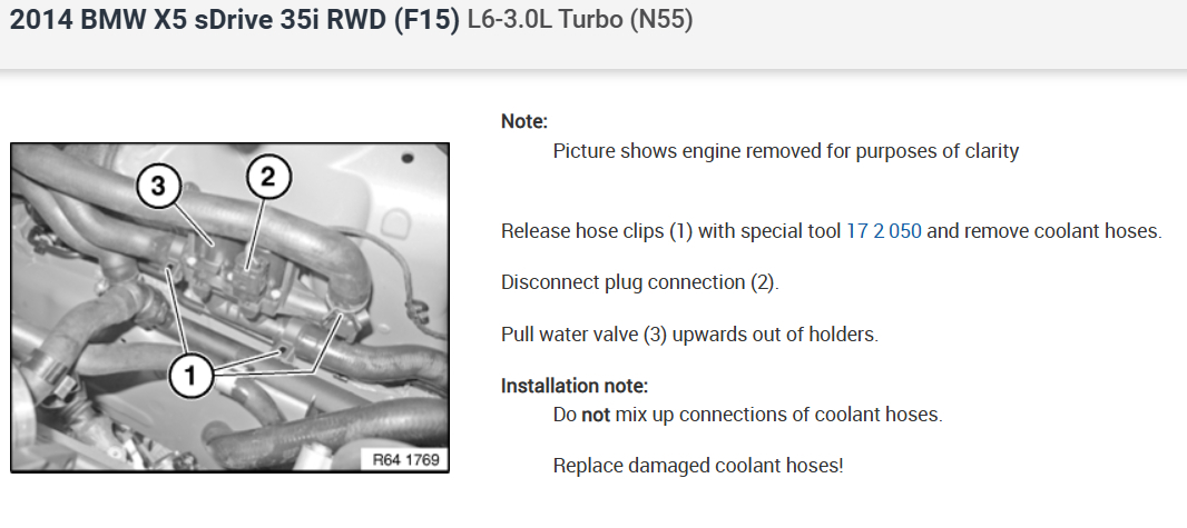

There are 3 hoses going into the firewall, all 3 I think come from the heater control valve, how would I know which ones to feed water to see if it comes back out from another hose?
Jan 3, 2025 at 4:09 AM
  • 55,433 POSTS

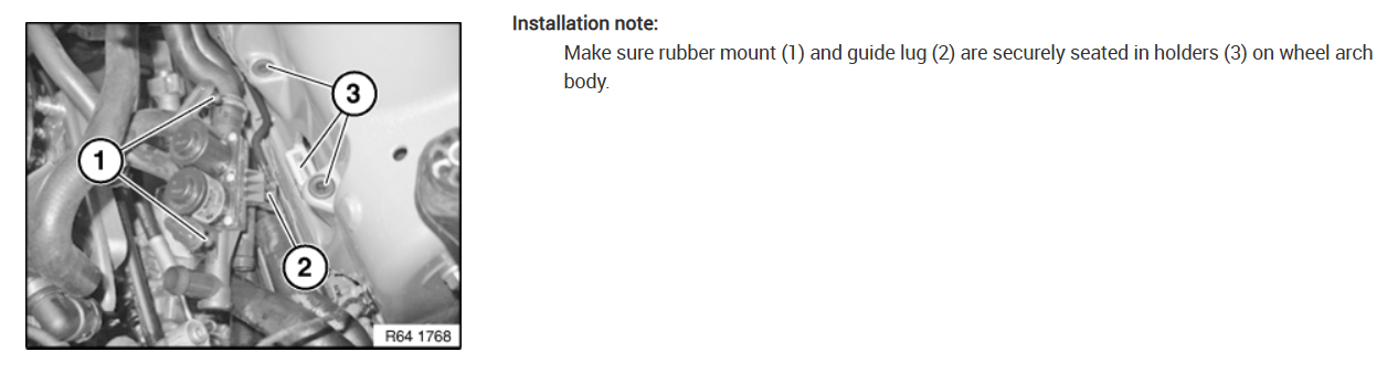

It looks like all three go to the heater core. So, all of them should be hot. Check out the images (below). Let us know how it goes.
