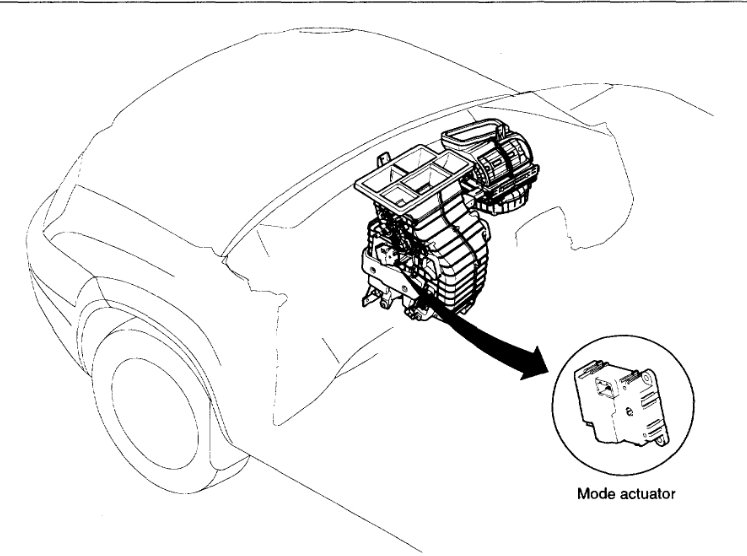

As the temperature has began to drop around here so did the heat in my wife’s car. First only high speed would work but that was an easy fix and replaced the blower motor resister. That is fixed however she is only getting hot air from the driver side vent. The center two vents are warm and the passenger side is cold. Even when I switch to defrost the driver side is hot passenger side is cold same when I switch to the floor. All the actuators seem to work visually. I have only located 3. This vehicle does not have duel climate control so i assume it only has 3 actuators associated with the heater/AC. 1) mode actuator 2) temperature actuator 3) fresh or cabin air actuator. Everything I see online about this issue points to the blend door actuator however they all seem to have dual climate control so I’m confused if this would be my problem since mine doesn’t. Some say it could be the heater core being clogged but I am getting hot air however only on driver side. The amount of air is consistent through all vents so nothing clogged in the vent. I am stumped and could really use some help in identifying my problem. I assume since I don’t have dual temperature control that air would simply pass trough one main vent than through all 4 front vents equally. Does the temperature actuator still control each vent separately even without dual temperature control. Sorry for the book but I am hoping you all can help. Thank you so much.
Nov 11, 2019 at 8:10 AM
DANNY L
  • 5,648 POSTS
Hello, I'm Danny.
Yes, it sounds like you're having an issue with the blend/mode door actuator.It is a small electrical motor that controls air flow through specific ducts in the HVAC box.It might be worn/defective and not able to finish the full range of travel to get all vents fully open.Here is a tutorial showing what is involve in its replacement:
I've attached 2 pictures below showing the HVAC box and the actuator location.Hope this helps and thanks for using 2CarPros.

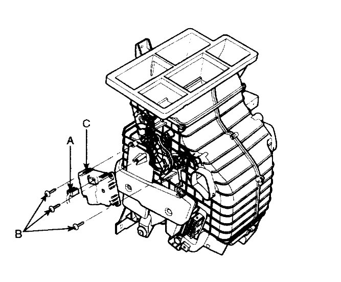

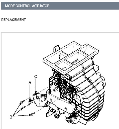

Thank you so much Danny. It seams everything is pointing to the blend door. I just don’t understand air systems in cars, lol. So sorry for my confusion. Is the mode door actuator the same as blend door? From the diagram It looks like the one I see at the bottom of driver side. It controls the defrost, face vents, floor vents etc.? Am I correct?
Nov 11, 2019 at 11:27 AM
DANNY L
  • 5,648 POSTS
Hello again.
Yes, You are correct. I sent you a picture of its location on my last response including a quick tutorial on how to replace.Let me know if you have any further questions on this.Hope this helps.

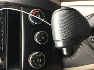

Hey sorry for my confusion as I am trying to understand the full operation of the mode door. The air moves correctly as I adjust from floor to vents to defrost (which is the purpose of the mode door actuator). The problem is the heat is only traveling to the driver side vents and cold air continues to come out of the passenger side. (I would believe this would be the temperature actuator). I enclosed a picture of my control panel. Please correct me if I am wrong as perhaps the mode door does more than just changing airflow.

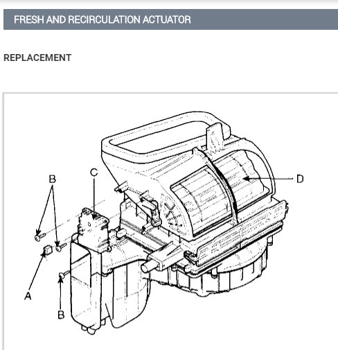

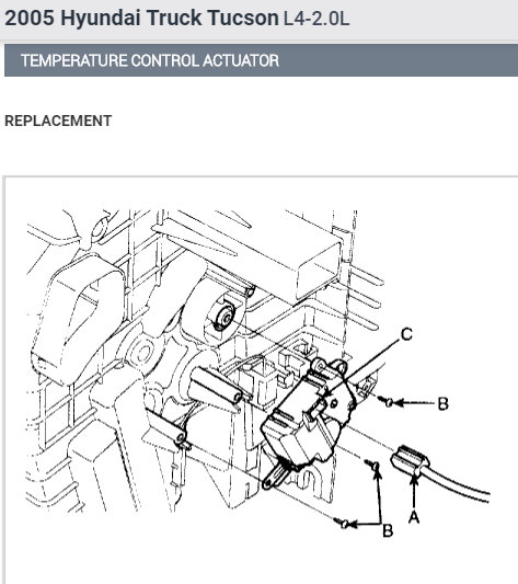

So the new mode actuator came in today. I installed it and no difference. It still gets hot on driver side and cold on passenger side. It just seams so odd to me. Air comes out just fine so nothing is blocked. The power of the air slightly drops consistently along all 4 front vents when heat is turned on leaving me to believe the flow is correct. Please help me what do I try next? I flushed the system this past summer after having a hose bust. So I don’t believe anything would be clogging the heater core. Any ideas?
Nov 13, 2019 at 3:22 AM
DANNY L
  • 5,648 POSTS
Hello again,
There are only 3 actuators in your HVAC system. I've attached pictures of the 3 actuators below. You've already seen the mode actuator.Hope this helps and thanks again for using 2CarPros.
