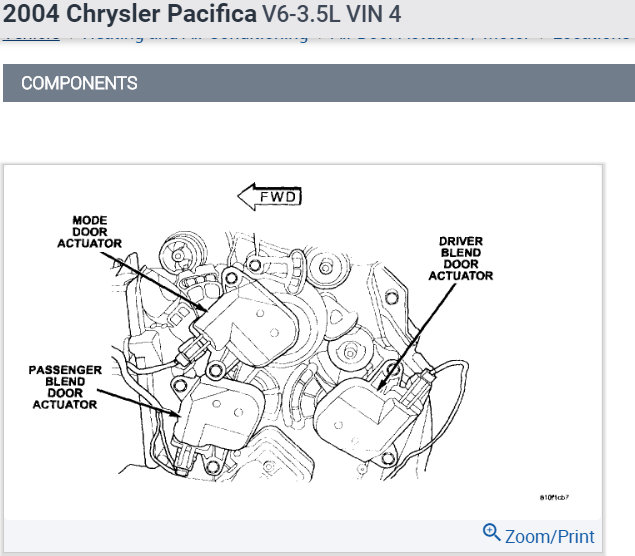

My digital display for the A/C and heater went blank then shortly the heater only puts out cold air. Checked antifreeze and fuses. The fan works fine just not any heat.
Aug 13, 2018 at 1:22 PM
  • 55,224 POSTS

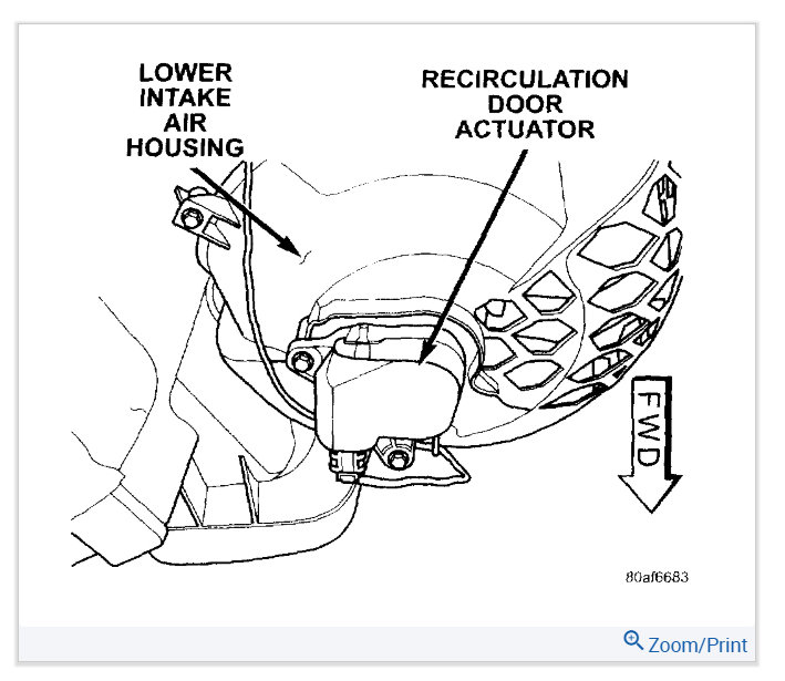

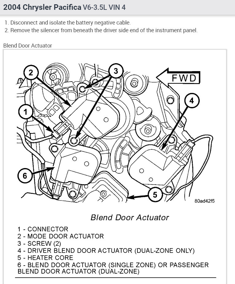

Please check the heater hoses to make sure they are hot going into and out of the fire wall if so it sounds like a temperature blend door actuator is not working right. Here is a guide to show you what you are in for when doing the job and diagrams below to show you how it will be for your car:
