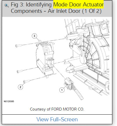

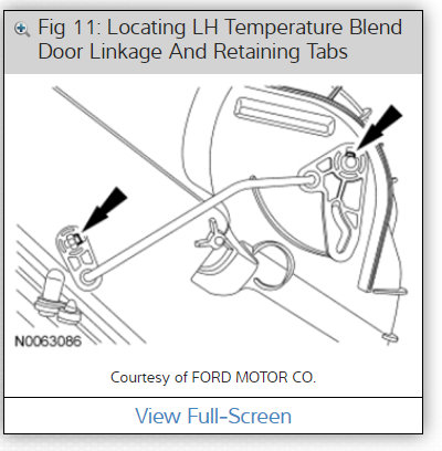

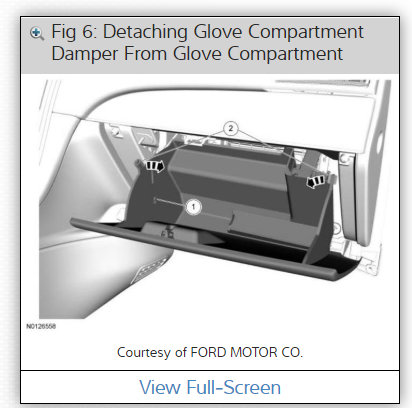

In July I replaced an actuator on the passenger side due to no A/C on drivers side and A/C was on passenger side. Now I do not have heat on drivers side but there is heat on passenger side. Could this be the same actuator messing up again or is there another one on the drivers side and if so where is it located?
Oct 22, 2018 at 12:26 AM
  • 55,721 POSTS

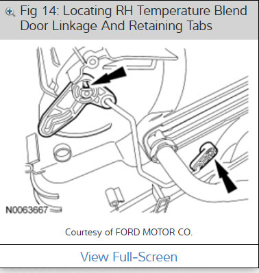

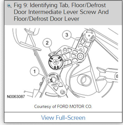

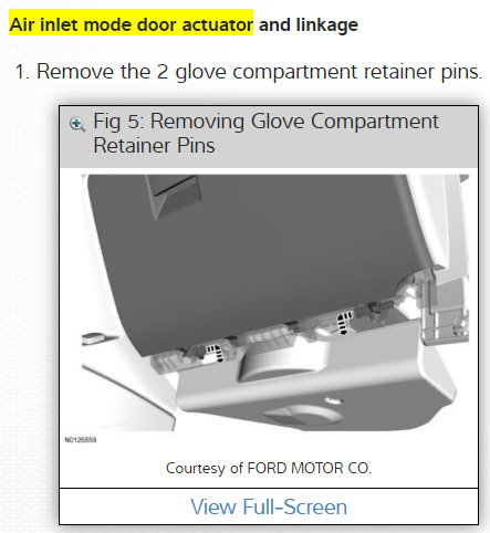

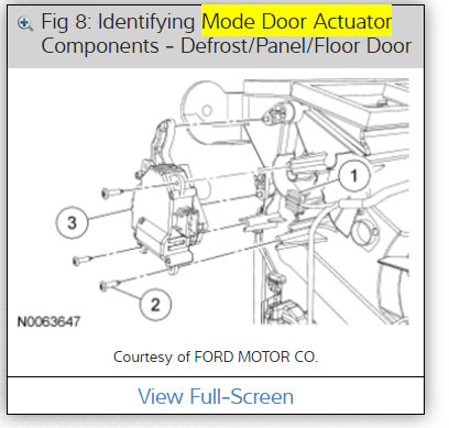

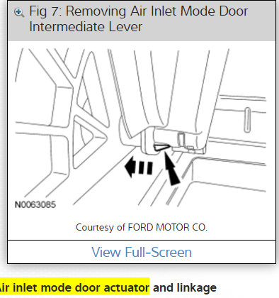

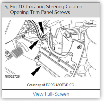

Was the actuator a ford replacement part? Aftermarket actuators have a tendency to go bad quickly. Here is the guide to help you see if the actuators are working and the location of all the actuators for your car:
Remove the actuators to see if they work. Check out the diagrams (below). Please let us know what happens.
