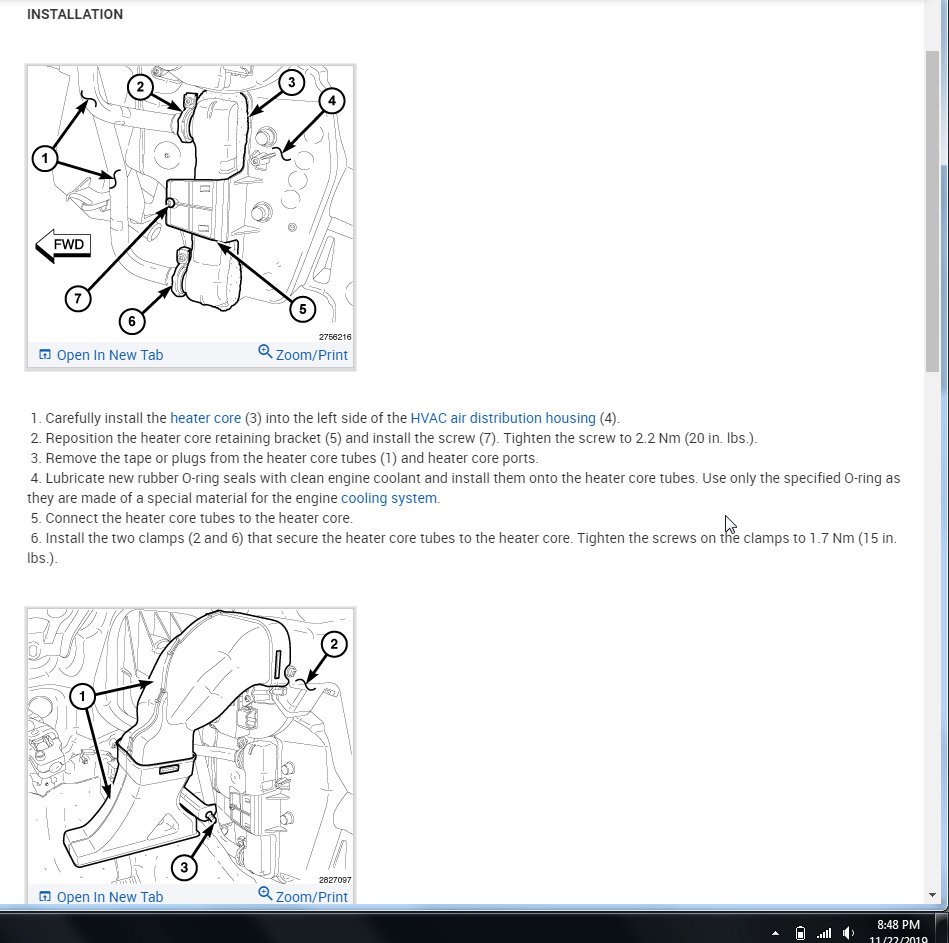

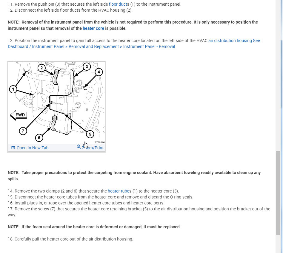

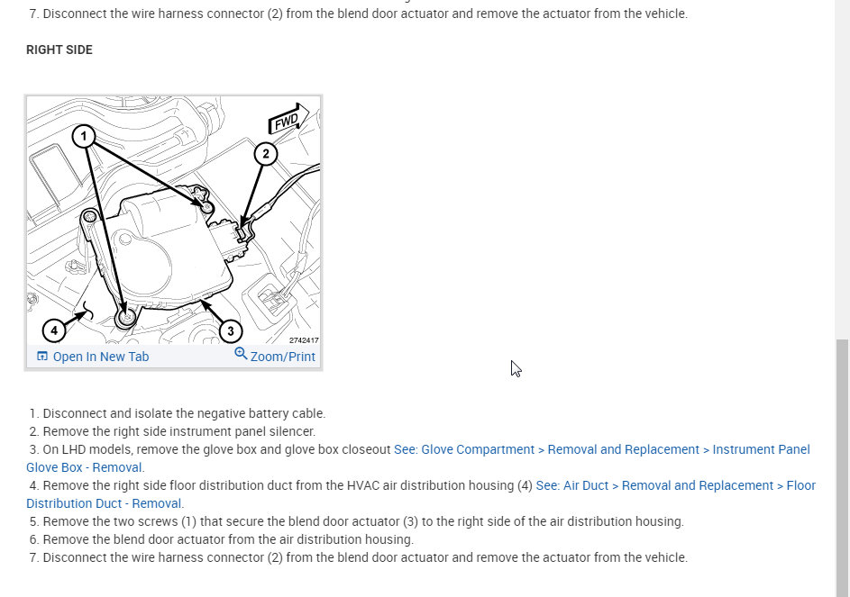

Engine comes up to operating temperature and vehicle has no heat in cabin. Other days it heats up just fine. On a day it did not have heat I accelerated very hard and moments later I had heat and continued to have heat that day. Next day no heat.
Nov 22, 2019 at 3:19 AM
This is one of two things in my mind. Either the heater core is plugged partially or the blend door actuator is not working all the time. The fact that you accelerated hard and it started working makes me think it is a heater core issue but it could just be a coincidence.
https://youtu.be/SNRb6pSwYuU
Here are the procedures for both but I would suggest starting with the actuator and go from there.
Nov 22, 2019 at 9:53 AM

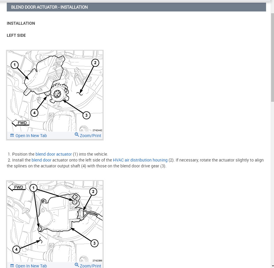

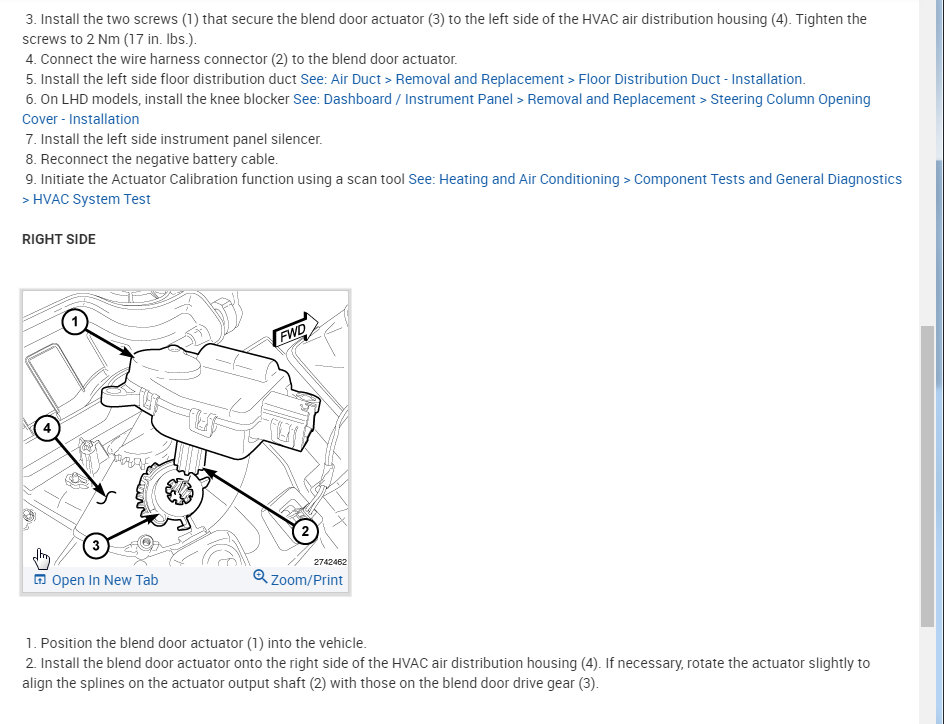

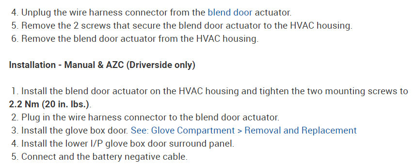

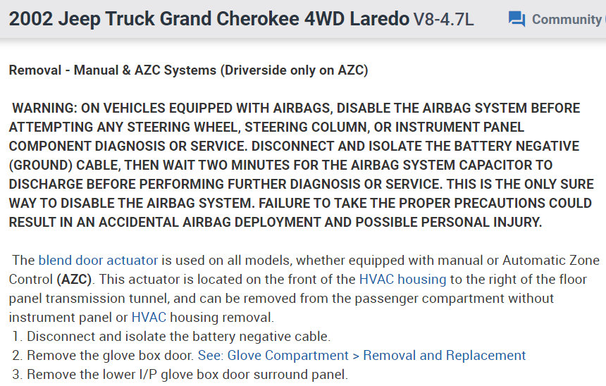

DANNY L
  • 5,648 POSTS
Hello, I'm Danny

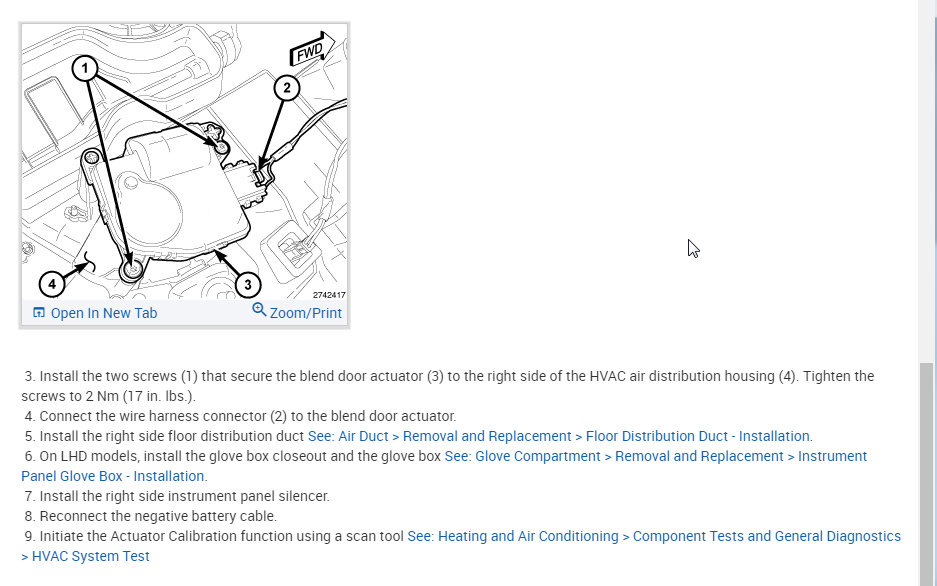

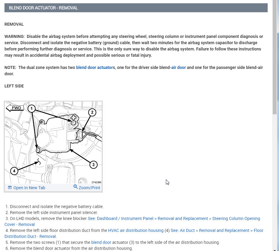

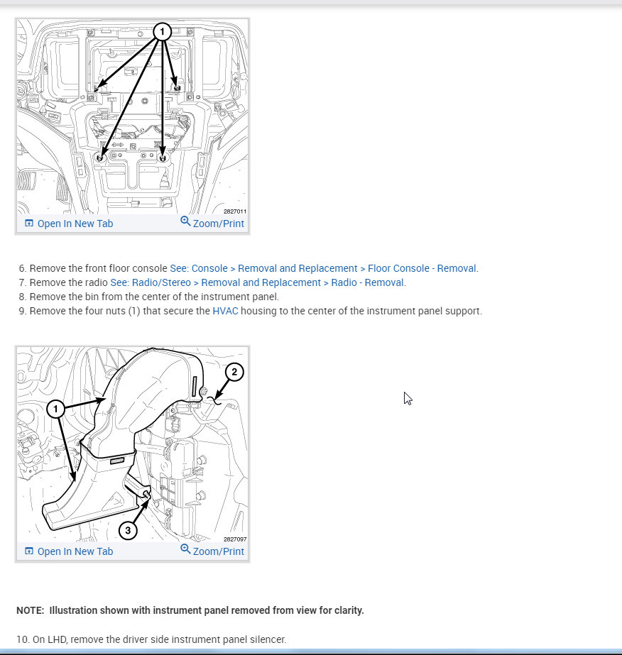

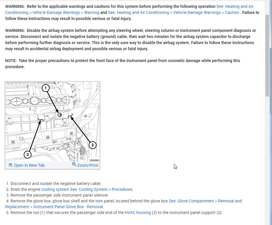

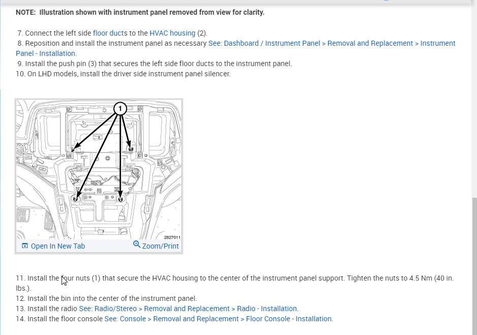

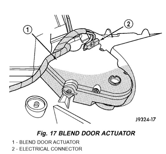

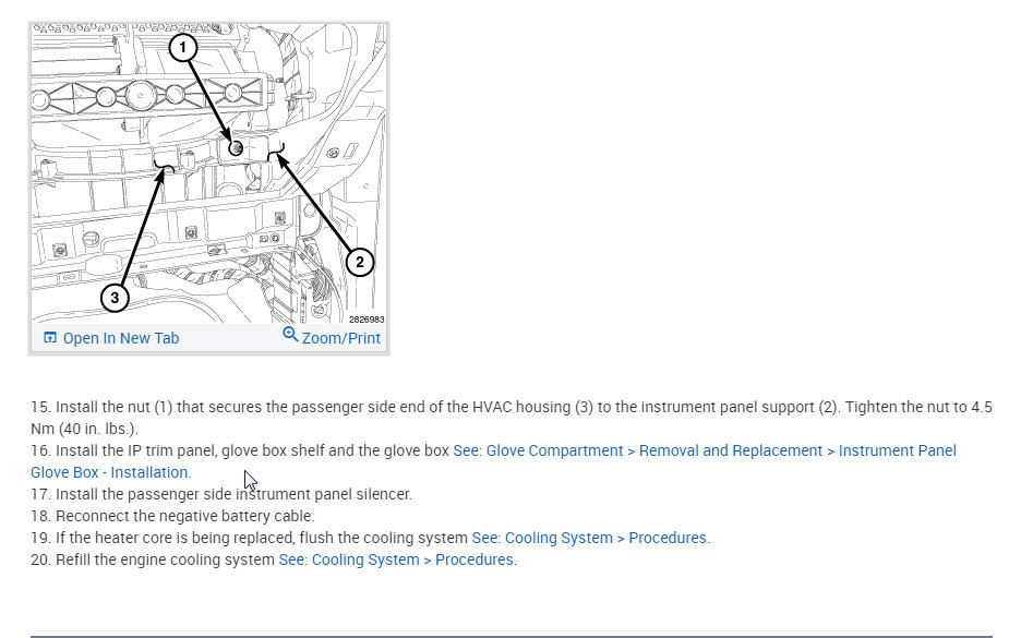

It sounds like you are having an issue with the blend door actuator. It's a small electric motor that opens and closes a door to flow hot air throughout certain air ducts. This actuator is mounted on the hvac box which located under the dash board on the right side. Here is a tutorial showing how to replace the blend door actuator.
I've attached picture steps below for the replacement of the blend actuator on your Jeep. Hope this helps and thanks for using 2CarPros.
Dec 9, 2020 at 1:12 AM (Merged)
