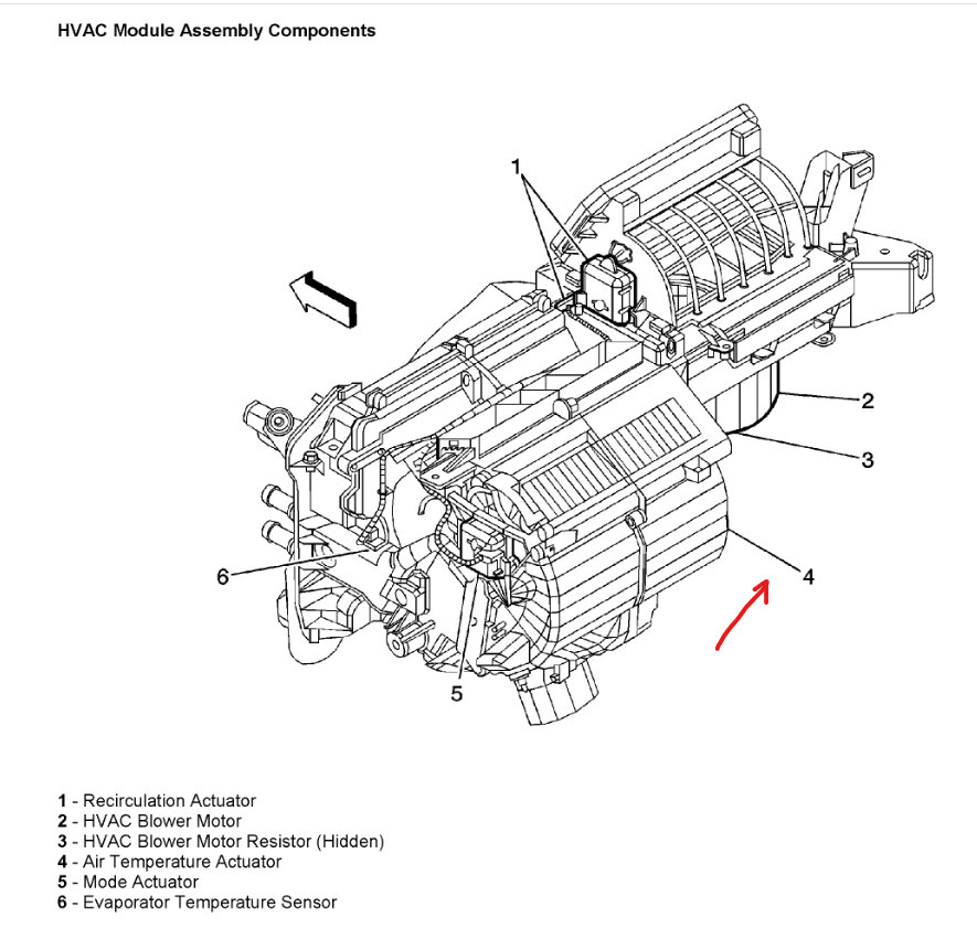

I have no heat, I replaced the thermostat, where is the blend door actuator located?
238,654 MILES • 3.4L • 2WD • AUTOMATIC
MELISSA JOHNSON2
I have no heat. I replaced the thermostat. I made sure there was enough coolant. Felt the hoses to the heater core both are hot. Bled the system. So, the only thing I can think of is the blend door or blend door actuator, but I do not know where it's located or how to get to it.
Dec 27, 2024 at 3:34 AM
  • 55,845 POSTS

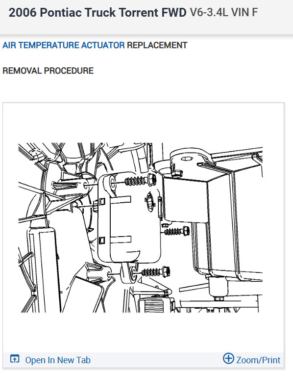

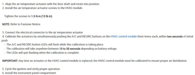

Yep, good call, that is where I would check out next as well. here is a video that can help, and I have included the location of the temperature blend door actuator as well.
https://www.youtube.com/watch?v=SNRb6pSwYuU&t
