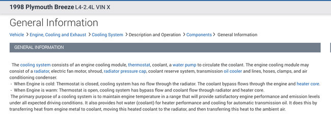

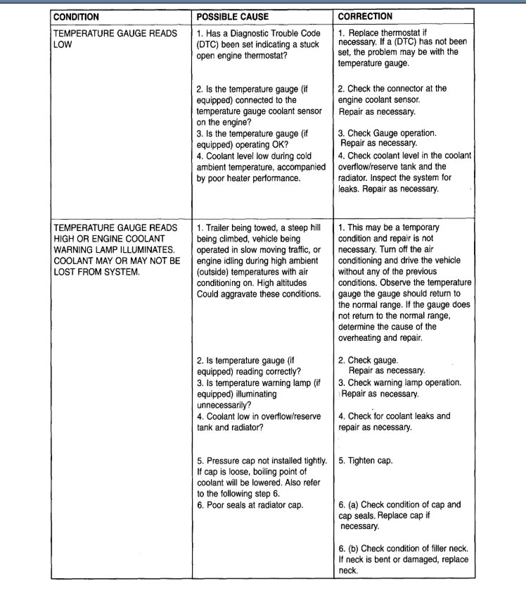

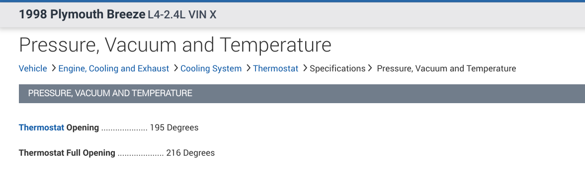

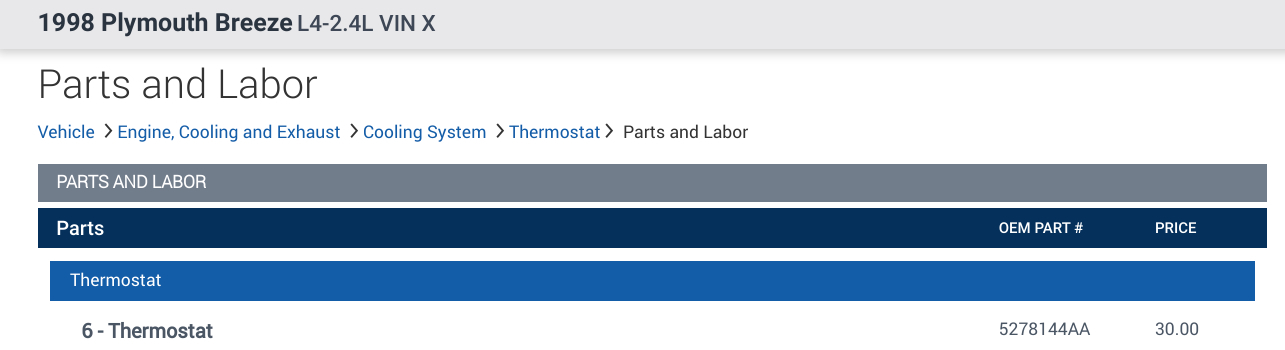

This sounds like you could have a bad thermostat right out of the box, or you may have been sold the wrong thermostat. This wouldn't be the first or last time a thermostat was bad right out of the box. In the diagrams down below I have included the Original Equipment Manufacturer [OEM] part number and the specs for the thermostat for your vehicle. Please go through these guides and get back to us with what you find out.

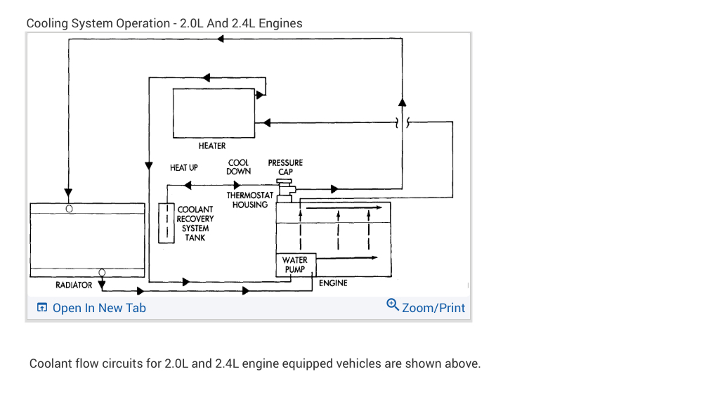

No it doesn't have a heater control valve. This is accomplished with the blend door operation. Another thing that you might want to look at is if there is an air pocket in your vehicle's cooling system this would keep your vehicle's coolant from circulating properly and could cause poor heater performance.

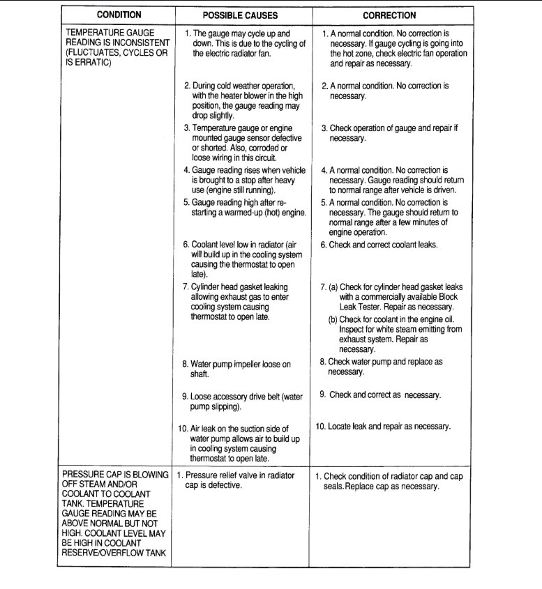

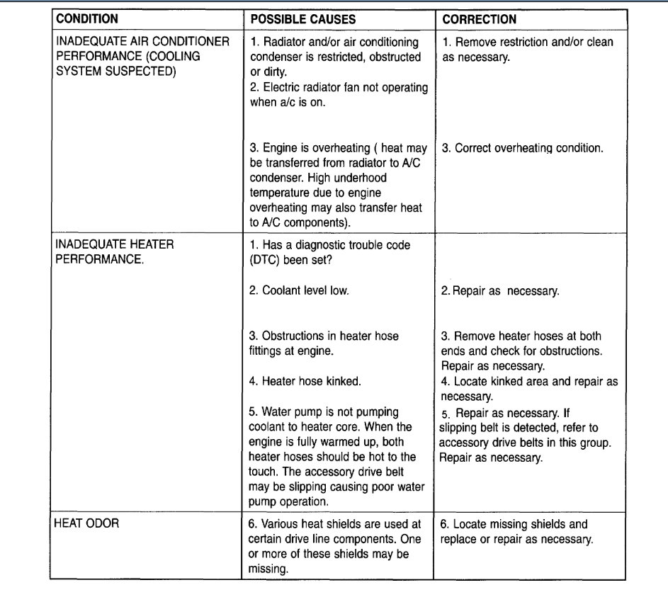

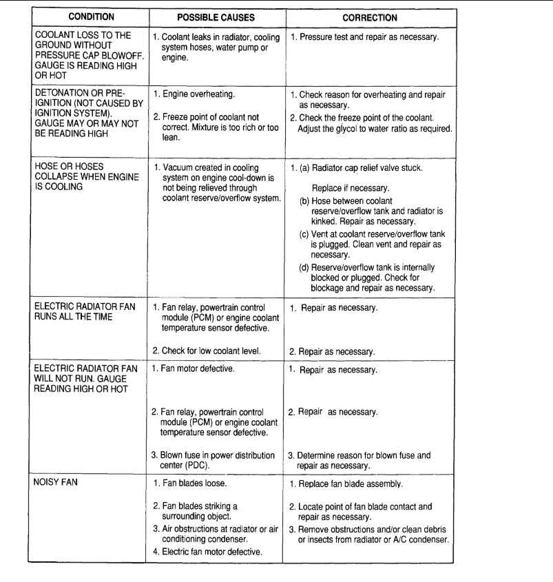

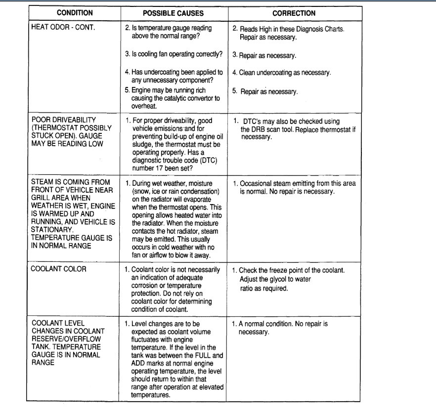

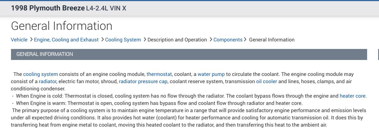

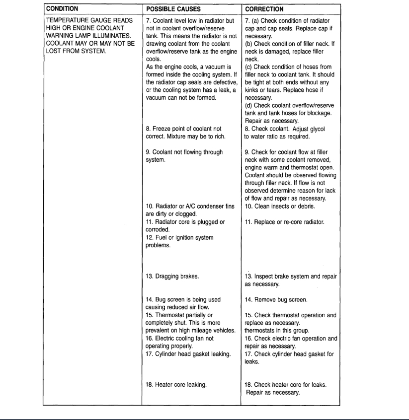

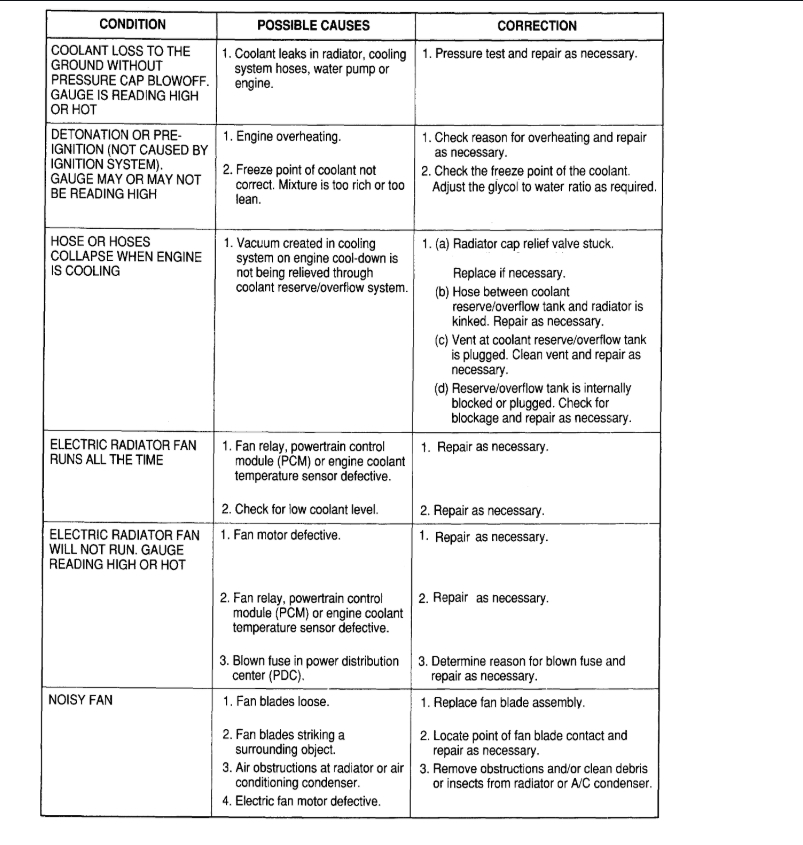

Okay, In the diagrams down below I have included a guide from the vehicle manufacturer on symptom and diagnosis of your vehicle's cooling system. Please go through this guide and get back to us with what you find out.

I would say yes. This wouldn't be the first or unfortunately the last time a part was bad right out of the box, and all the signs point to a stuck open thermostat.
