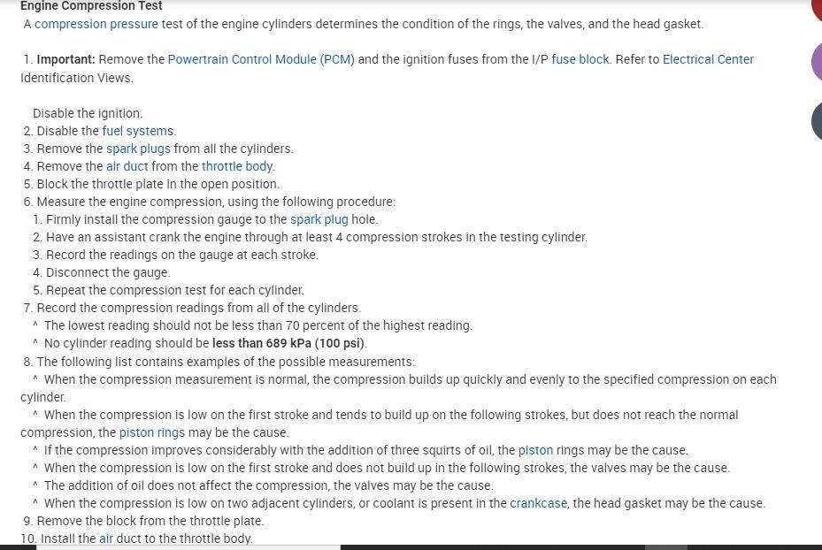

Greetings, I was told my head gasket leaking to come to this conclusion they changed the coolant and bleeding. the thermostat is okay. the heater core is okay quoted for $1,400.00 to $2,500.00. any chance could be something else?
Thank you
Feb 20, 2020 at 1:33 PM
Good morning,
Yes, it could be from a leaking head gasket allowing air into the system.
Did they do a leak down test to confirm the head gasket?
It could also be a clogged heater core as well. Did they clean the heater core?

Okay, 1 hour is not enough time to do a leak down test at all.
When the head gasket leaks, the usual indication is the gauge will go up and down constantly.
I would get a second opinion.

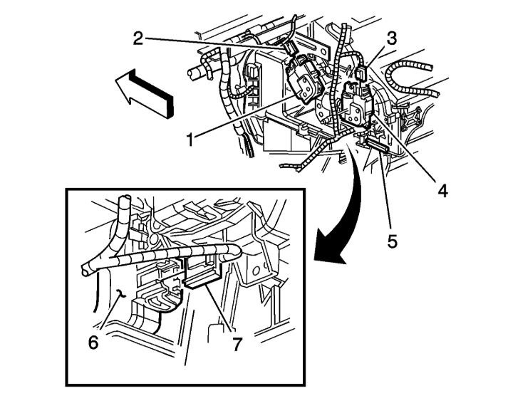

Got 2nd opinion it is the blend door was told that the dash needs to be removed (2006 Pontiac Montana SV6) big job was directed to a rapid rad .
The van does not overheat , no smoke , as how much would cost to get an estimate?

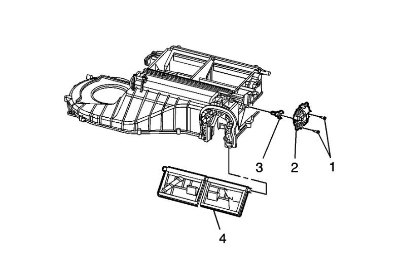

Good afternoon,
If you have a single zone which means you do not have left and right control, the dash does not have to be removed.
The estimate is not high at all. It pays about 1 hour plus the part.
1. Remove the driver side knee bolster.
2. Locate the air temperature actuator (6).
3. Disconnect the air temperature actuator electrical connector (7).
4. Remove the air temperature actuator bolts/screws (1).
5. Remove the air temperature actuator (2).
6. Remove the air temperature actuator lever (3), if necessary.
