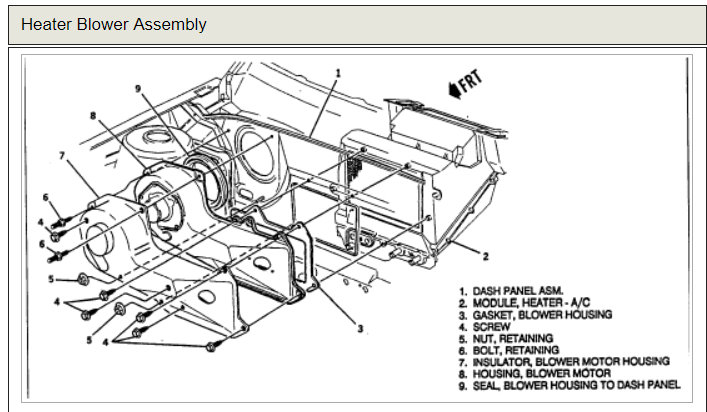

My heat only works sometimes, when I turn it on it sounds like it wants to come out but does not. It will sometimes turn on when I hit a hard bump. It really has a hard time coming on when it is super cold out.

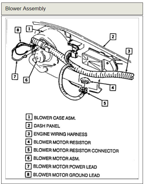

It sounds like you have a blower motor that has gone bad but the be sure lets run a simple test to see if the blower motor is getting power.
Here is a guide that will give you an idea on how to replace it and how to use a test light to check for power and ground:
https://www.2carpros.com/articles/blower-fan-motor-works-on-high-speed-only';
Remove or disconnect.
Negative battery cable.
Electrical connections from blower motor.
Partially cut blower case cover as indicated on cover.
Cutting completely around cover is not required.
Caution: Cover thickness is approximately 2 mm (1/8 in.) . Make cut just through thickness of cover. Excessive depth of cut may damage cooling tube.
Here are the diagrams on how it will be in your car.
