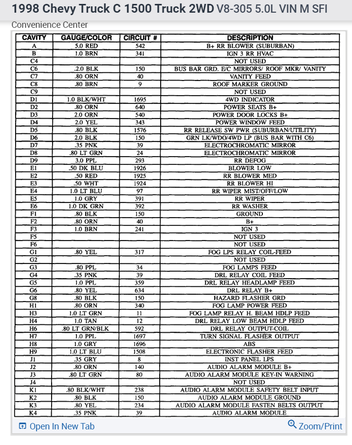

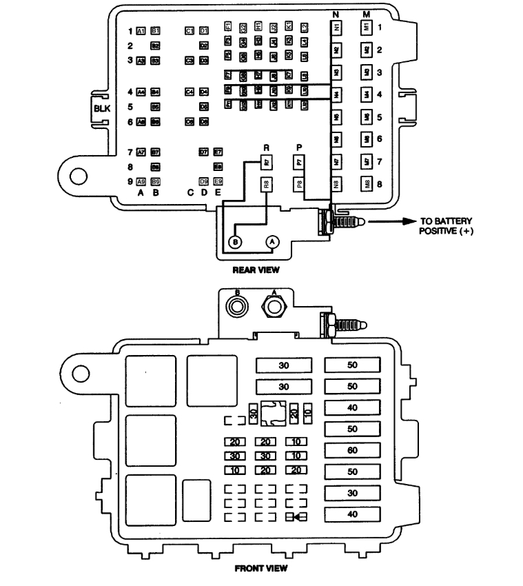

No heat or air, the lights don't come on at the control. It was working got in it the next day and nothing.
Dec 9, 2019 at 11:10 AM
Experienced Mechanic
55,560 POSTS

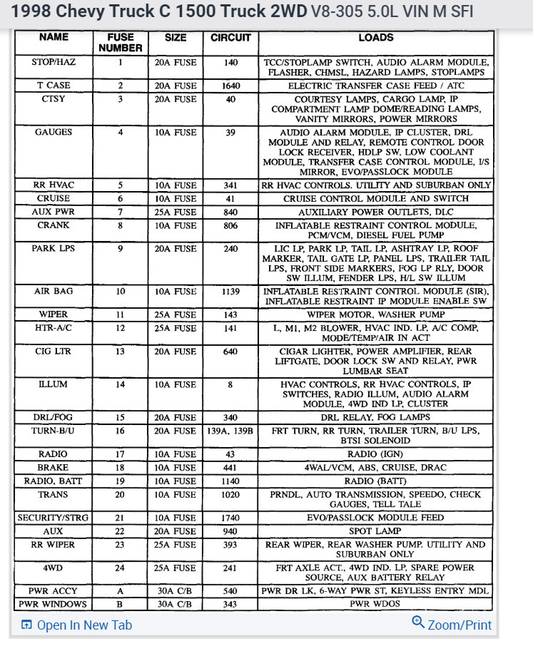

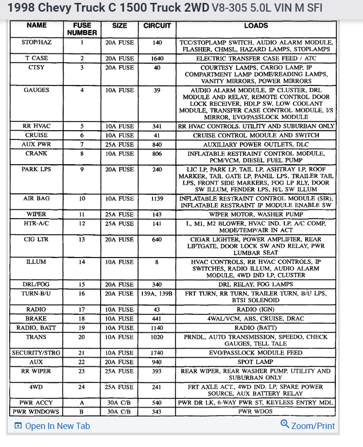

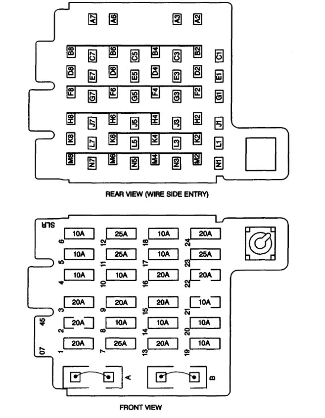

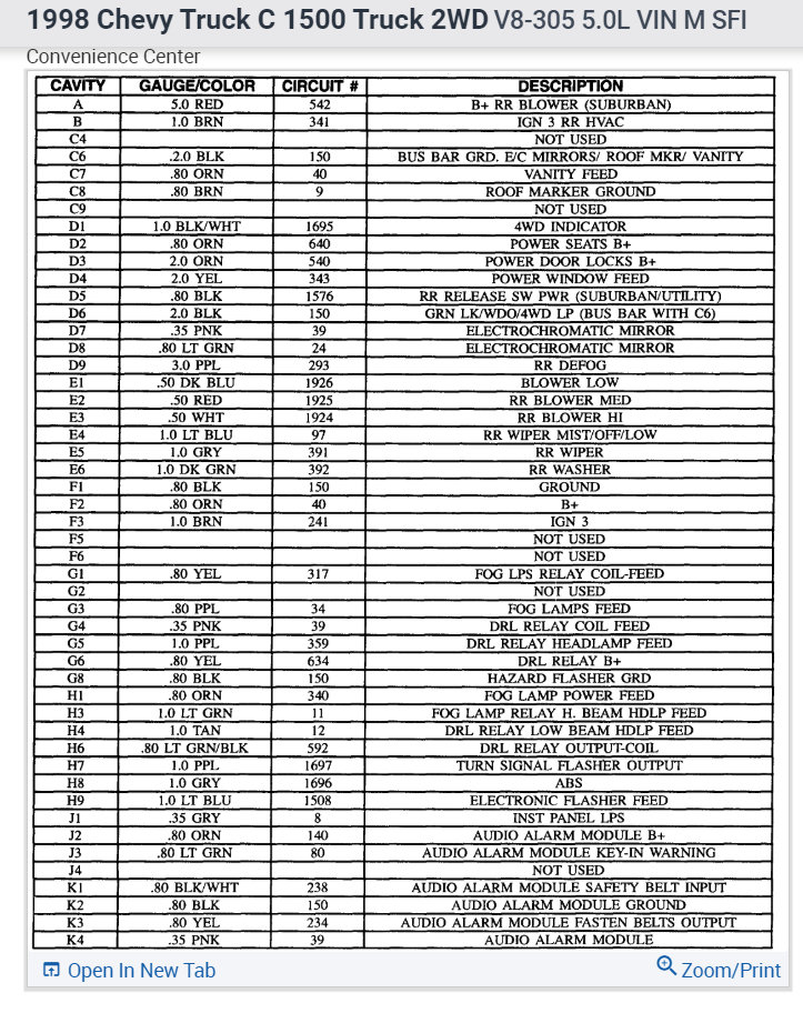

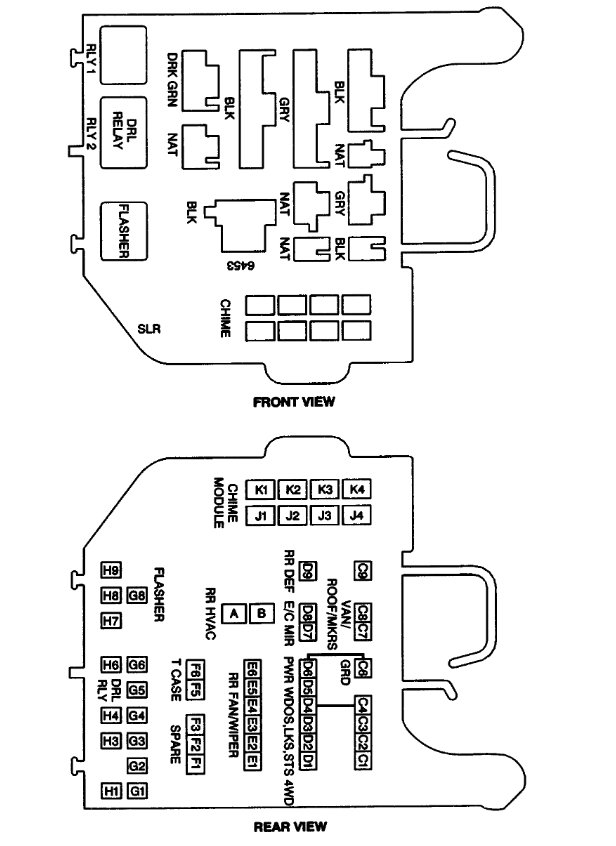

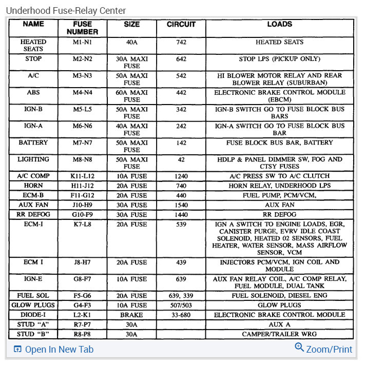

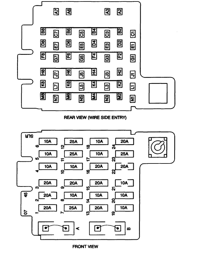

It sounds like a fuse popped. To be sure here is a guide to help us test the fuses and the fuse locations as well:
Check out the diagrams (below). Please let us know what you find.
