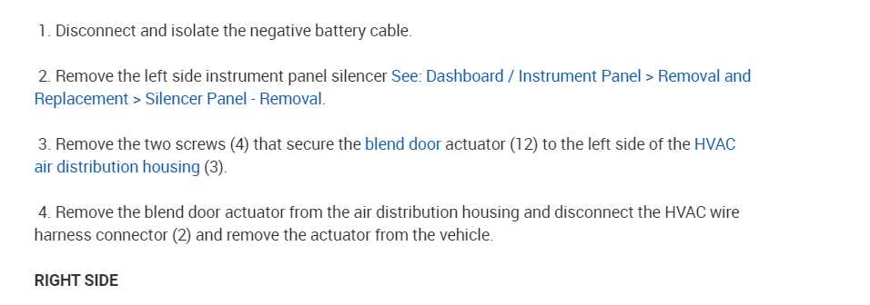

No heat on the driver's side vents
2014 DODGE CHARGER
55,000 MILES • V8 • 4WD • AUTOMATIC
KEVIN CASEY
There is heat on the passenger side vents.. I would think it would be the thermostat.

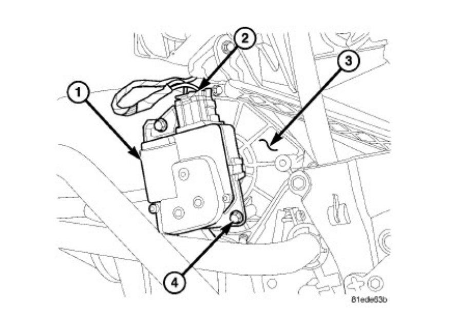

Sounds like you're having an issue with the blend door actuator.It's a small electric motor that opens a door to route air through air ducts.Here is a tutorial showing how to remove/replace.It's located on the left side of the HVAC box.
I've attached step-by-step picture instructions below for your Charger.Hope this helps and thanks for using 2CarPros.

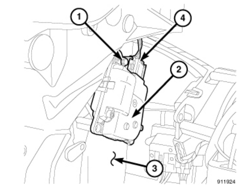

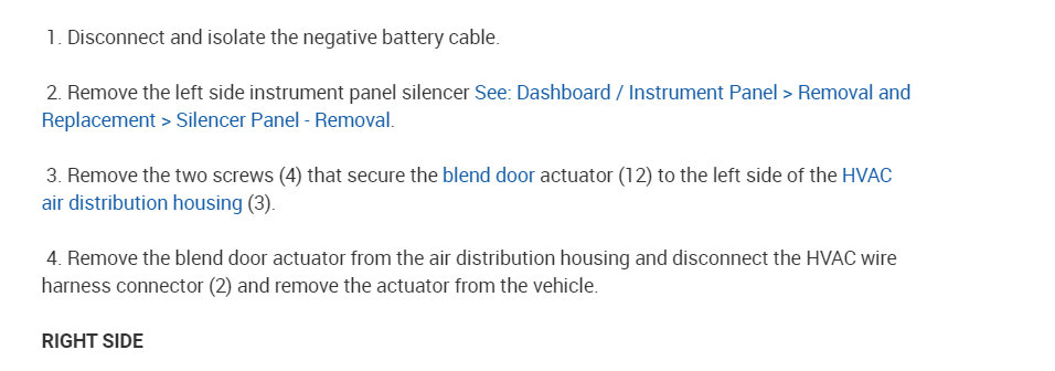

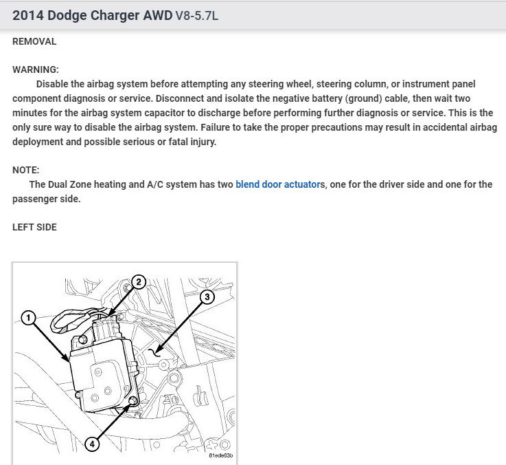

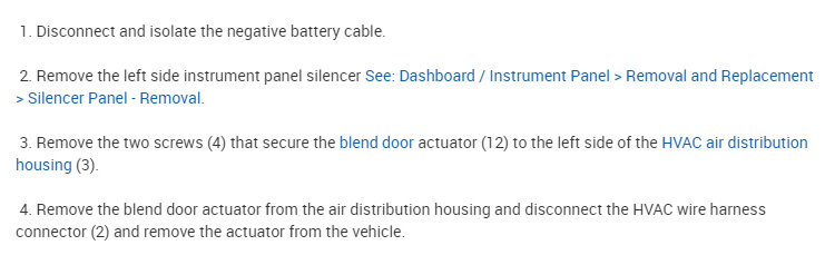

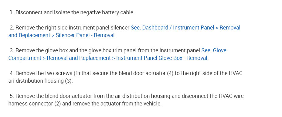

This is probably going to be a problem with your vehicle's blend door actuator. This is the motor that controls your blend door and let's the heat out of the Evap Box to get routed to the vents. Here is a link to general guide on how to replace the actuator:
In the diagrams down below i have included a guide from the vehicle manufacturer for your vehicle's blend door actuator removal and installation. Please go through these guides and get back to us with what you are able to find out.
