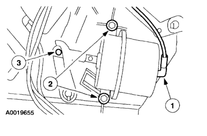

The heat does not work. when I let the engine warm up it blows out cold air on the lowest setting you feel heat but when turned up it does not work. I added antifreeze and still does not work. I am at a loss.
Oct 9, 2017 at 6:36 AM
  • 55,766 POSTS

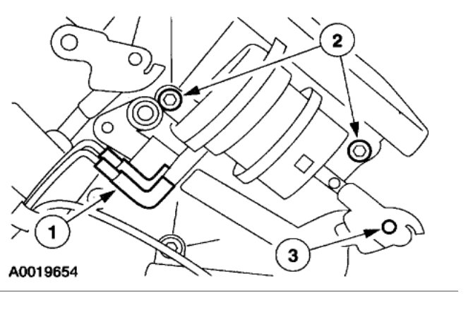

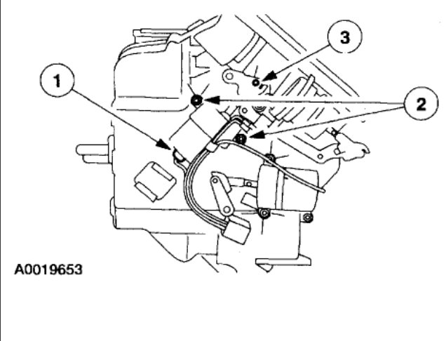

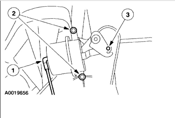

It sounds like you have a blend door actuator that is out which will keep the heater from working. Check for vacuum leaks under the hood which go to a small vacuum line headed to the firewall. This is the line that runs the system.
Here is a guide that can help as well:
Below is the blend door actuator locations on your car.
