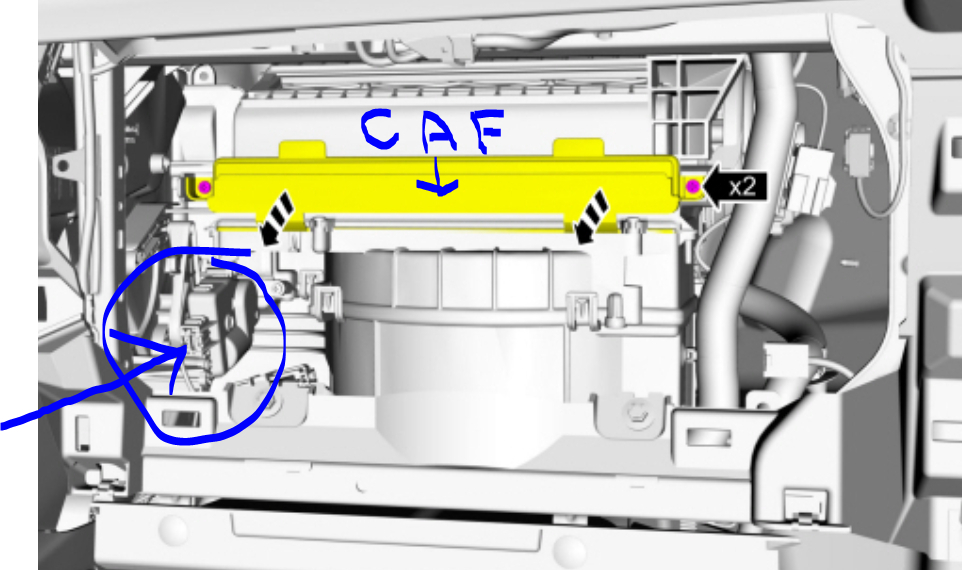

I replaced the cabin air filter. No heat from the heater, the A/C works fine. Any ideas? Everything worked good before.
Feb 21, 2024 at 2:38 AM
  • 110,240 POSTS

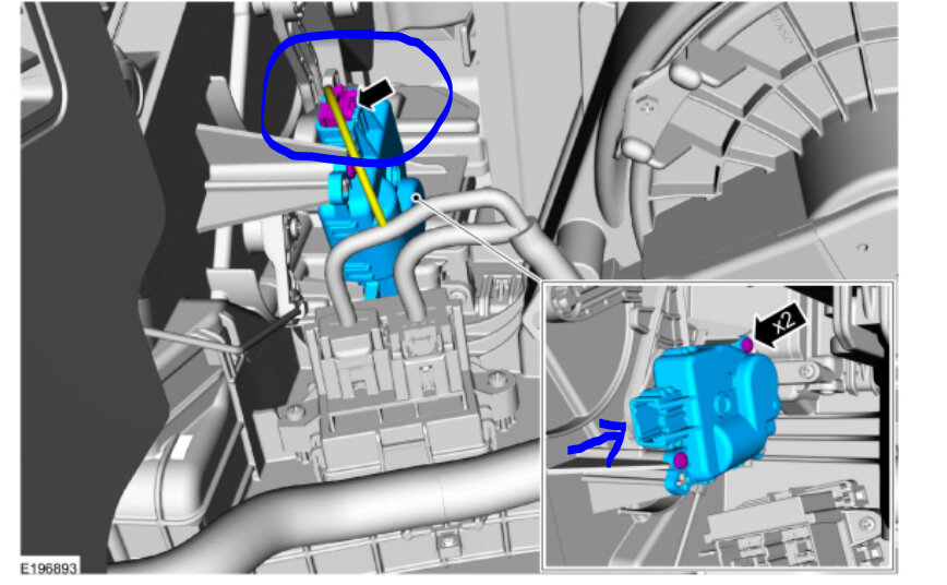

The air temperature door actuator is near the cabin air filter. There is a chance it was disconnected. I attached two pics below. The first one shows the cabin air filter location in relation to the actuator. Pic 2 simply shows the actuator connector.
Check to see if that is loose, disconnected, or damaged in any way. That is what controls the air temp entering the vehicle.
