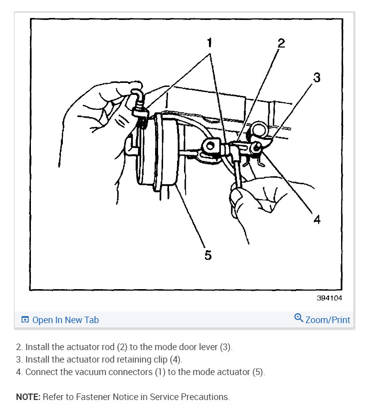

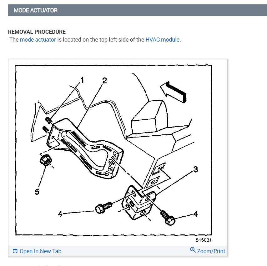

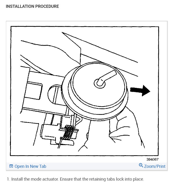

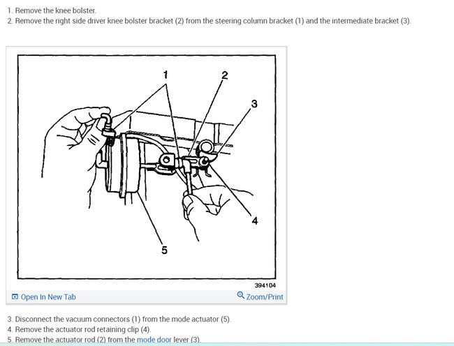

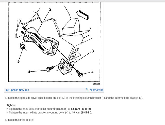

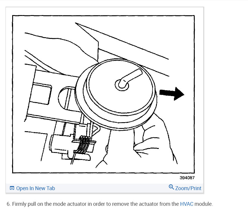

When you say "Both sides of the heater core feel the same temperature" do you mean as hot as the radiator hoses? You may have a heater core that is plugged up or the mode actuator is not working. here is a guide to help us fix it and I have included the mode actuator location so you can check it out:
Check out the images (below). Let us know what happens and please upload pictures or videos of the problem.
