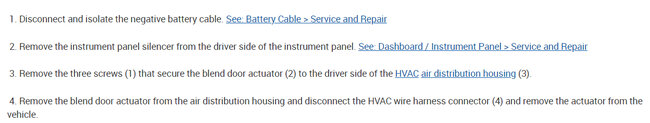

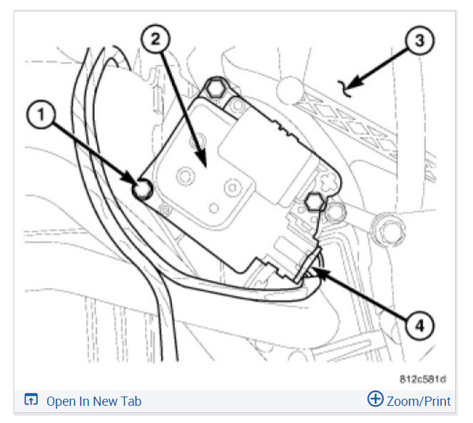

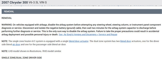

If this doesn't work, then I would replace the temperature blend door actuator but first with the engine warm grasp both heater hoses to see if they are warm as well. Please go over this guide to help:
here is the location of the actuator that controls the heat. Check out the images (below). Let us know how it goes.
