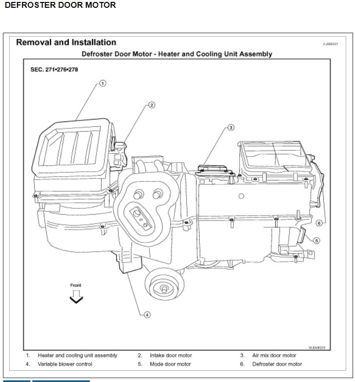

No heat, cooling is fine, no leaks on passenger side. i changed out thermostat both lines to heater core is hot so what is wrong? Please help.
Jan 2, 2018 at 7:21 PM
  • 55,433 POSTS

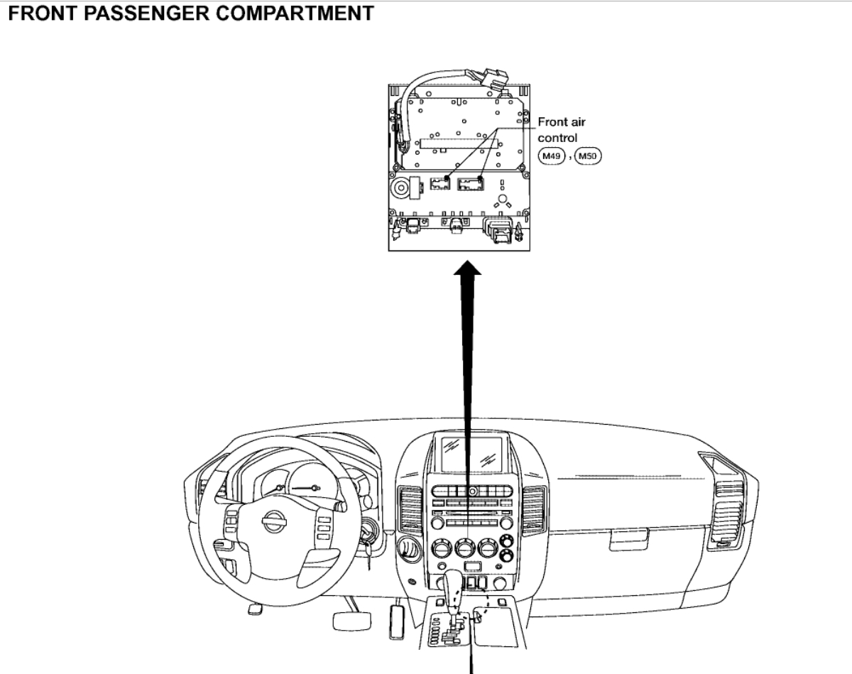

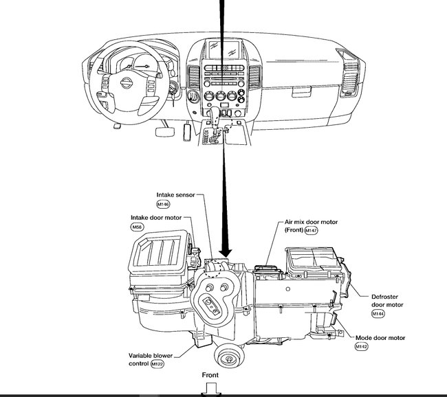

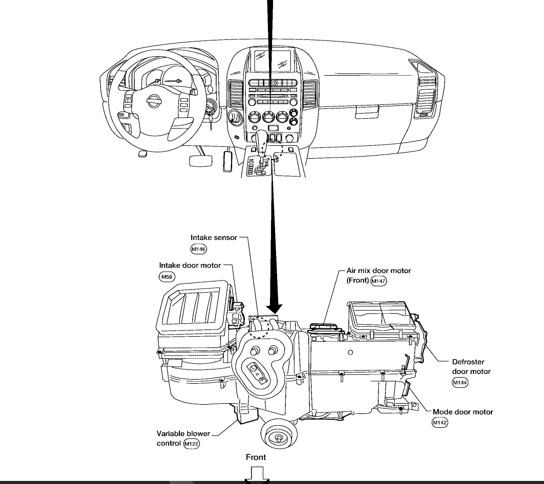

This sounds like a classic temperature blend door actuator that is not working.
Here is a guide to help us see what you are in for when changing the actuator out:
This guide may help as well:
Here is how to change the part on your car (below).
