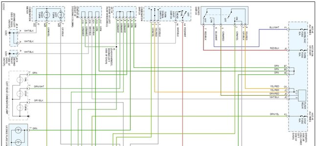

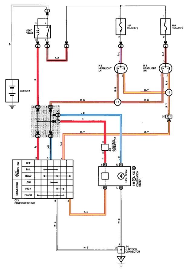

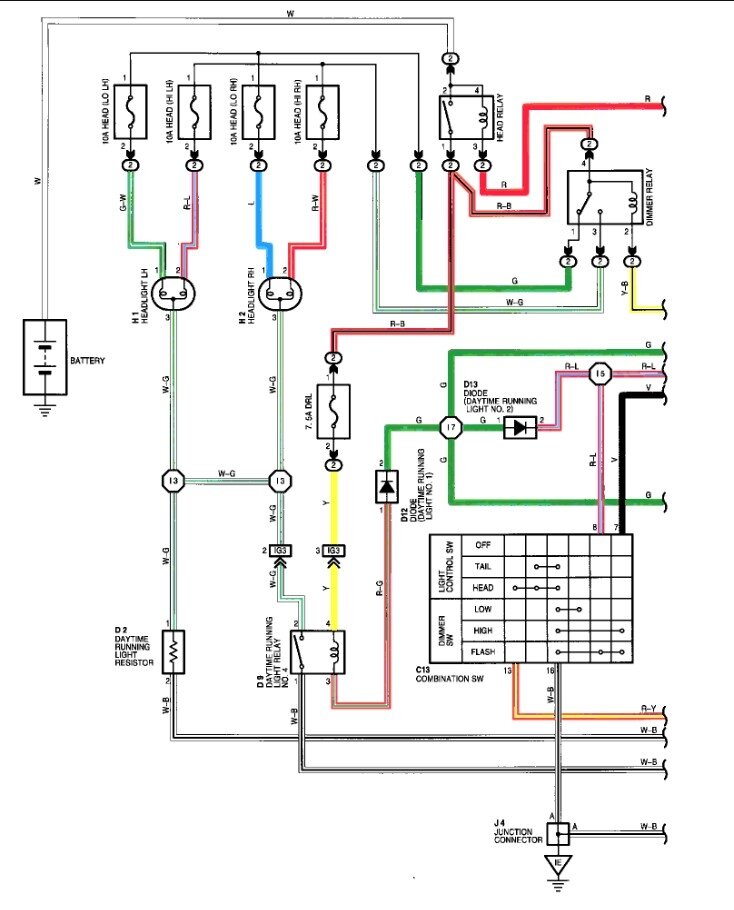

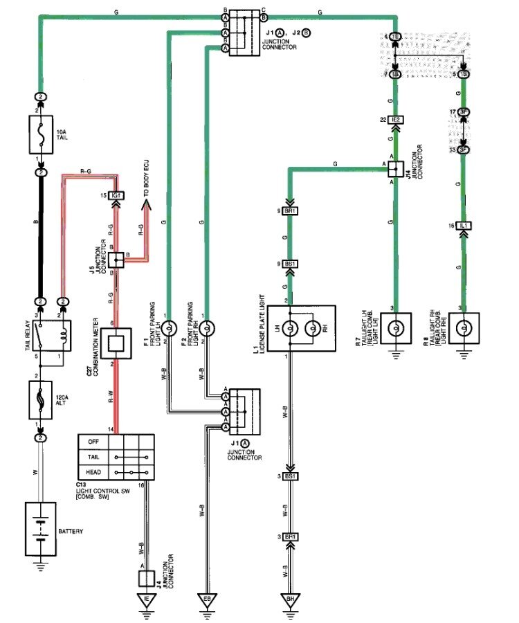

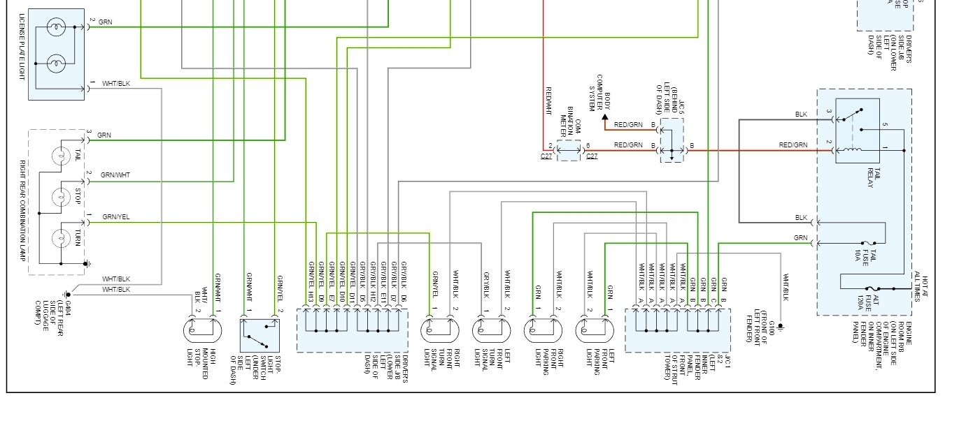

No headlights, taillights or turn signals work.
Dec 18, 2022 at 10:31 PM
STEVE W.
  • 15,357 POSTS

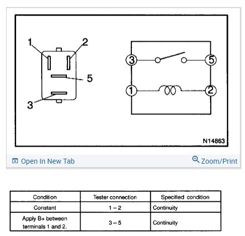

With all of those out I would start looking in the fuse and relay box. There are different power feeds for the lights, but most are fed in that box through a couple relays. I would use a test light to start testing the fuses and relays in that box.
The only other common item is the light switch.
