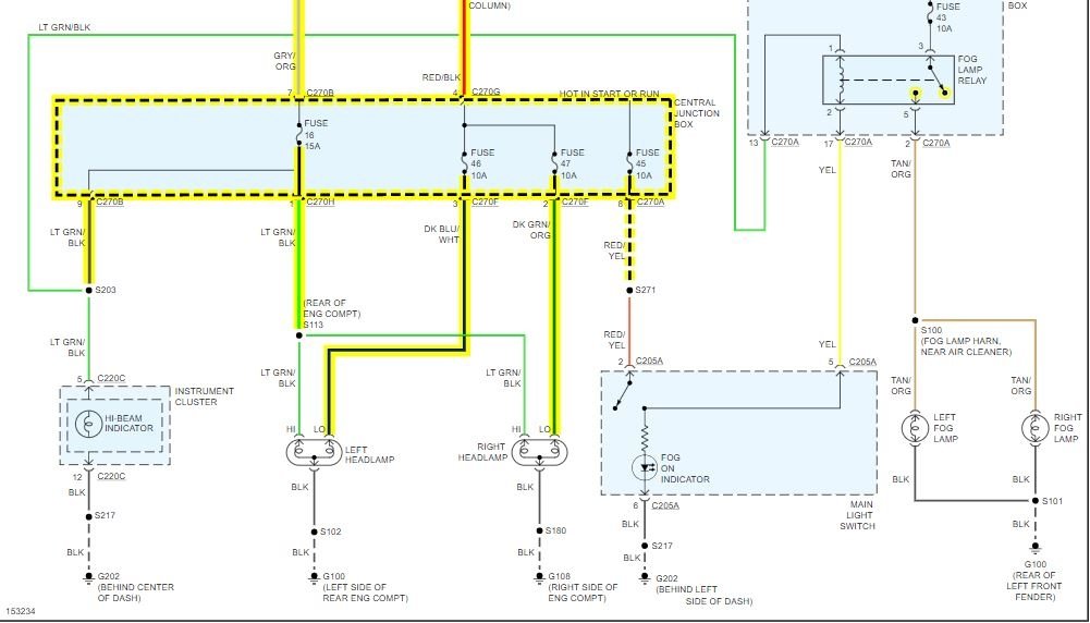

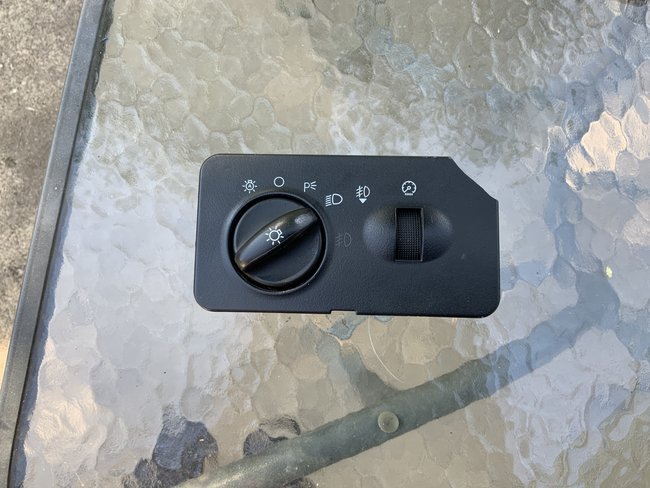

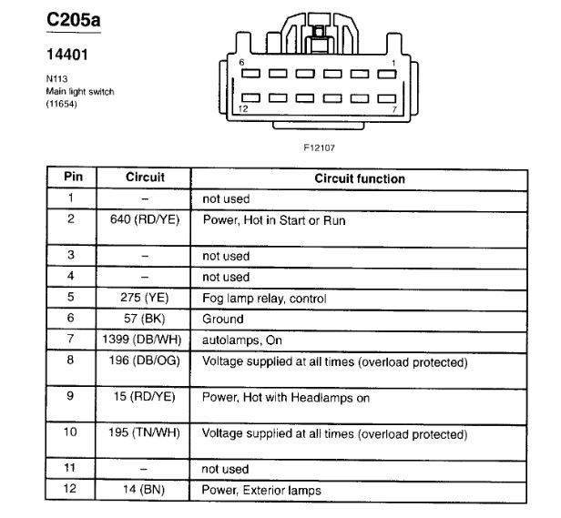

I have recently found a split ground wire from the alternator and the power cable to the starter rubbing through on the chassis. Both issues have been fixed. What I have remaining are the power door locks not working, the key-less entry not working, and the headlights do not work when toggled. I have running lights and high beams but when I switch to headlights, there is nothing. The attached picture shows the position in which the headlights do not turn on. High beams, flash to pass, and fog lights all work.

I attached a wiring diagram for you to view.
Do you have a test light or voltmeter for some testing?
We need to do testing at the relay.

I have a multi-meter. And the power wire on the starter was rubbed through arcing on the chassis, not the alternator power wire.
Jun 13, 2020 at 8:20 AM

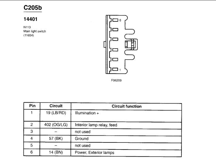

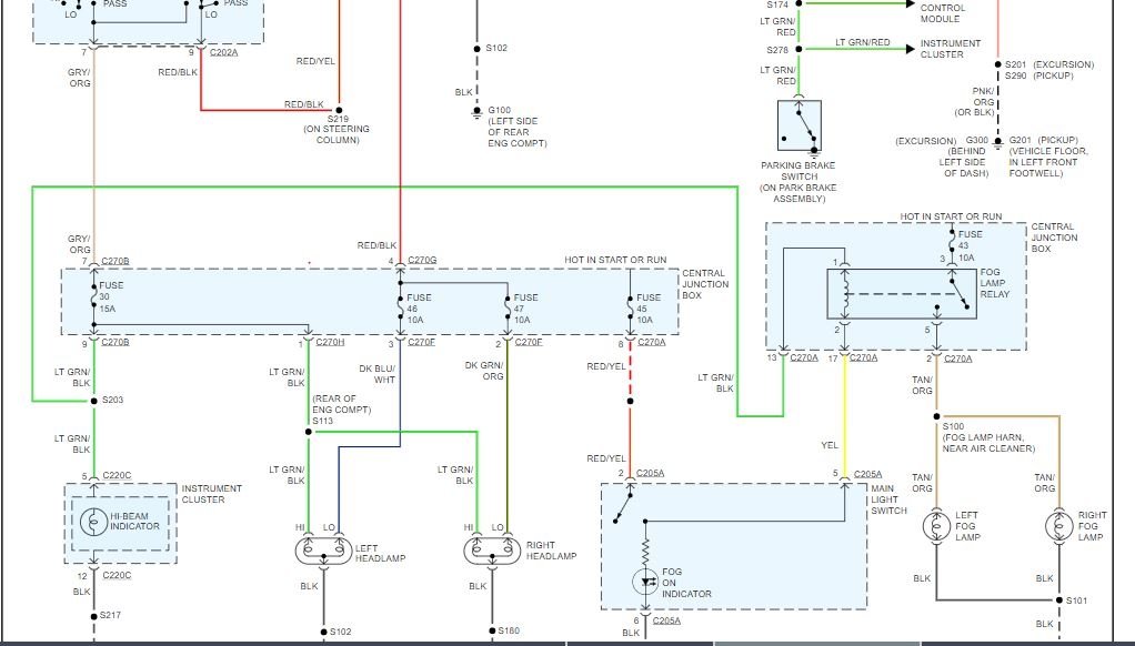

Hello again.
I attached a wire diagram for you to view.I attached the connector diagram for you.
You need to verify power from the switch to the headlights.
check the red/yellow wire for power out of the switch. That is for the low beams.

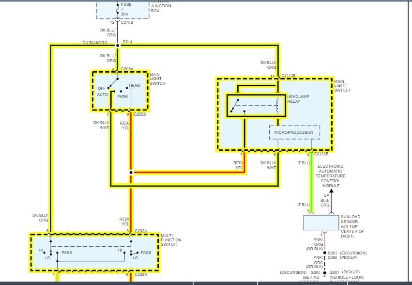

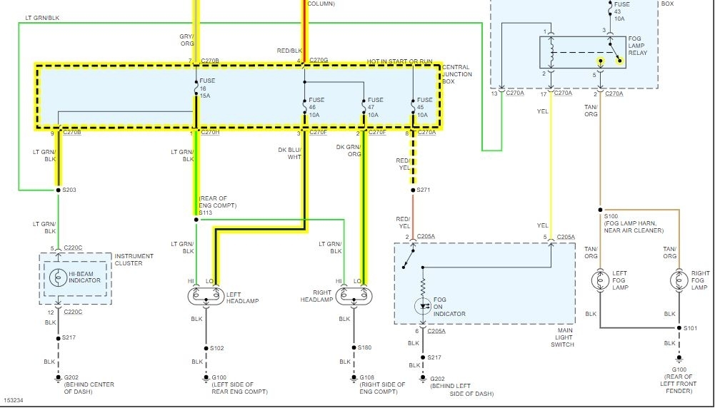

Well as my luck would have it, my multi meter quit working before I got to check the wiring at the switch. I was able to check at the headlight, there was definitely power per the multi meter with the running lights on, but when I would switch to turn on the headlights there was no power at the light.
Jun 13, 2020 at 9:29 AM

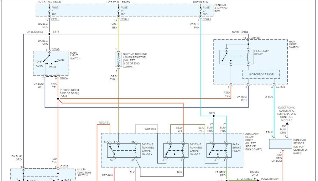

Okay, so you have DRL system.
I attached the wiring diagram for the DRL.
