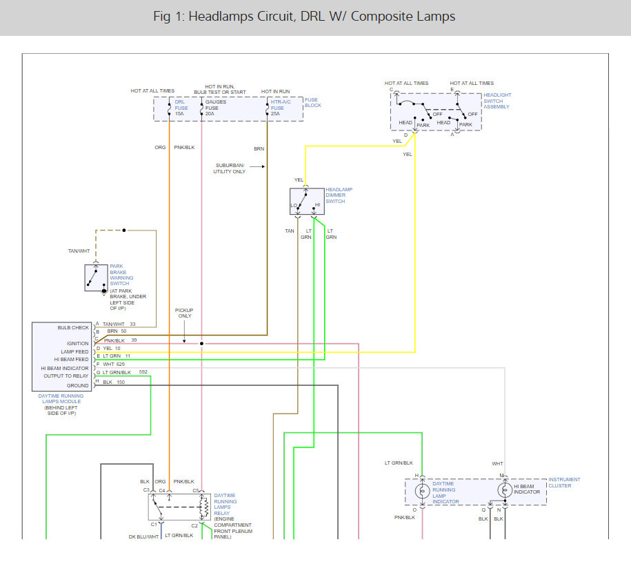

Lost headlights put new ones in only getting 5 volts to back of new ones installed can't find relay.
Apr 27, 2020 at 10:34 AM
  • 55,711 POSTS

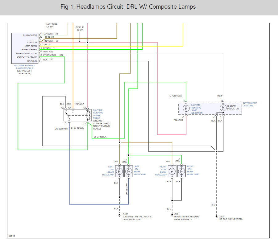

There is no headlight relay for this truck I would test through the dimmer and headlight switch. Here is a guide to help you and the headlight wiring diagrams so you can see how the system works:
Apr 29, 2020 at 3:02 AM
SKINNER ETHERIDGE
Thank you so much. it was dimmer switch. thanks again, Charles Skinner Etheridge
