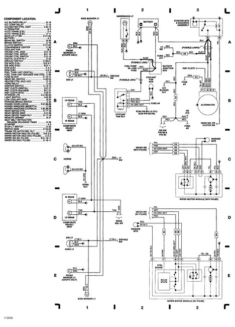

No power at brown and yellow wires with switch on. Is it simply a bad switch or can I try something else?

Normally I would say to check your fuses, but I have reviewed your fuse box information on Prodemand and there simply is not a fuse for the headlights listed. I would say to go ahead and pull the switch out and make sure that you're getting power to the switch. If there is power going to the switch, then it is time to replace the switch. Simple as that. If there is no power getting there, then I would say to check every fuse (since there is not one labeled). Let us know what you find.

Have power at fuse seven, have power to switch, none going out. Having trouble finding replacement going to have to junk yard crawl I think.

You might also want to call the dealership and see what other vehicles use the same switch. I would say probably the Beretta does. Maybe the Cavalier and Lumina as well. This could make it much easier to find your part.

I dug up this wiring diagram. Thought it might help you out.
