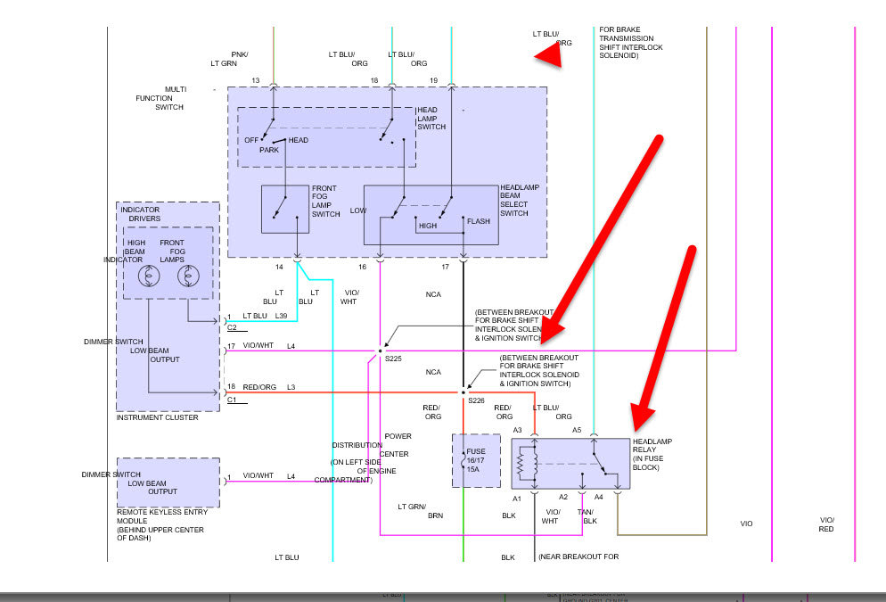

No head lights running lights brights or cluster lights.
2002 CHRYSLER PT CRUISER
153,000 MILES • 2.4L • 4 CYL • FWD • AUTOMATIC
STEVEN PERINE
I dont have a clue where to go now. Ive replaced as many fuses about the problem as i could relays and all and still no headlights etc... I havent replaced the switch itself yet but it did get stuck when i tried turning the headlights on one night. And from there its been a miss.

check headlight relay under hood first where pointed in arrows.see if power is coming to relay on wire pointed out then if it is jump to other wire pointed out see if headlights work. if not check multi function switch also check connector of multi function switch dealers sell a repair kit for it. vibration can make switch go bad.
