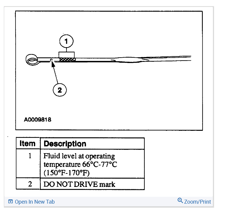

I recently just had my A/C compressor, and alternator replaced baseline and suddenly now my van won't go in any of the gears and when I change gears you can hear like there's an air leak somewhere. so how can I fix this so that my van will go in gears?

This sounds like they forgot to refill the transmission after the work was done, they probably had to undo the radiator cooler lines and lost some fluid here is a guide to help you check the fluid level in the transmission and the exact procedure in the diagrams below for your car.

Check Fluid Level and Condition
Caution: The vehicle should not be driven if the fluid level indicator shows the fluid below the DO NOT DRIVE mark or internal failure could result.
If the vehicle has been operated for an extended period of time at highway speeds, in city traffic, in hot weather or while pulling a trailer, the fluid needs to cool down to obtain an accurate reading.
The fluid level reading on the fluid level indicator will differ depending on operating and ambient temperatures. The correct reading should be within the normal operating temperature range.
Fluid Level Check
Under normal circumstances the fluid level should be checked during normal maintenance. If the transaxle starts to slip, shifts slowly, or shows signs of fluid leaking, the fluid level should be checked.
1. With the transaxle in (P) PARK, the engine at idle, foot pressed on the brake, move the selector lever through each gear and allow engagement of each gear. Place the selector lever in the PARK position.
2. Wipe the fluid level indicator cap and remove the fluid level indicator.
3. Wipe the fluid level indicator with a clean cloth.
4. Install the fluid level indicator back in the fluid filler tube until it is fully seated, then remove the indicator. The fluid level should be within the normal operating range.
